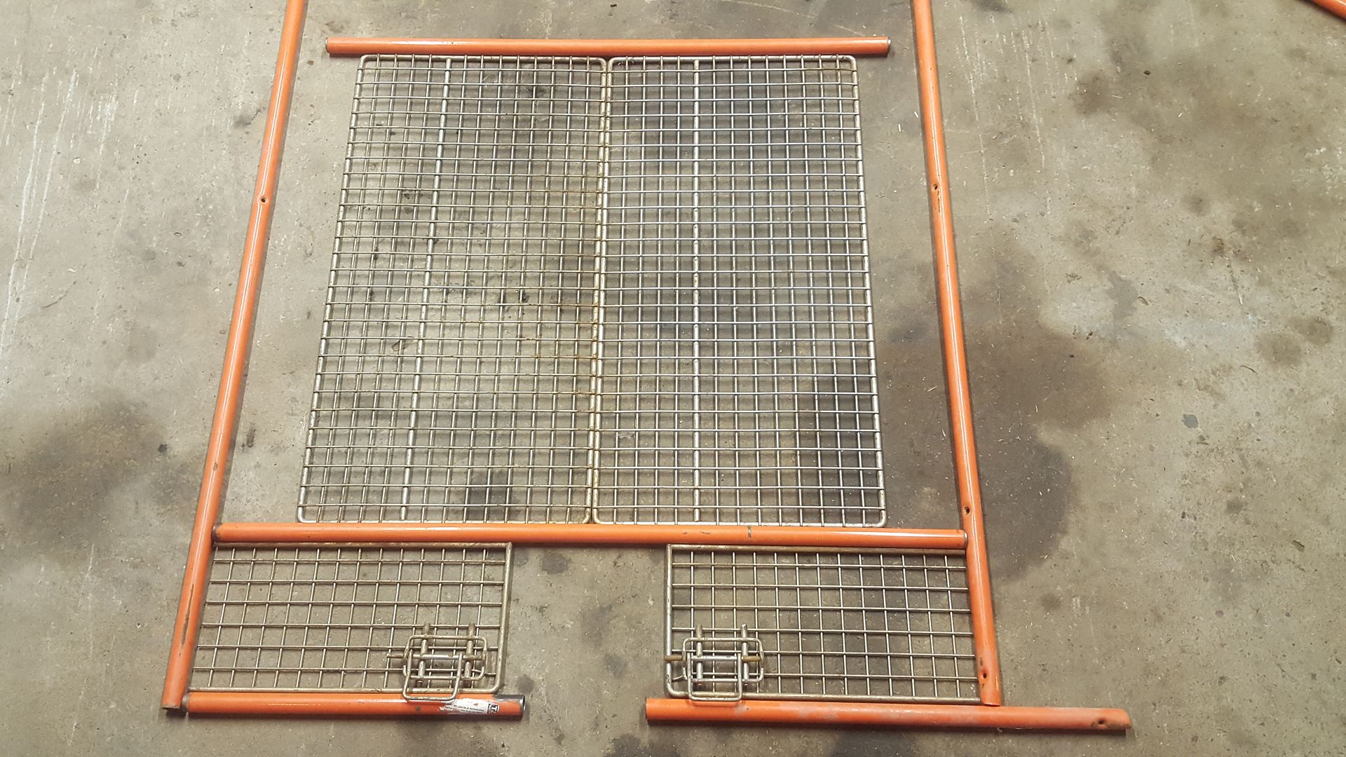

The saga continues... a brush cage is in the works, across the back, most of the right side, and likely some on the left side as well.
I've been puzzling out how to fit the pieces of wire mesh panels together best, I finally started cutting a few today.

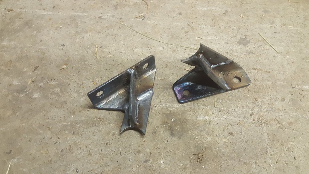

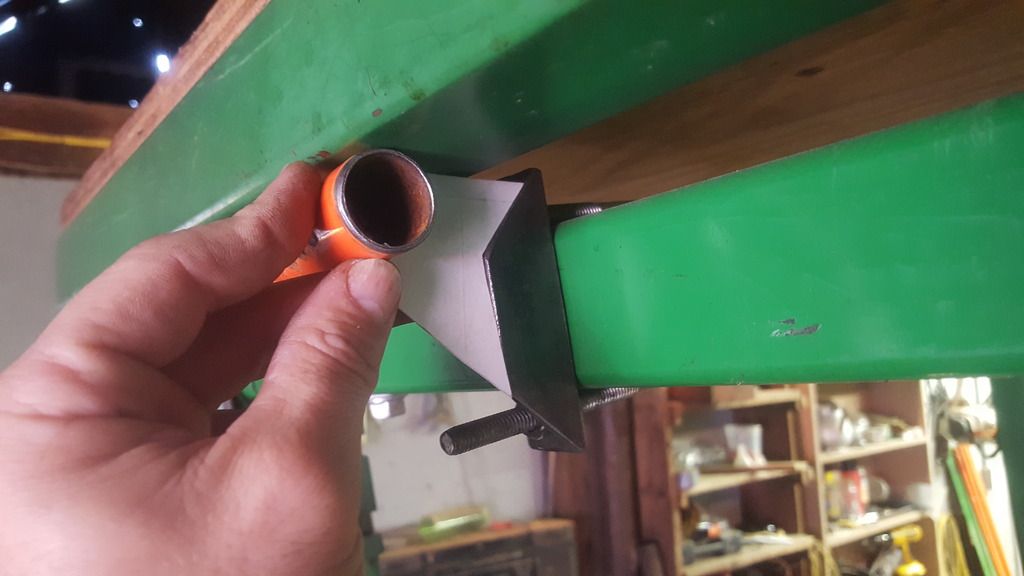

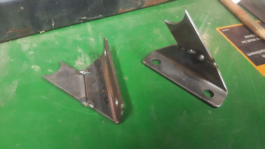

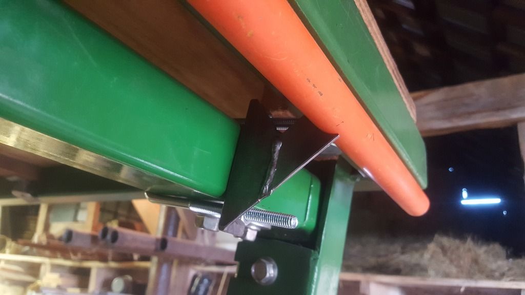

I've been working on the top mounting brackets.
Cut 4 pieces of 1x1x1/8" angle and drilled holes to fit some square u-bolts around the top ROPS tube. A paper template to get the angles right was easy enough.
Hole saw thru a piece of 1x1/8" flat made a nice end against the pipe, template gave me the size and angle.
Added a flat piece to act as a gusset, and welded them up...
I'm happy with how they turned out, will likely swap them side to side from how this picture is... easier to access the nuts on the u-bolts, which are too long.
Not much... but it's progress! More than I can say for my truck motor swap project.

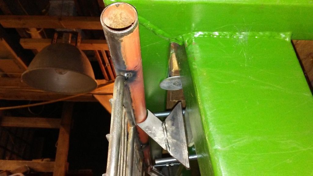

No pictures, but i spent a short time this evening running the grinder/wire wheel over the 2 larger screens for the back section and welded them together. Im starting to get the order-of-events of assembly together in my head. Im also trying to work out how to incorporate the use of some existing holes in the orange tubing to allow side panels to attach to the back section.

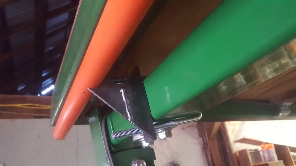

I got the 2 screens tacked to the top tube tonight. Remembered to take pictures too!
