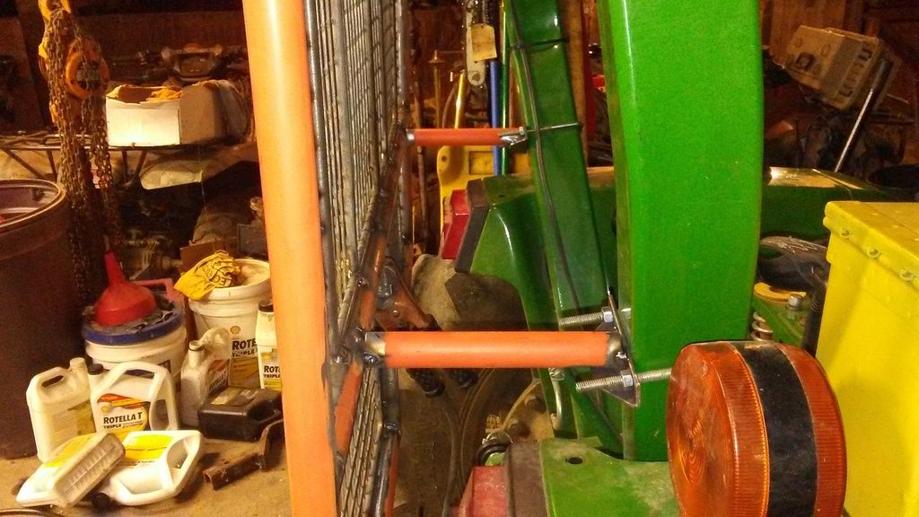

I got the bottom mounting points fitted and tacked

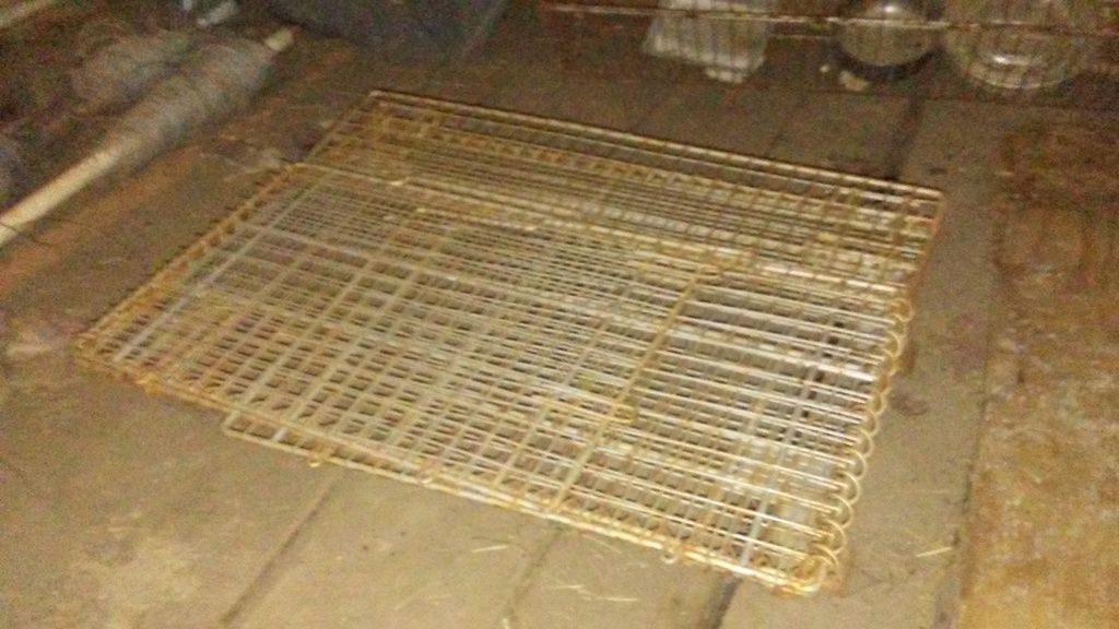

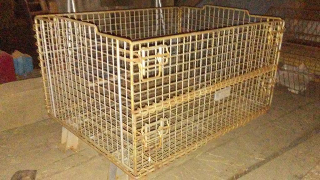

These are the source of the screen/mesh panels
Takes about 30 seconds to collapse or set up

Got some gussets welded in at the lower mounting points. Oversized to allow lights to be mounted to them.
Welding is done, cleaned up and ready for paint tomorrow.

Those baskets were a good find Greg. Perfect material for your project!!! Lookin good as always!!!
