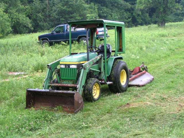

Looks good Greg. Mine does not look nearly as good as yours, its been weather and branch beaten to death, but here it is. I have some custom mounting arms that bolts in a similar manner to your mounting system at the ROPS.
I didn't realize your tires were loaded too. You must have some steep slopes!
