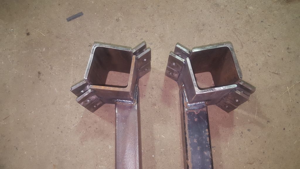

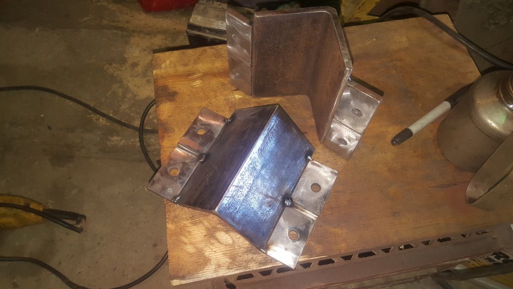

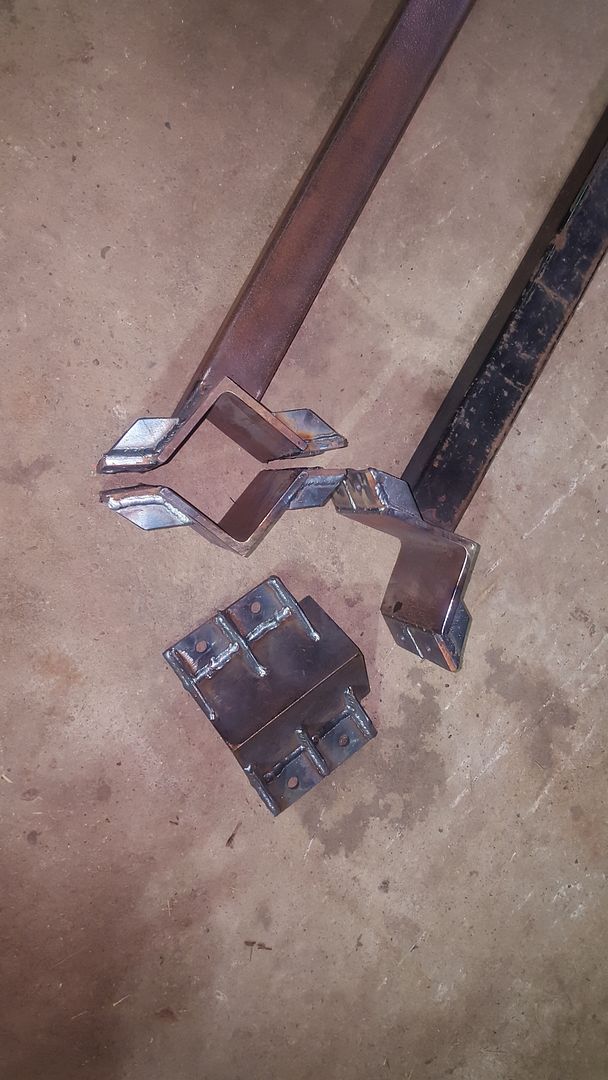

One evening I drilled the pilot holes, pictured in my last post. Another, I drilled them out up to 3/8"+ clearance, another I ran a flap disk over the holes to knock the burrs from drilling off... tonight I ground a bevel on the mating edges, where these little pieces will be joined end to end. I still need to cut out some gusset material, we have a metal shear at work I might be able to use for that, as my plan calls for 24 of them.

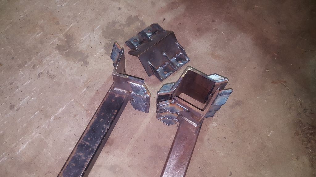

Got a bit more done today. Tacked the flange pieces onto the lower front mount 'clamshells', and got the front risers welded to them as well.
Want to get these pieces finish welded with the gussets I still need to add, sanded and painted, before I weld it to the top hoop. Once I do, it becomes one big heavy piece that I cannot handle alone, and will need the hoist to lift on and off. So much easier to move around small pieces when using the side grinder on them, and painting with primer. Naturally I will leave the edges where future welding will happen bare.

Was hoping to spend some time on this project over the weekend, but no luck. Last week, I was able to cut up some small diamond shaped pieces of metal to use as gussets, have about half of what I need, maybe I can get the rest cut over the next few days, and work on this over the holiday weekend. 4 days off will be nice, but there's some fence that needs dealt with, and deer season comes in today, so I'd like to put some meat in the freezer too.... always something.

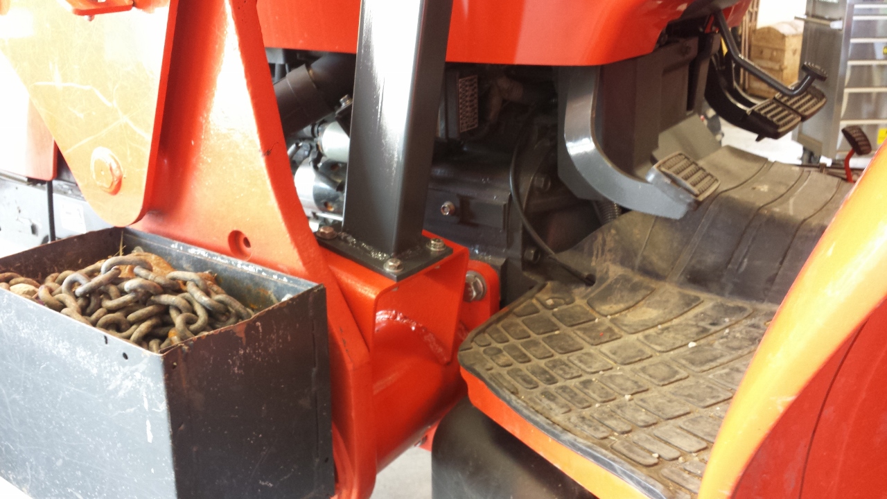

Okay,,,,, don't everybody jump on me..... Greg invited me.

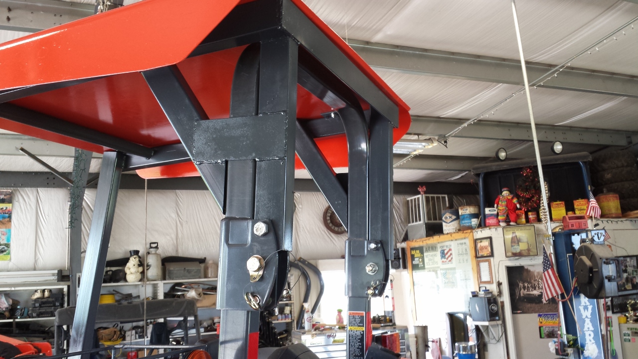

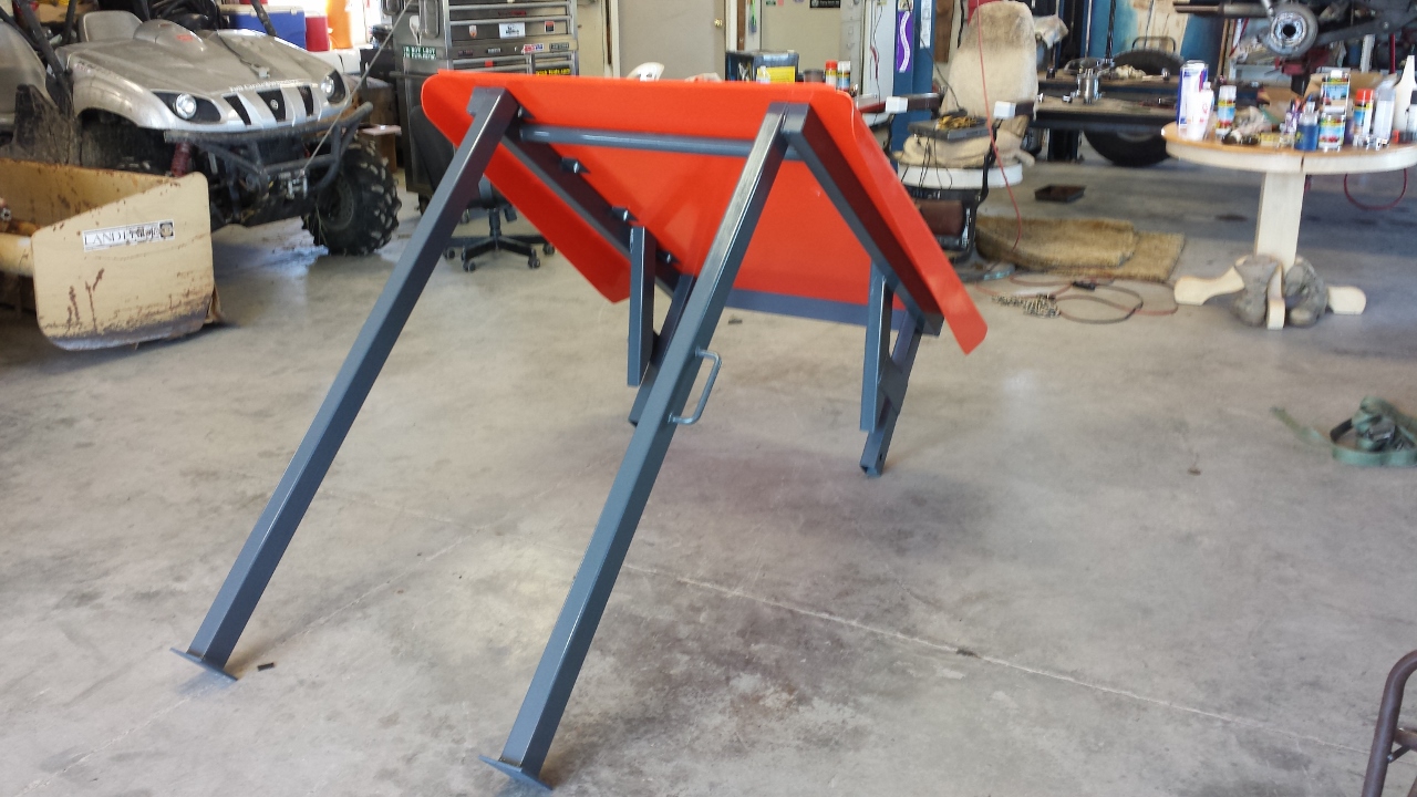

I'm all about his bolt on idea. I struggled with this a lot. I'm not talented enough to go about it like he did. Great work on his part. Don't pay any attention to my orange paint, it's just a fad. :)
I too worried about worst cast scenario. I operate my tractor in steep timber a lot. I had no faith in my factory ROPS saving me. I had a canopy from an old John Deere backhoe so decided I could build the frame.
I first built a "canopy" style overhead. Immediately realized if I tipped the tractor over the canopy would be what killed me. So added front posts. Now I have no worries whatsoever.
Regrets. I should have designed the front posts/top canopy so tree limbs that contact the front posts would have slid over without getting hung up. I built in an overhang on the top which now catches tree limbs..... Oh well.... :)
I bolted the rear of my canopy to the factory ROPS. So if I remove it, no damage done.
20140702_165930 (1280x720) (1280x720).jpg 20140707_153025 (1280x720).jpg 20140707_161553 (1280x720).jpg

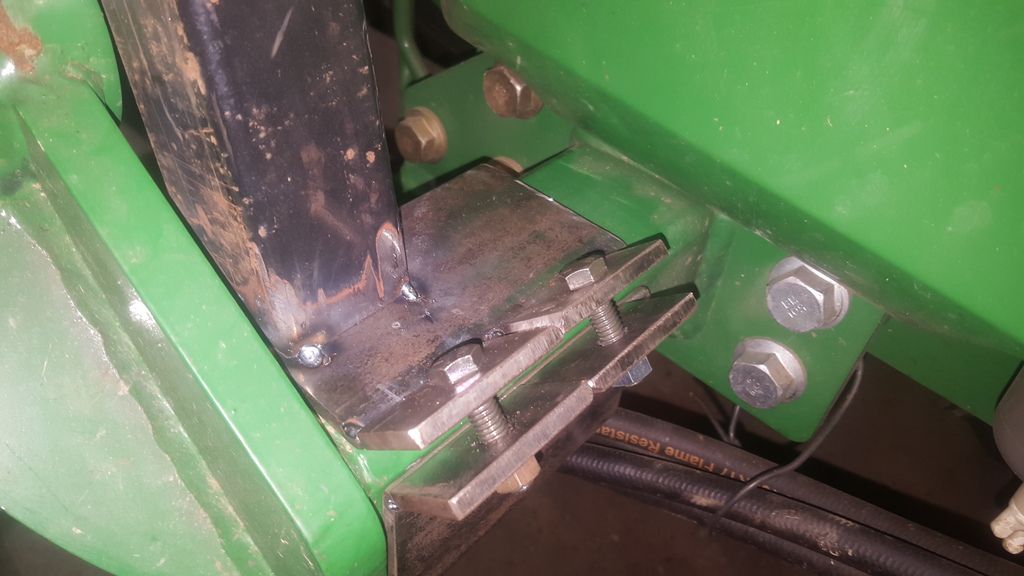

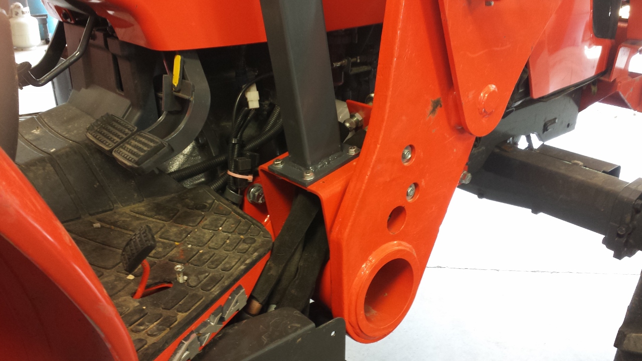

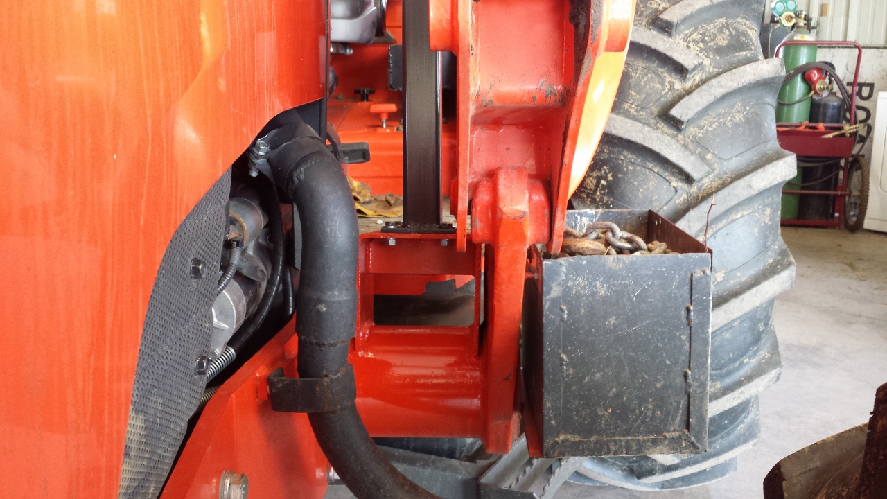

I bent a U shaped piece of flat iron and welded it to my FEL frame. Then welded a plate to the bottom of my front posts and bolted the two together.
20140707_161515 (1280x720) (1280x720).jpg 20140707_161533 (1280x720).jpg 20140707_161542 (1280x720).jpg

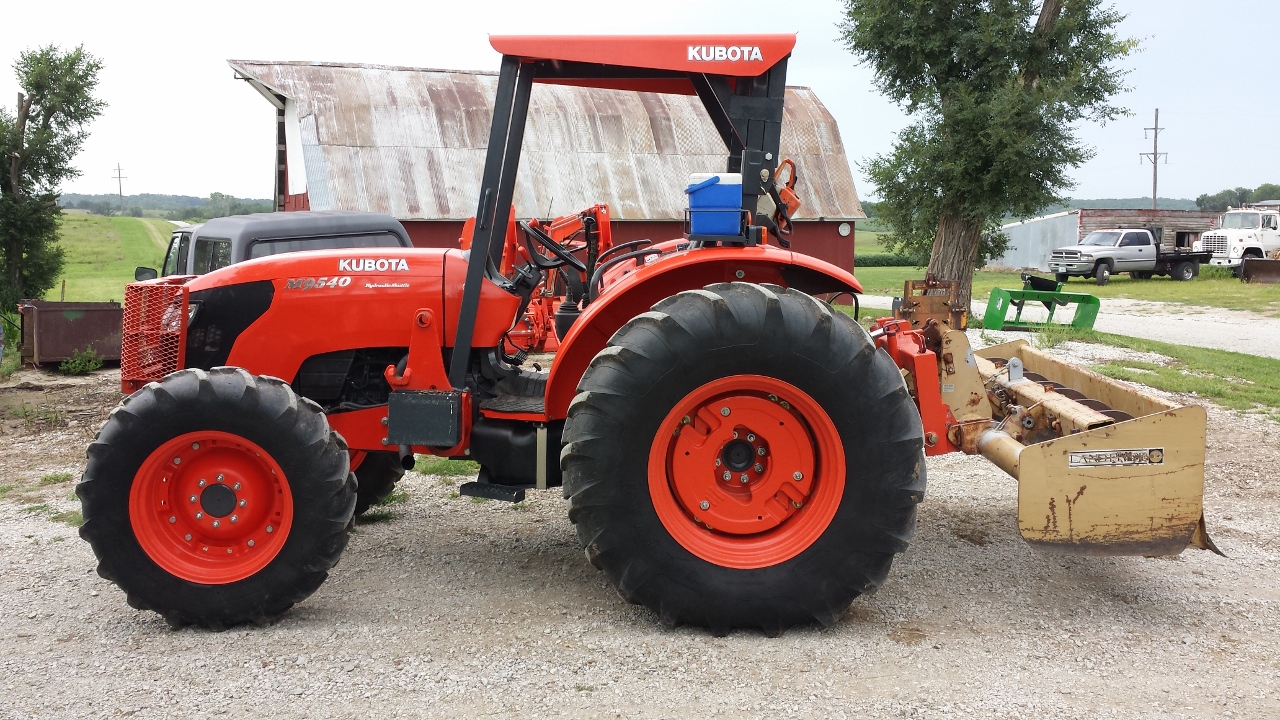

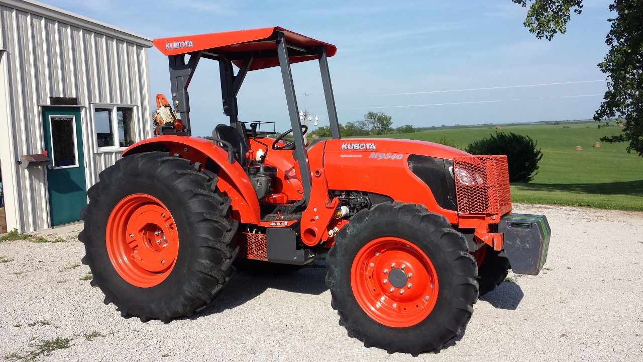

Finished product. Even bought Kubota stickers. A couple neighbors have commented on the fact that my tractor has a factory canopy. I just smile and say I built it. They always seem surprised. WHAT,,, don't they think that's possible??? :)
20140729_113850.jpg 20140820_171540 (1280x720).jpg 20140822_114905 (1280x720).jpg
