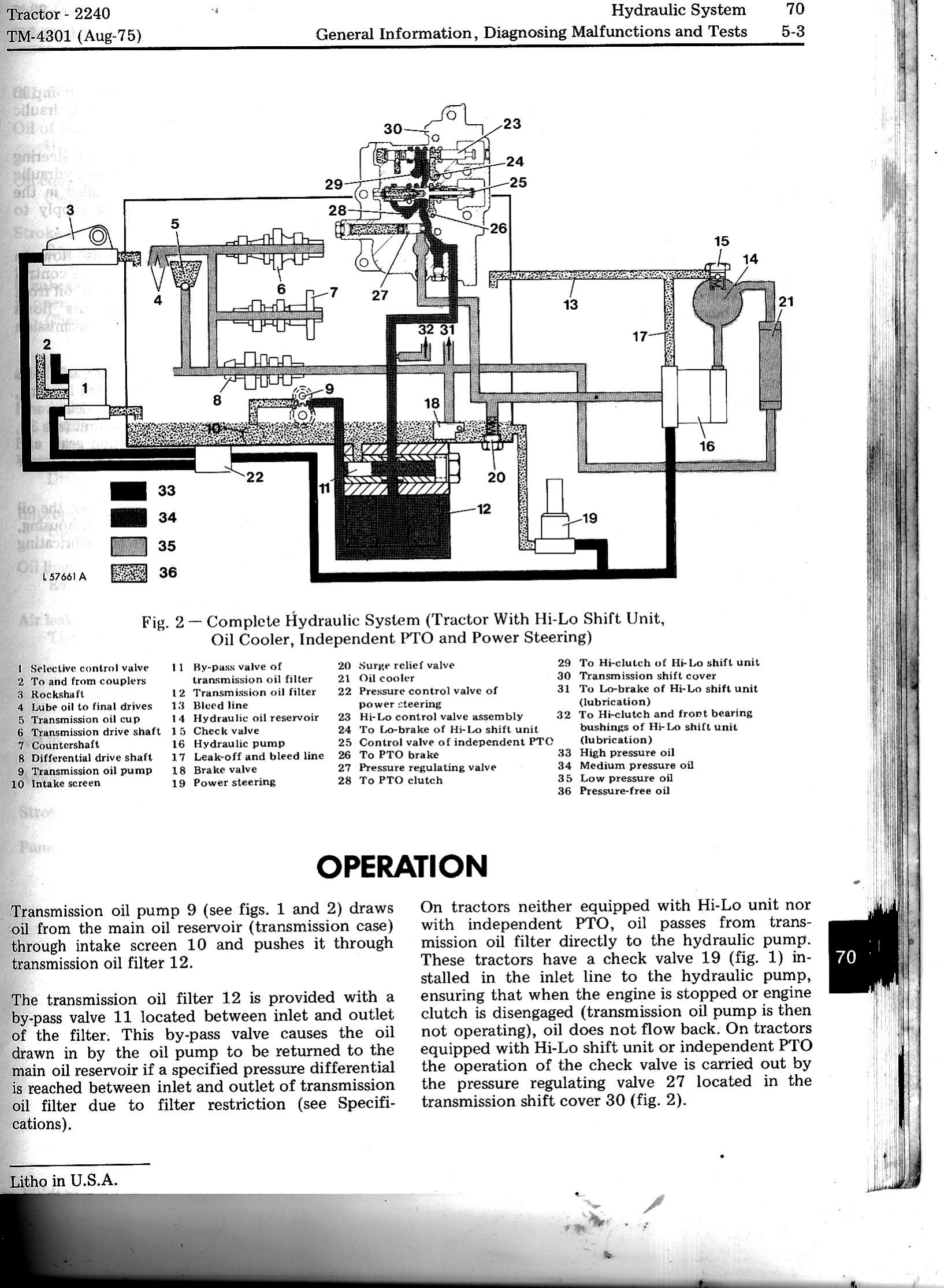

Here are a couple of scans from the tech manual for the hydraulic system basic operation. They should help you to understand the basic operation. I would highly suggest contacting John Deere and getting a tech manual. Then testing pressure from the internal pump. My suspission is that it is an internal problem. Another quick check, is to remove the cap for filling the hydraulic fluid and look for mist in the resivoir while tractor is running. There are lines in the resivoir which are known to crack and blow fluid inside the resivoir causing pressure loss.
