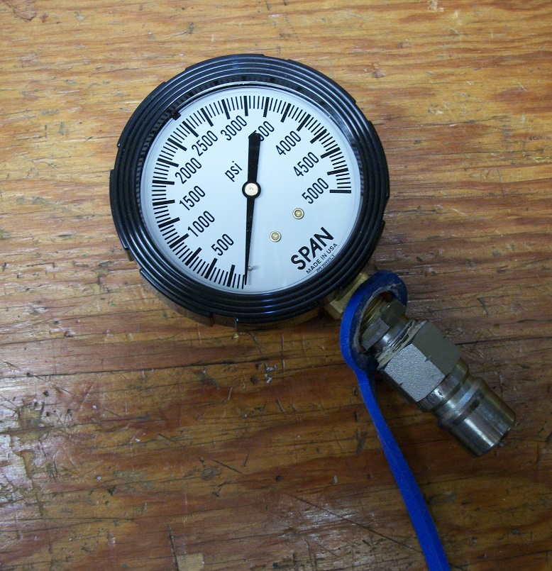

I want to test my hydraulic pump using a gauge.
Where do I plumb it in?
The manual is not helpful at all.
的nstall a hydraulic test unit or pressure gauge and start the engine to pressurize the system
   / JD 301A s/a 1020. How to test hydraulic pump #2
Mean Jean
I made a test gauge using a quick connector, short hyd. hose and the pressure gauge. Just couple it into one of the hyd. connectors. (if that is what you are asking).
The pressure gauge with male connector
Mean Jean
How do I “load” the hydraulics?

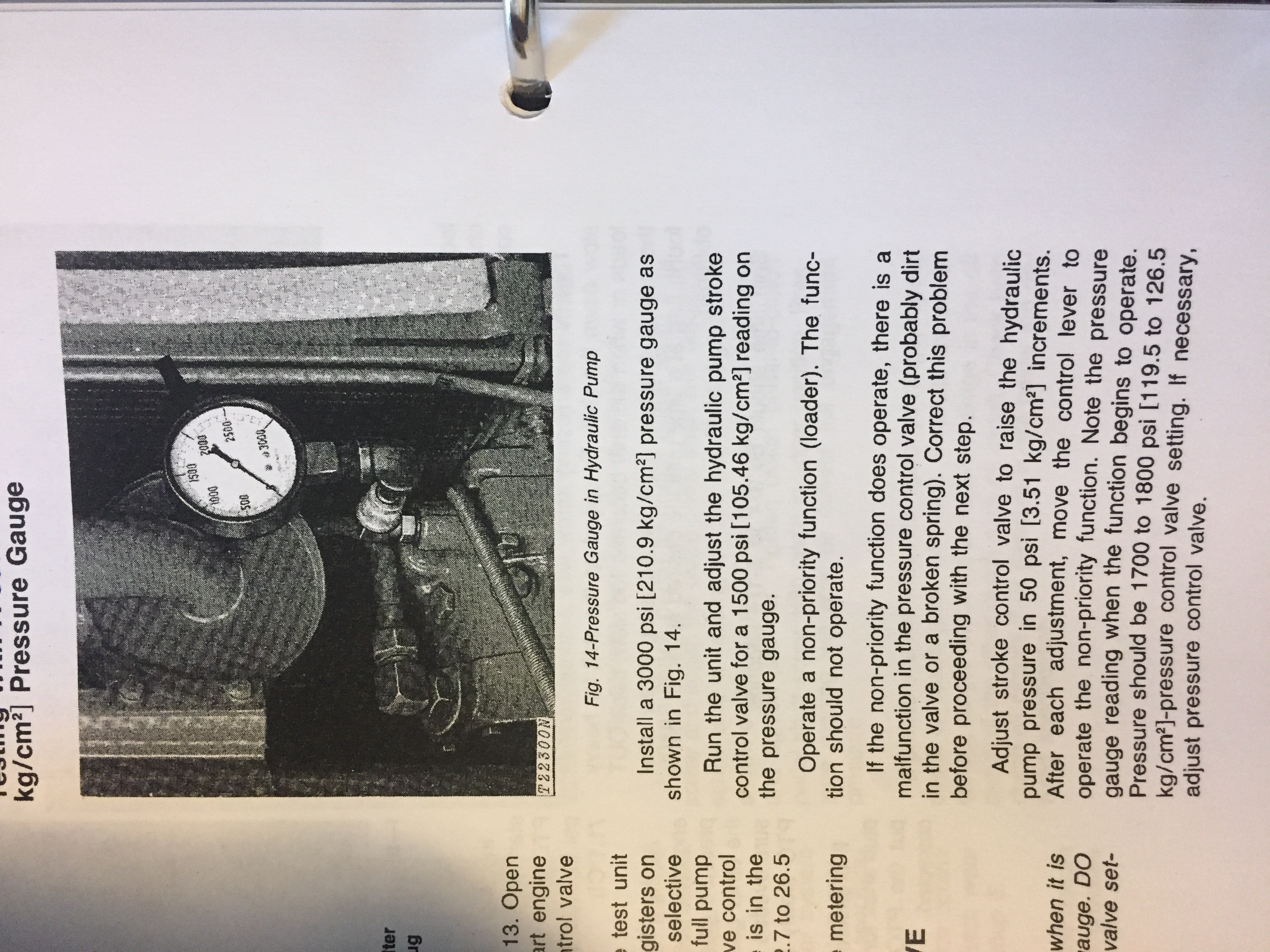

I found a pic of the hydraulic system. I am able to narrow down the high pressure line. I will need a T fitting.
I think I’m making headway.

   / JD 301A s/a 1020. How to test hydraulic pump #7
Besides installing gauge in hyd pump as shown in photo you could disconnect power steering supply line(key 4) & attach gauge to that fitting with a swivel connector. Female swivel thread size is 0.562 IN
Heck yeah!
I have the proper fittings at the power steering line.

This type hyd check will not be correct way to monitor stand-by pressure on a 1020/300 prior to serial # 45,200 because those models have open center power steering with a pump mounted on RH frt of engine.
Thanks very much for the tip. Will check the serial # tonight.
