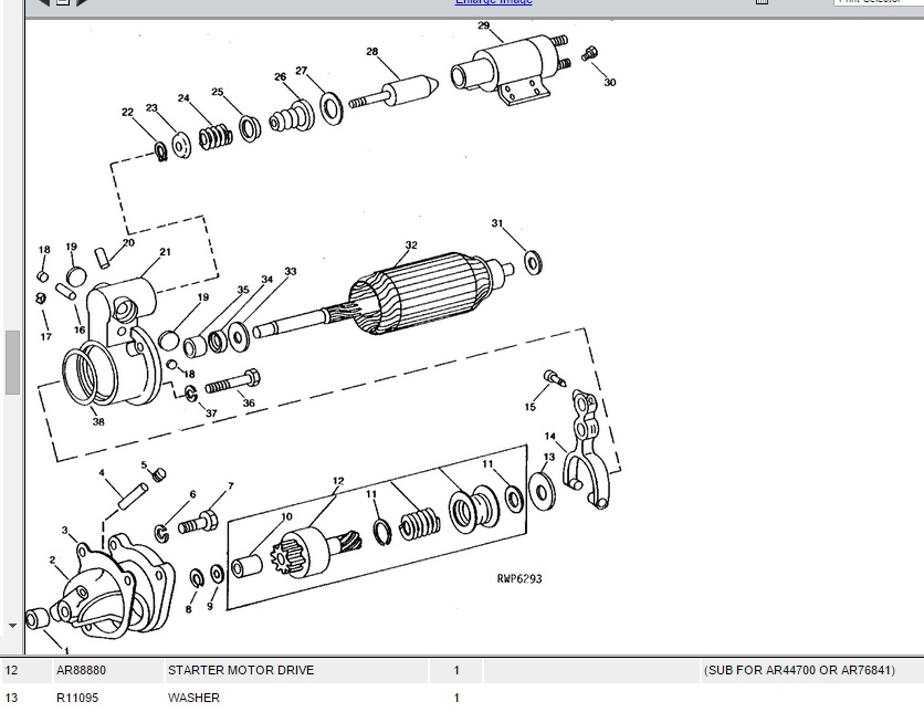

I'd think first off, it would be lack of oil on the shaft that the starter gear slide forward on to engage.
That or a broken part inside.
Not too difficult to remove and check out the mechanical linkage hooked to the solenoid.
But lack of oil would be my first guess.
Here is what it likely looks like (unless an older s/n is different).

Shaft in photo is armature shaft not starter gear(Bendix) shaft.
   / JD 3020 Diesel Starter spins but doesn't engage.
Jim,
Thanks. That was helpful as I would have gotten the wrong part. Found an armature for $85.
I'm in a jam for time as I need the tractor Saturday. Hence the hurry to figure out the problem. Needed a day or two of flexibility to get parts here.

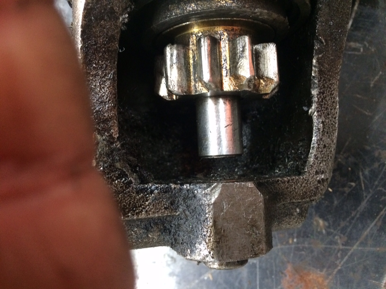

So the bendix shaft (armature shaft? TxJim)broke off the starter and is in the case of the JD 5103. So far I have tried the extendable magnet stick with no luck. I do not think I even touched it. Any ideas on how to get it out?
   / JD 3020 Diesel Starter spins but doesn't engage. #11
   / JD 3020 Diesel Starter spins but doesn't engage. #12
Without the aid of a bore scope one will have to be very lucky to get broken armature shaft out of clutch housing. If that fails a separation(split) of tractor will be in order.

Oh man! Well I am glad DLTTrekkers said it. Man I hope I get lucky. The starter is coming in tomorrow.

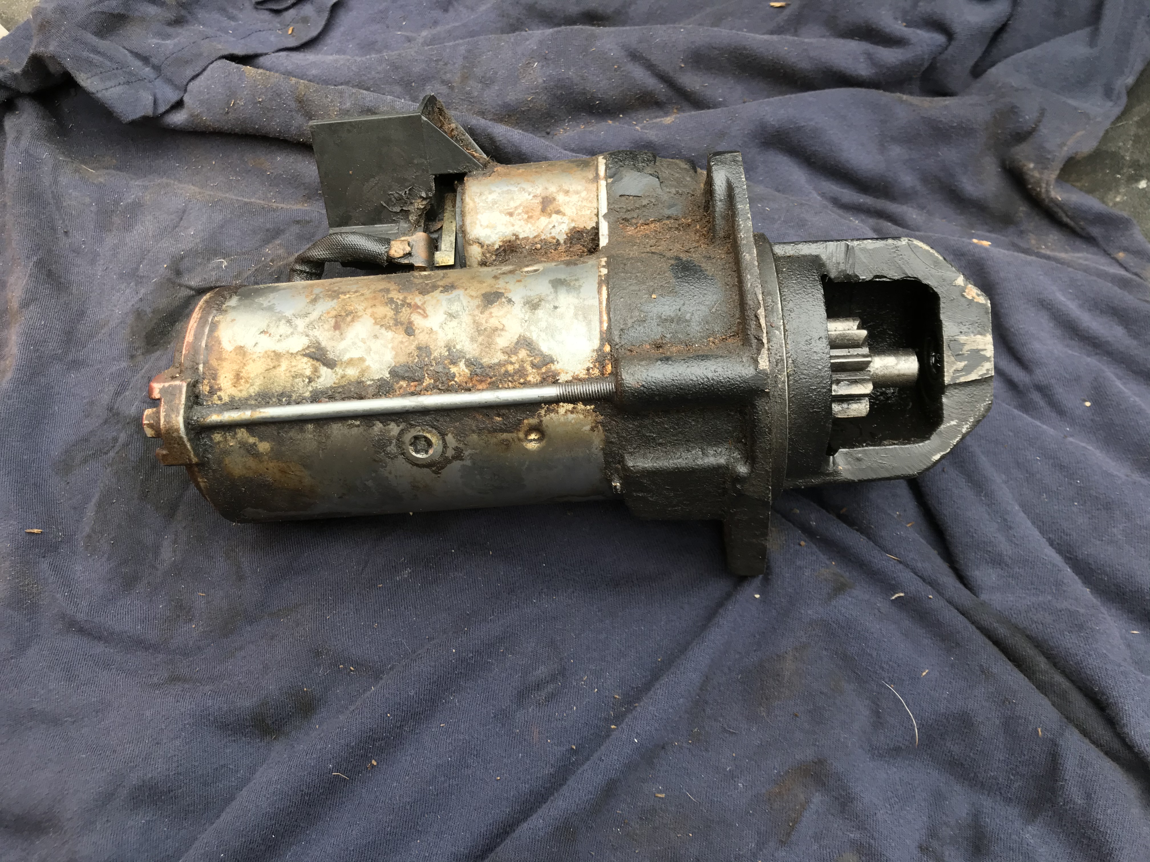

854594E5-C572-49FA-9A1A-E8B9E0947ACB.jpeg981DD5C5-4C62-4A06-A0D9-3AC74C40E11B.jpegFE147DFE-E523-4EF7-8129-8DDE458D928C.jpeg
So I replaced the starter with what I understand would have been the correct starter. The smaller installed starter could not handle the load or lack of power. I got the much bigger starter installed with a lot of manipulation. I noticed that the plunger to the water seperator is now leaking for next project.
