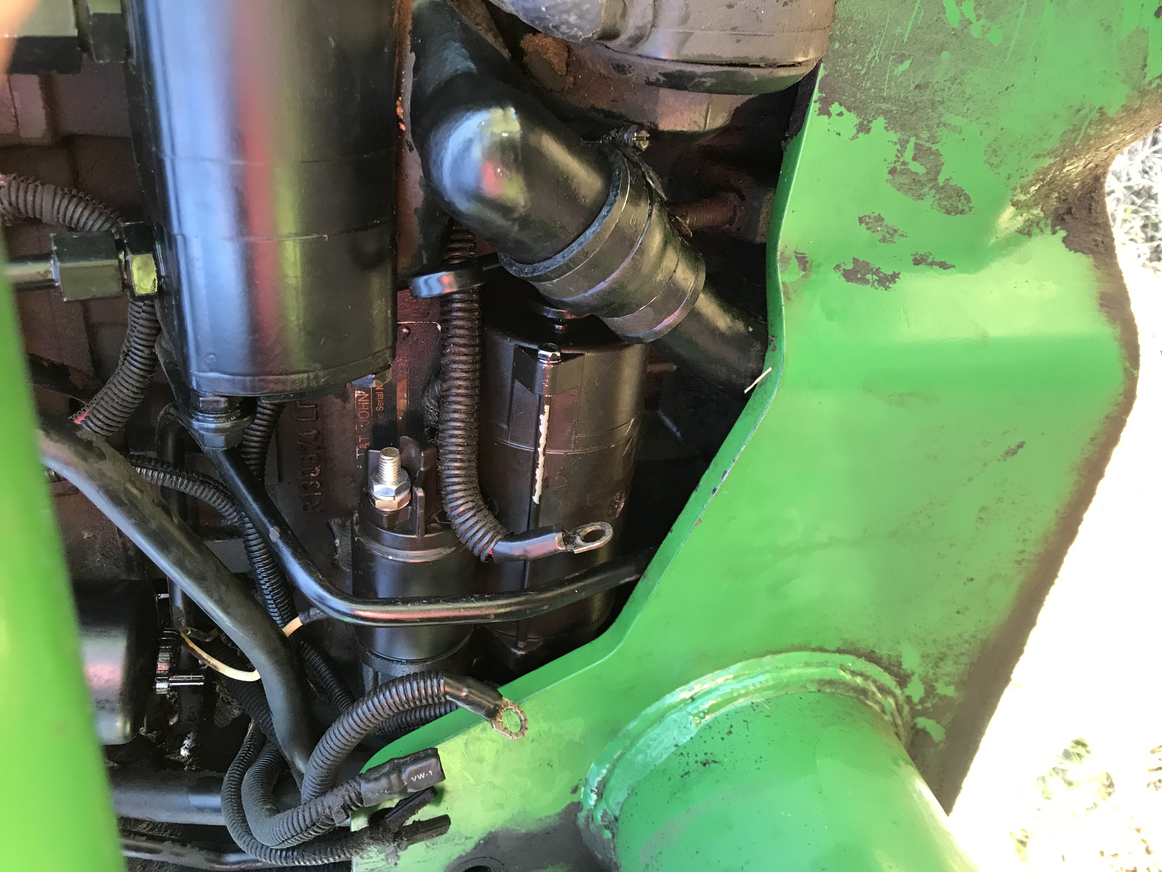

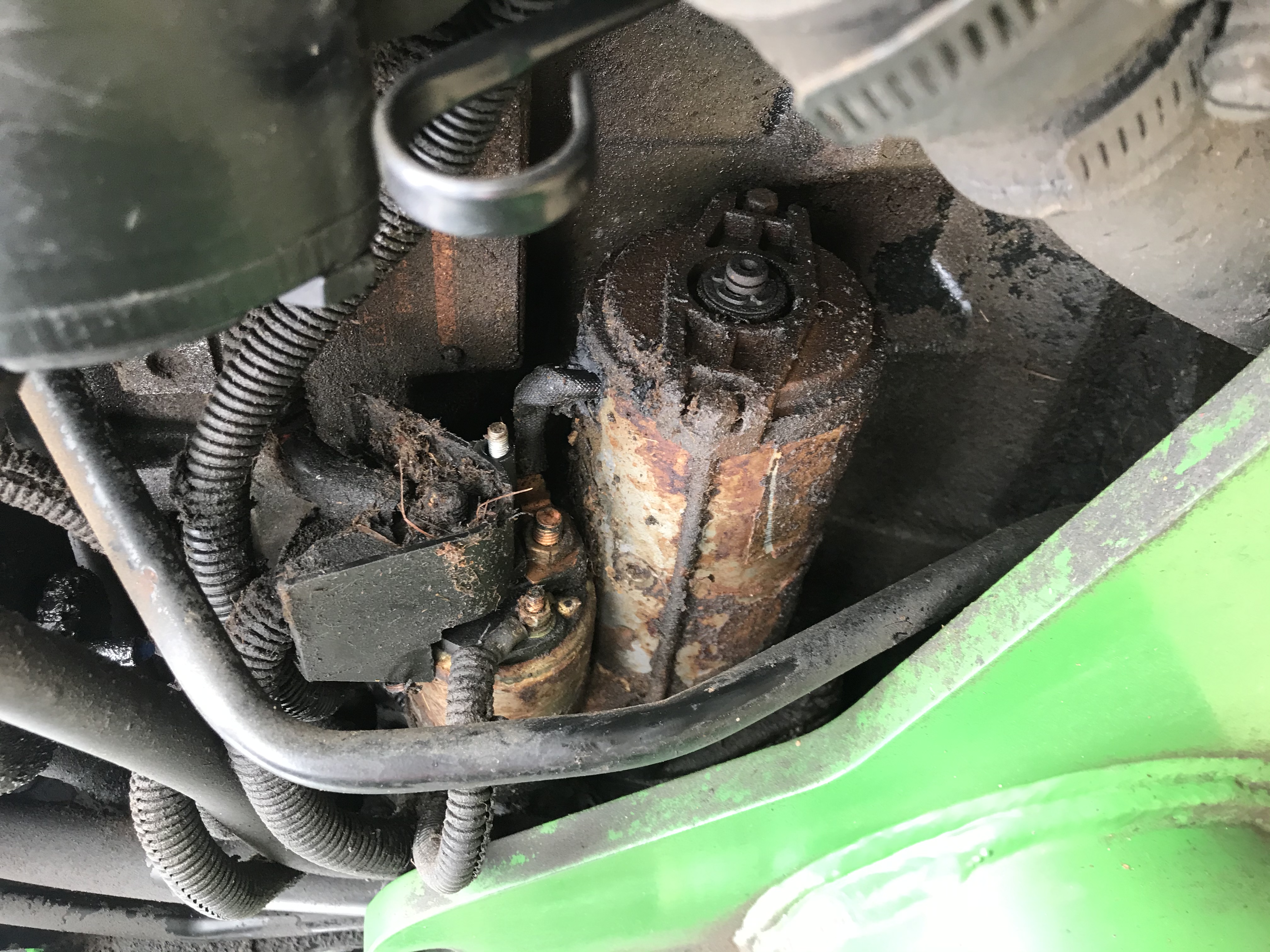

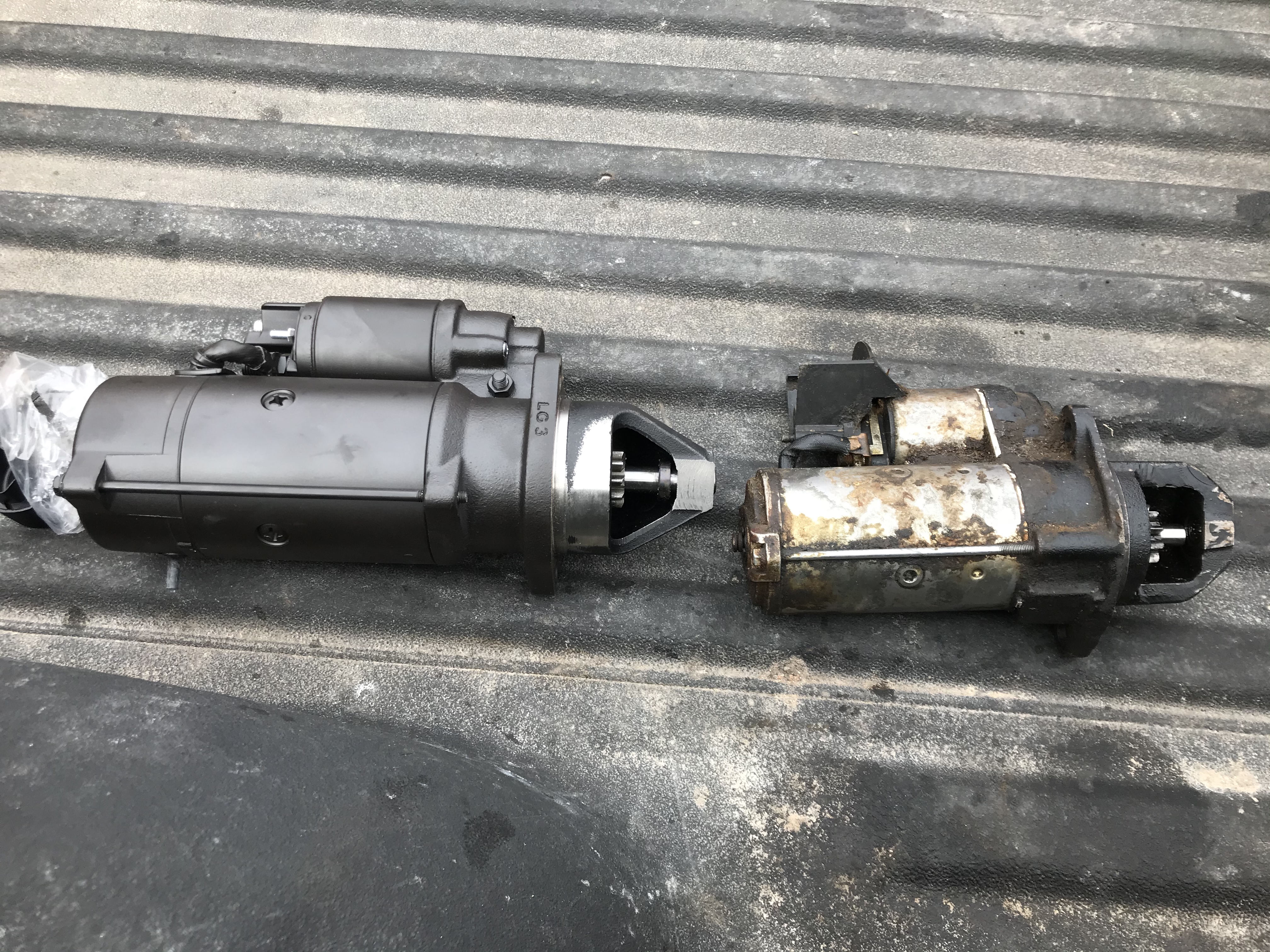

854594E5-C572-49FA-9A1A-E8B9E0947ACB.jpeg981DD5C5-4C62-4A06-A0D9-3AC74C40E11B.jpegFE147DFE-E523-4EF7-8129-8DDE458D928C.jpeg
So I replaced the starter with what I understand would have been the correct starter. The smaller installed starter could not handle the load or lack of power. I got the much bigger starter installed with a lot of manipulation. I noticed that the plunger to the water seperator is now leaking for next project.
