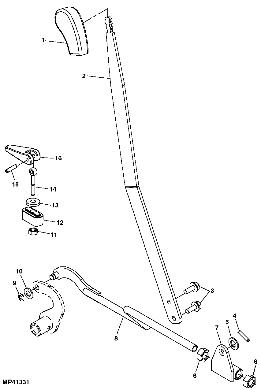

I noticed that my rockshaft control lever has gotten harder to move forward/back. JD dealer mentioned I should look at the Rate of Drop valve to see if it needs adjusting (his fear was that there was too much pressure build up in the hydraulics). First question is: could it be hydraulic problems if that rockshaft control lever is harder to move, or could the lever be damaged? The 3-point hitch works fine - mower moves up and down as expected.

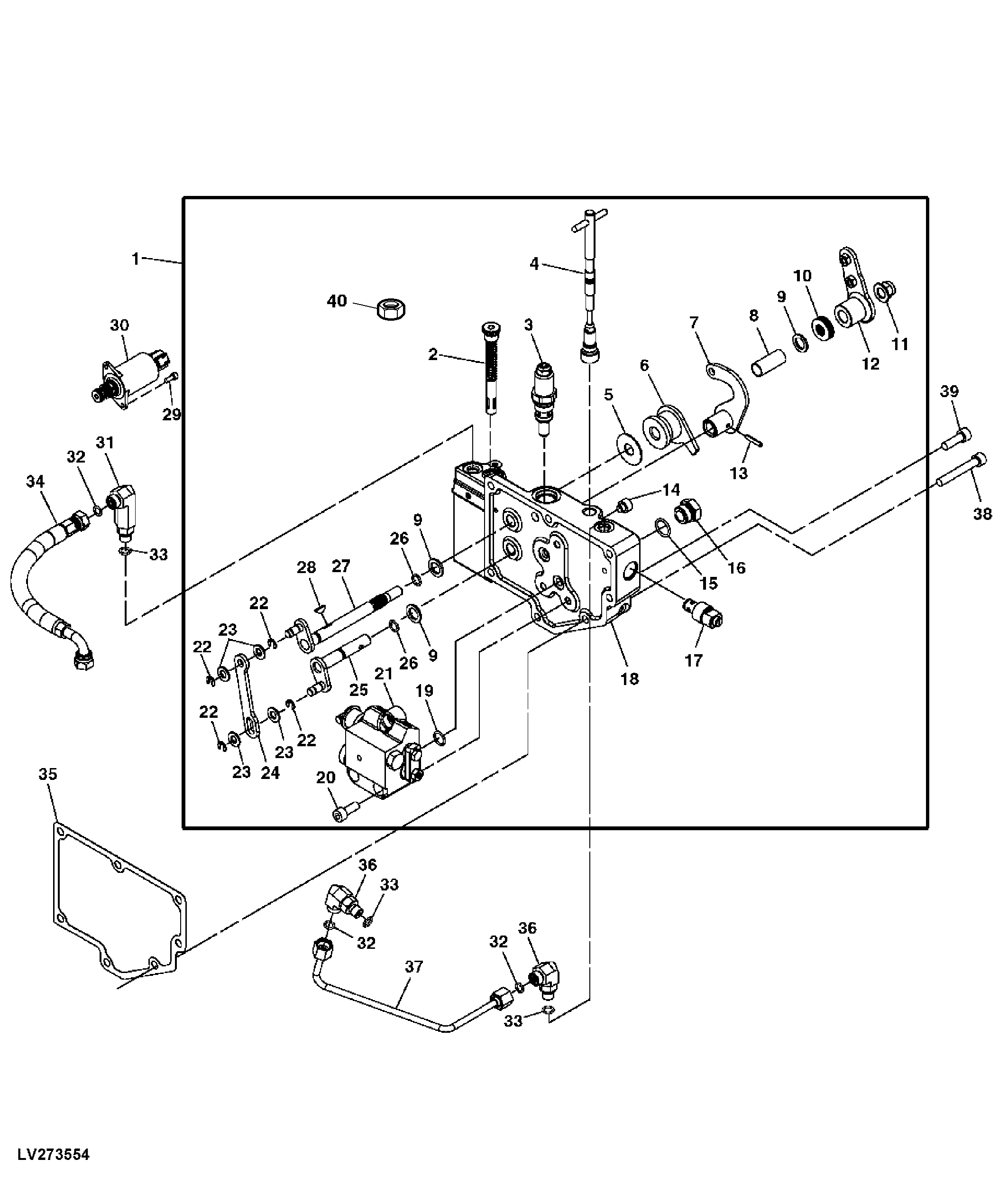

Secondly, I found the valve under the seat, but found that it can't be turned - it's frozen, as if rusted. I'm considering using a large pair of pliers to carefully break it loose, but was looking for other suggestions (I don't want to break the stem :) ). Also, if I succeed in getting it moved, is this valve supposed to turn a full 360 degrees, or is it limited in how far it can turn?

I've had a couple of these valves seize up -- they always seem to have a way to catch water or something -- and soaking around the knob shaft with an oil penetrant for a couple days has got them loose with no other effort on my part. So if you have time, try to soak around the shaft for a few days or a week.
When the valve on my L3200 was frozen, I realized I probably had set it to wide open when the tractor was brand new and hadn't touched it in 4+ years.... Now, I try to remember to exercise the knob and hit the shaft with a shot of oil when doing periodic maintenance on my tractor.

Have you tried lubricating the linkages?

Thanks everyone for responding.
Tractor is 2+ years old and is stored outside, uncovered. I didn't think the valve seizing up would suddenly affect the rockshaft lever either, but was going with what my dealer mentioned (basically, it was a 'quick' check - but it was the sales guy...so...).
I did take a wrench to it and was able to loosen it and turn it, although I'm not sure how far it's supposed to turn (a full 360 degrees or partial). In either case, it did not help with the stiffness in moving the rockshaft lever. I may hit it with some lubricant to see if it helps.
