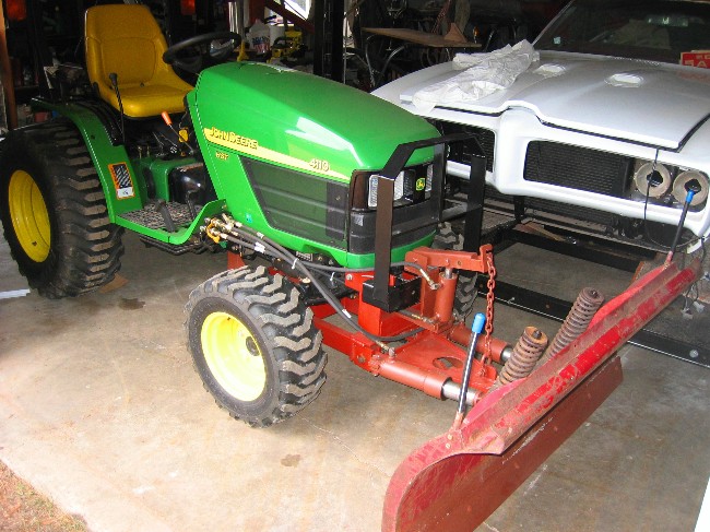

I bought a used 6' Western hydoturn plow for a hundred bucks and made a sub frame that bolts to the front and MMM mounts. What I like about this is when angled the blade is only inches from the front tires. The quick tach on the loader places the blade so far ahead there is not enough weight to keep it in the direction of travel. Also close equates to a tight turning around space.
I also rebuilt the turn rams for $16.00 ( seals ).

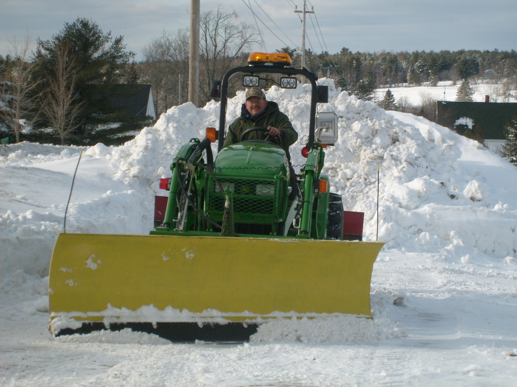

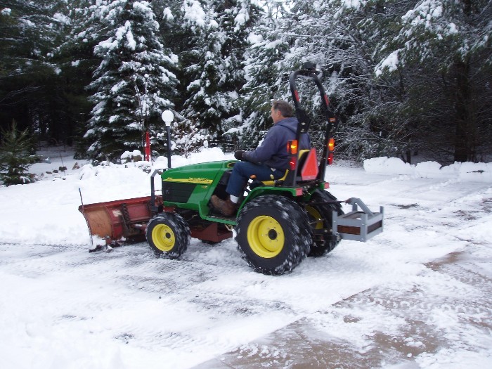

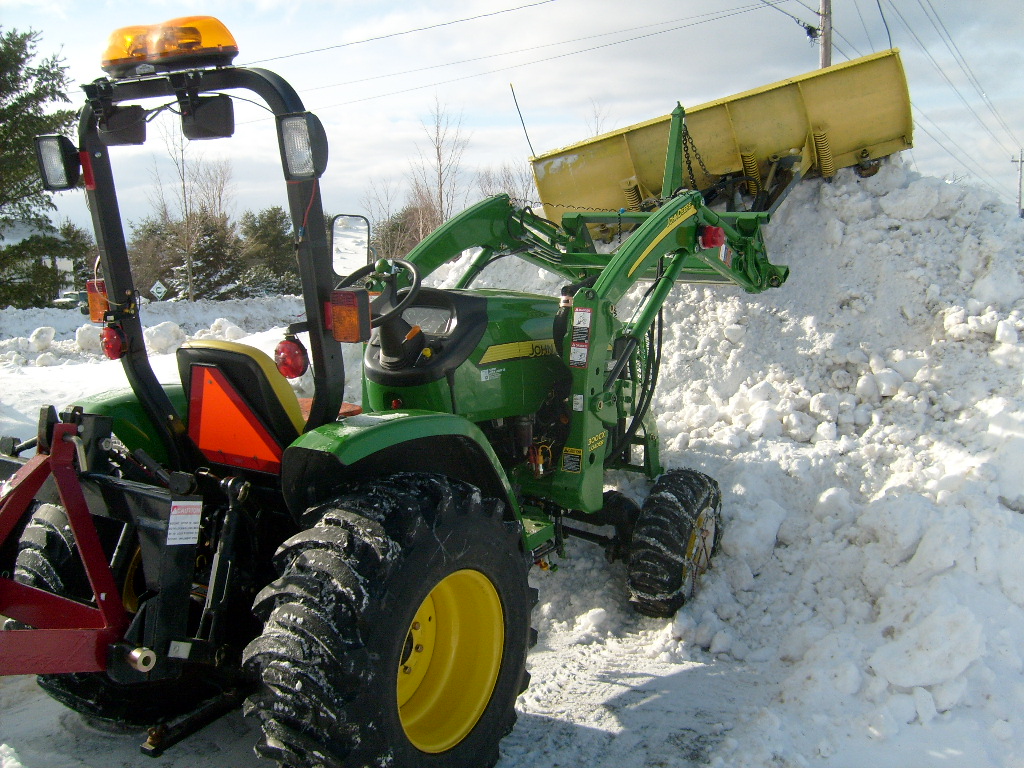

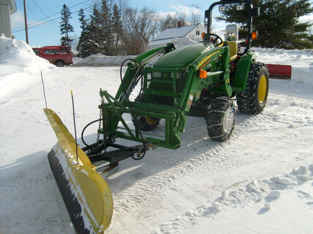

Muff ,
;) I wish I could have caught this post sooner and showed you the "real deal" in hanging a plow on a JD or Kabota tractor. There is alot of ways to do it but without a doubt the finest plow made is the Fisher plows , and most anyone that has tryed them all on a truck will attest to this. There is an adaptor available for hooking right into one on your tractor FEL and you make up two 10ft hoses with 1/4" pipe on one end and JD QDs on the other and plug em into the hydro distibution block and your plowing in about 5 mins. Not trying to ruffle any feathers but it would be hard to compare and Myers or Curtis no matter how it is hung as the blades just dont have the weight or ruggedness of the Fisher plows. I have posted a few pictures on one I recently installed on a JD 3201 with the same 300CX loader! Its and animal with this 7 1/2 quick switch plow and easily shoves 18" of heavy wet snow and will shove it 7 ft into the air! This makes a real sweet setup.
