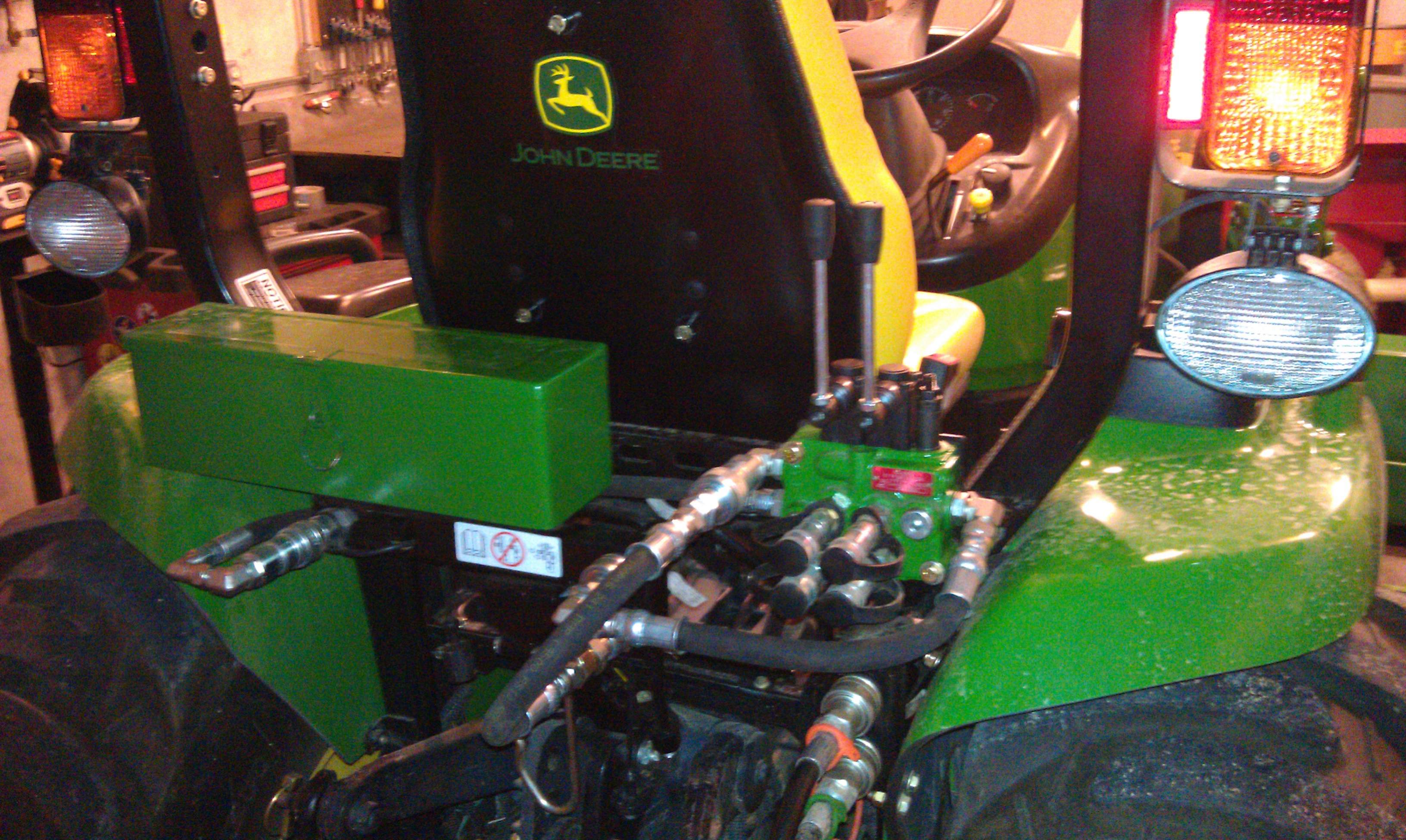

Thought I should post some pictures for everyone since I found it so helpful to look at everyone elses.
I Installed a power beyond kit from JD for $350 and Have about $500 in the rest of it with the wolverine 2 spool valve. I opted to go with 1/4" fittings since I didn't need much flow. I plan to use them for 2" cylinders and found that 1/4" is a good speed for those smaller cylinders that you want for the finess movements.
Now I just need to add a chute deflector to the snow blower.

Nice looking setup!
How difficult was the installation of the power beyond kit?
What parts do you have to remove from the tractor, to access the valve area?
Thanks,
John
/ JD 3520 rear remotes
You have to remove the seat and the plastic cover that goes around all the levers......PITA. Save some patience for it. You have to remove just about all the lever ends as well to make an attempt to get that cover off.

Nice work:thumbsup:
Unless it's the angle in your photo, it looks to me like the two valve control levers for your remotes are aft of the seat. Is this true? If so, you'll need to be triple-jointed to reach them:)

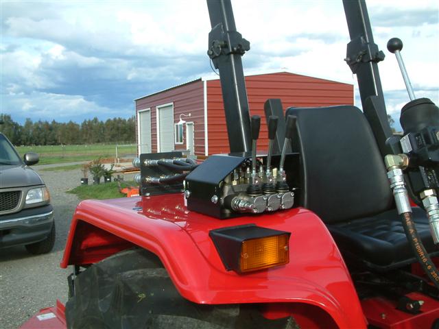

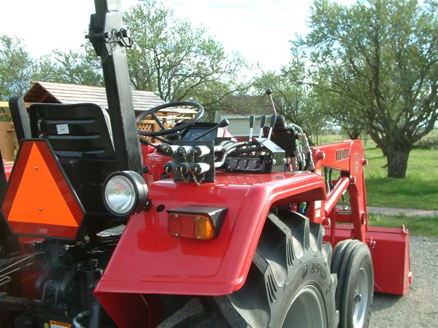

My triple rear remotes are located on the right fender of my 2008 Mahindra 5525 with the valve levers at a convenient location. Love those flat top fenders.
View attachment 236974View attachment 236975
They are aft of the seat and are 1/4" couplers on purpose. I already have a 3rd function outlet on the back for things such as loader implements or other things I don't need to look backward for. The other spool valve is the 4th and 5th function on my tractor. I use it for the PTO snow blower or Top N Tilt. Both things I am cranked around in the seat looking backward to so specific adjustments. With those levers being where they are they are right at my fingertips instead of reaching back by the loader where I am not looking. That is what works for my needs. They are out of the way when riding on the tractor and when hooking things up in the back they are right there to adjust. This is really nice when hooking up T-N-T to implements. The シ couplers help the cylinders move slower to make finite adjustments otherwise the ス inch 3rd function pushes 2 cylinders so fast.

just make sure you have some larger wrenches to make the connections. Around 1-1 1/4". some people use crow foot wrenchs but I was able to get it done with a cresent wrench........but don't tell my wife that or she won't let me get more tools.

No sorry, the mid mount PTO and loader has nothing to do with the hydraulics in the rear for the most part. You need to install a power beyond kit if you haven't already. This is the first step in a complicated process. If this doesn't seem like anything you want to tackle you could always run the splitter off any of the loader remotes or if you have a rear remote.
