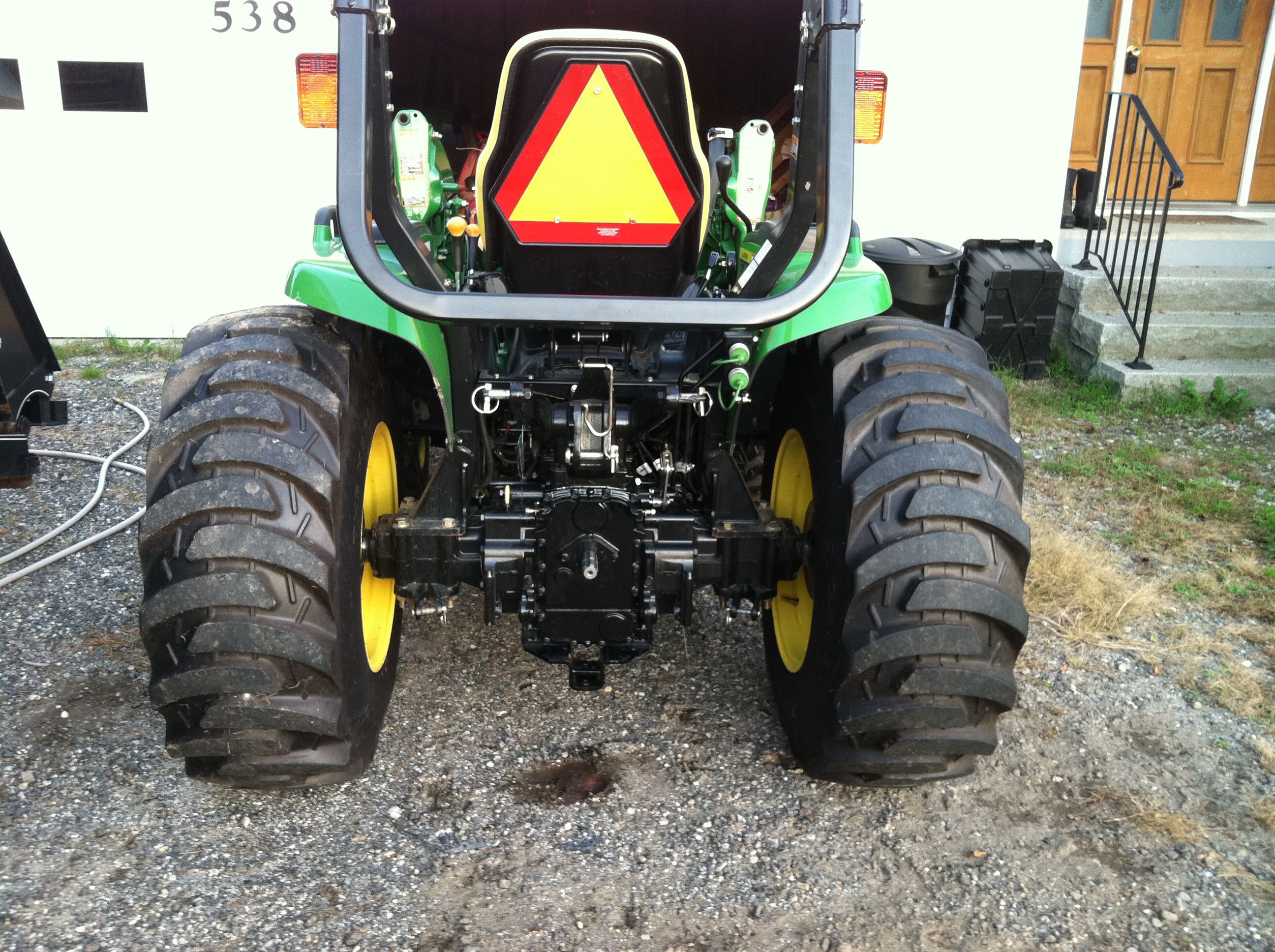

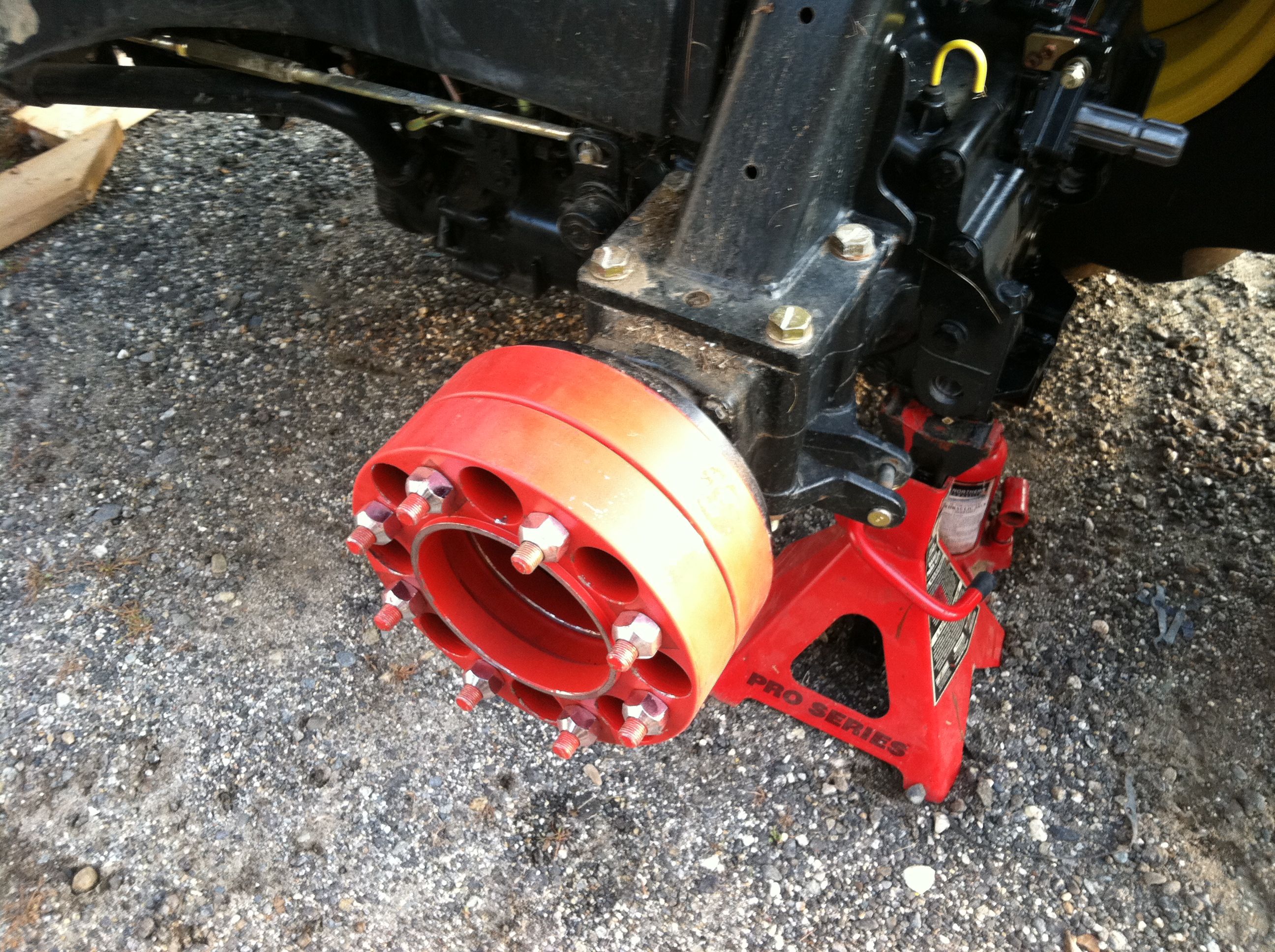

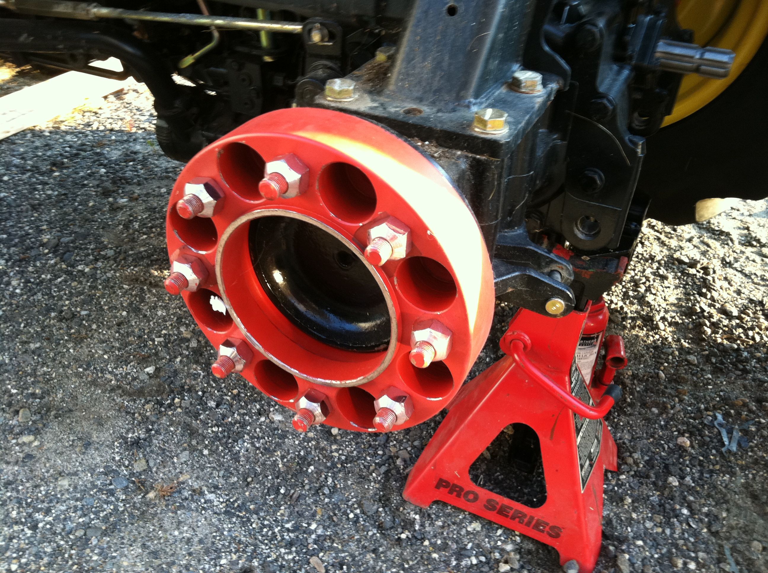

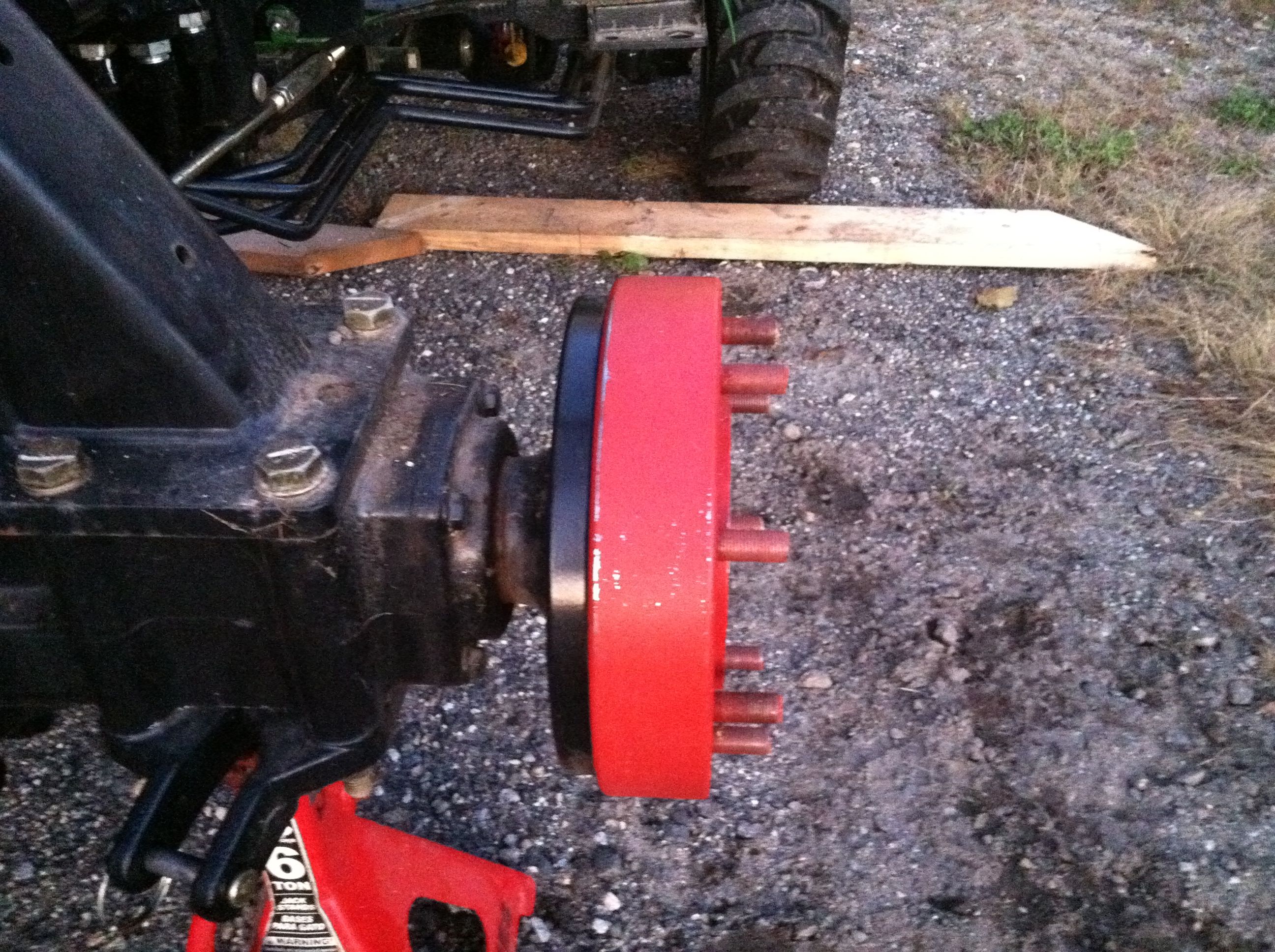

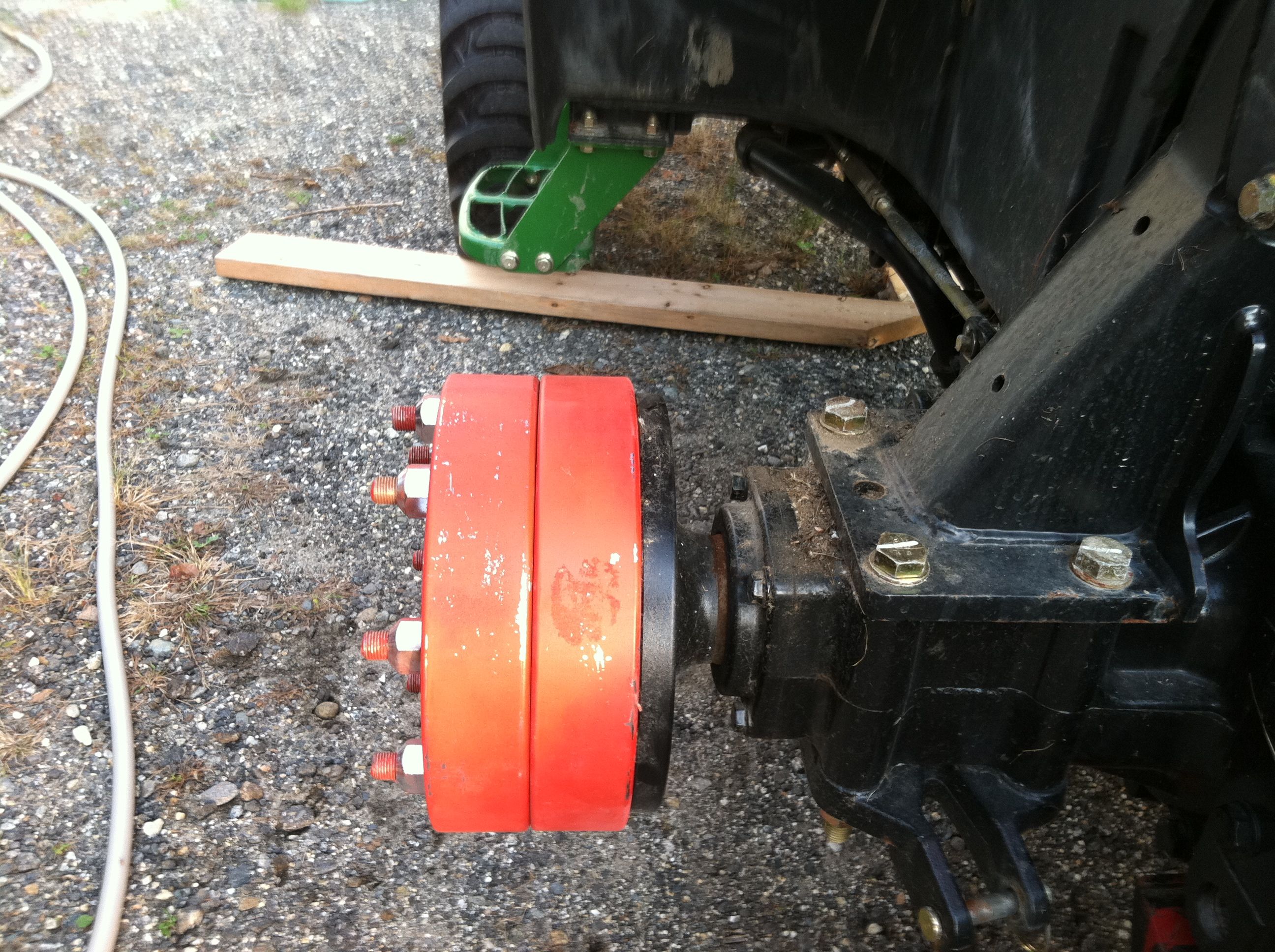

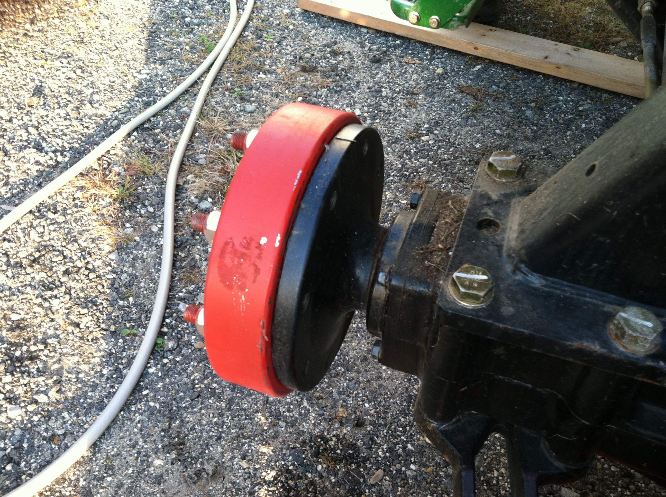

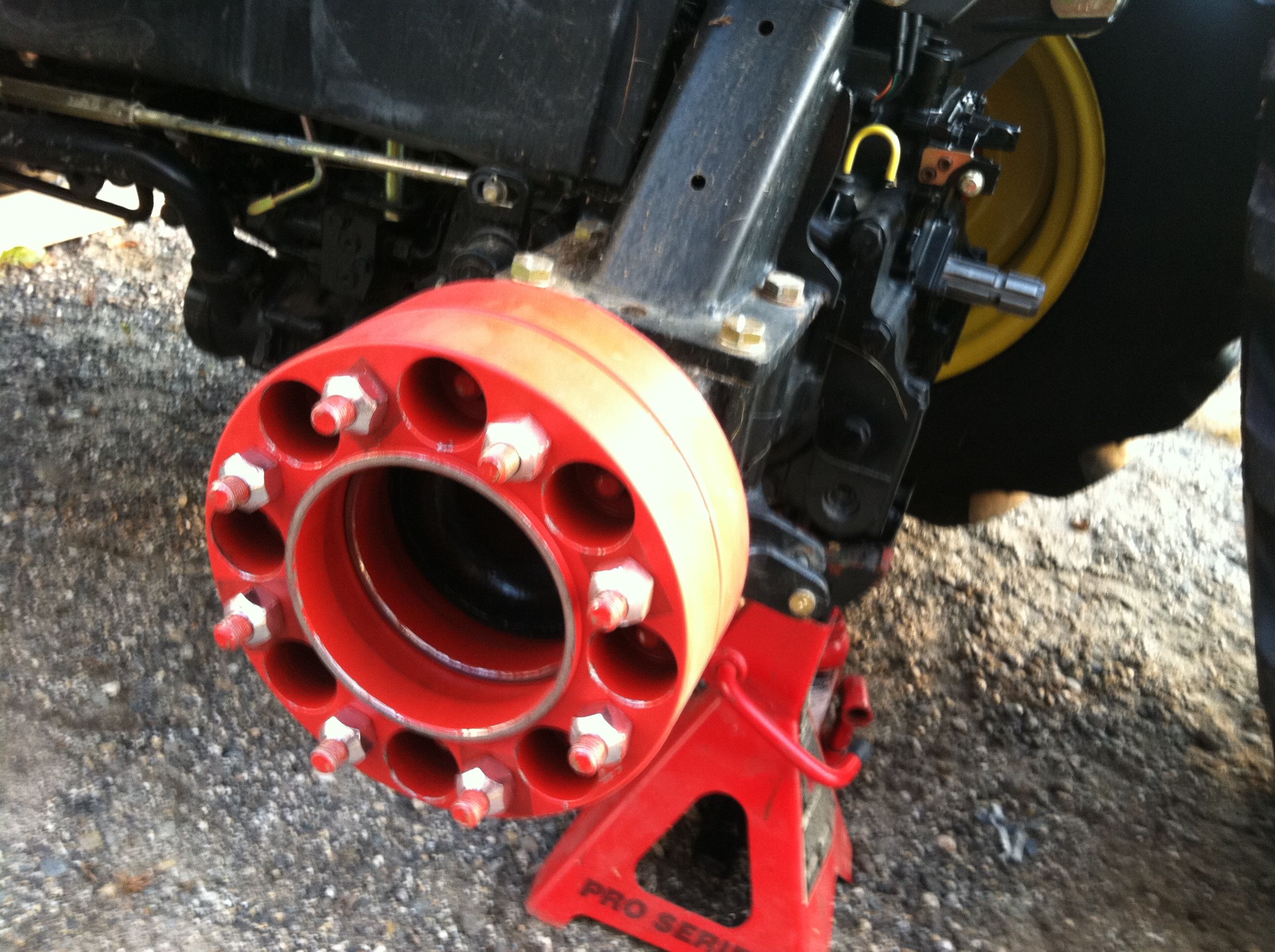

Pictures of 8" of increased track:

It would be nice to have 4" of overall spacing. Too bad you can not buy 1/2 a set. I would not want 8" but 4" with the tires reversed adding a few more inches over factory ship. The only thing better would be to have the spacer very heavy to add ballast and space. I suppose two neighbors could split a set. Not everyone needs 8".
   / JD 3x20 Wheel Spacers? #60
Fuse, if you look at his pics a bit closer, you'll see he has two 2" spacers installed per side and his wheels are reversed (note the valve stems are inside).
Using one 2" spacer (per side) and reversing the wheel would result in about 4" per side (that is, 2" for the spacer and 2" for the reversed wheel), 8" overall.
Just using one 2" spacer, with those wheels set in the normal (valve stems out) position would give you and I the 4" extra we're looking for.
I'm sure Charley will respond to my question about where he bought the spacers and the cost.
