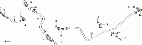

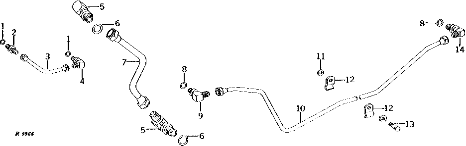

manstihl
I have another train of thought for you. You could replace the fitting(parts key # 5) with a tee to attach return hose. That will accomplish almost the same thing,be cheaper and less hassle when changing hyd filter.
