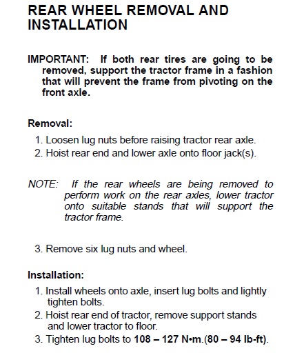

I'm hoping I don't need to go look for my 4100 manuals, and I won't if anyone can provide the required torque for the wheel bolts.
I figure someone has all that stuff at the tip of their fingers.
Thanks in advance.
/ JD 4100 Wheel bolt torque #2
Manual says for the rear..80 - 94 lb-ft
I should have specified front wheels, but it's probably the same. Front takes a 22mm socket. I'll check the back and if it's the same I'll go with that. I'll use my 90fp torque stick.
Thanks.
/ JD 4100 Wheel bolt torque #4
Front wheels says 127-141 lb-ft
Really? That's surprising for some reason.
