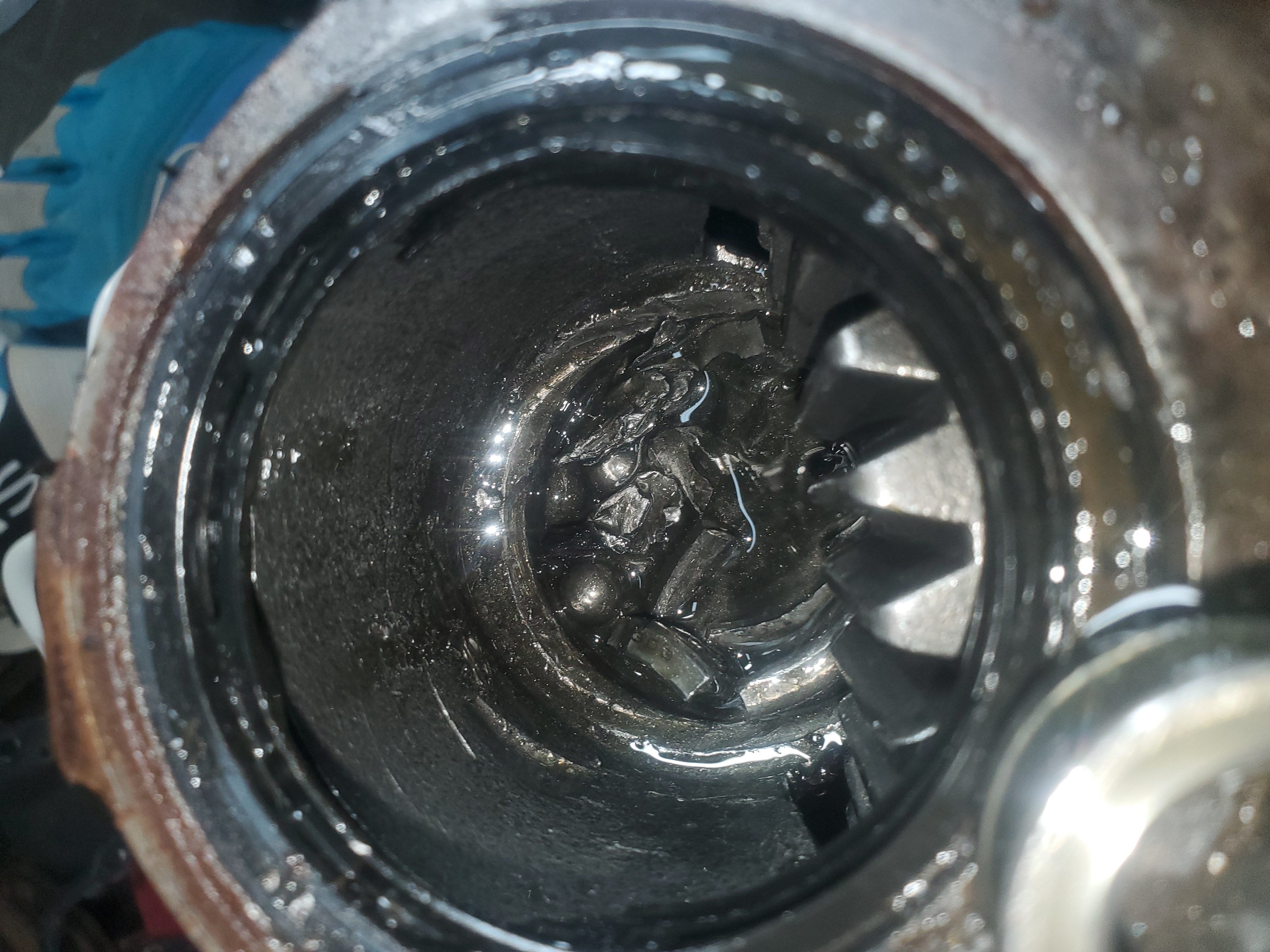

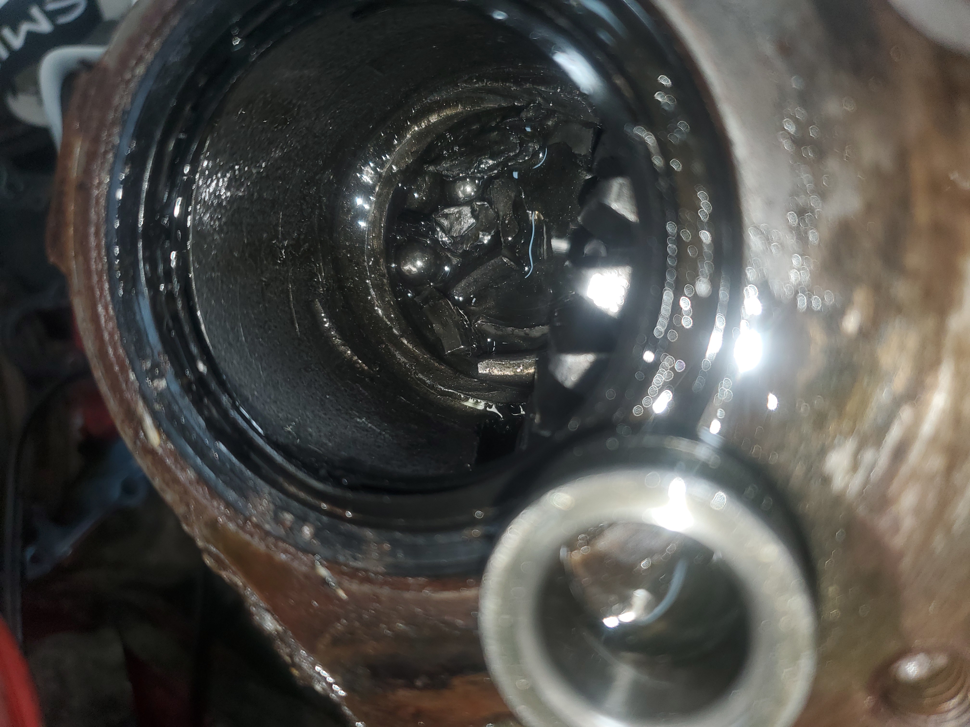

That worked, came off pretty easy with a rubber mallet. This can't be good. Looks like a bearing is shot. Since there was a gap between the upper and lower I hope there is not bigger problem. Where would you start with this mess?

Sorry for the late response. I'm curious to know if you've had any progress with this repair. The photos don't look good, it looks like the housing is pretty chewed up where the bearing seats... I'm not 100% sure, but if you replace that entire housing it may come fully assembled, which may be the route you have to take. I'm not sure how there was a gap between the upper and lower housing unless the bolts came loose. Let me know what you find out.
As for the repair goes on my 4115, I received the parts from the dealer today. I'm hoping to fit check everything and make sure it goes back together this weekend. I will share photos / part numbers as soon as I'm finished.
   / JD 4110 front axle seals leaking-need help/advice #27
well, everything was chewed up pretty good... over $600 in parts.. needed a new Gear case (found one used for $155...new they are $350), new upper gear case with Pinion shaft, sleeve etc ($318) plus all bearings, clips and seals, o-rings and gasket that didn't come with it... the only salvageable pieces left were the gear case cover, final gear and bearing assembly... It's all assembled now....
