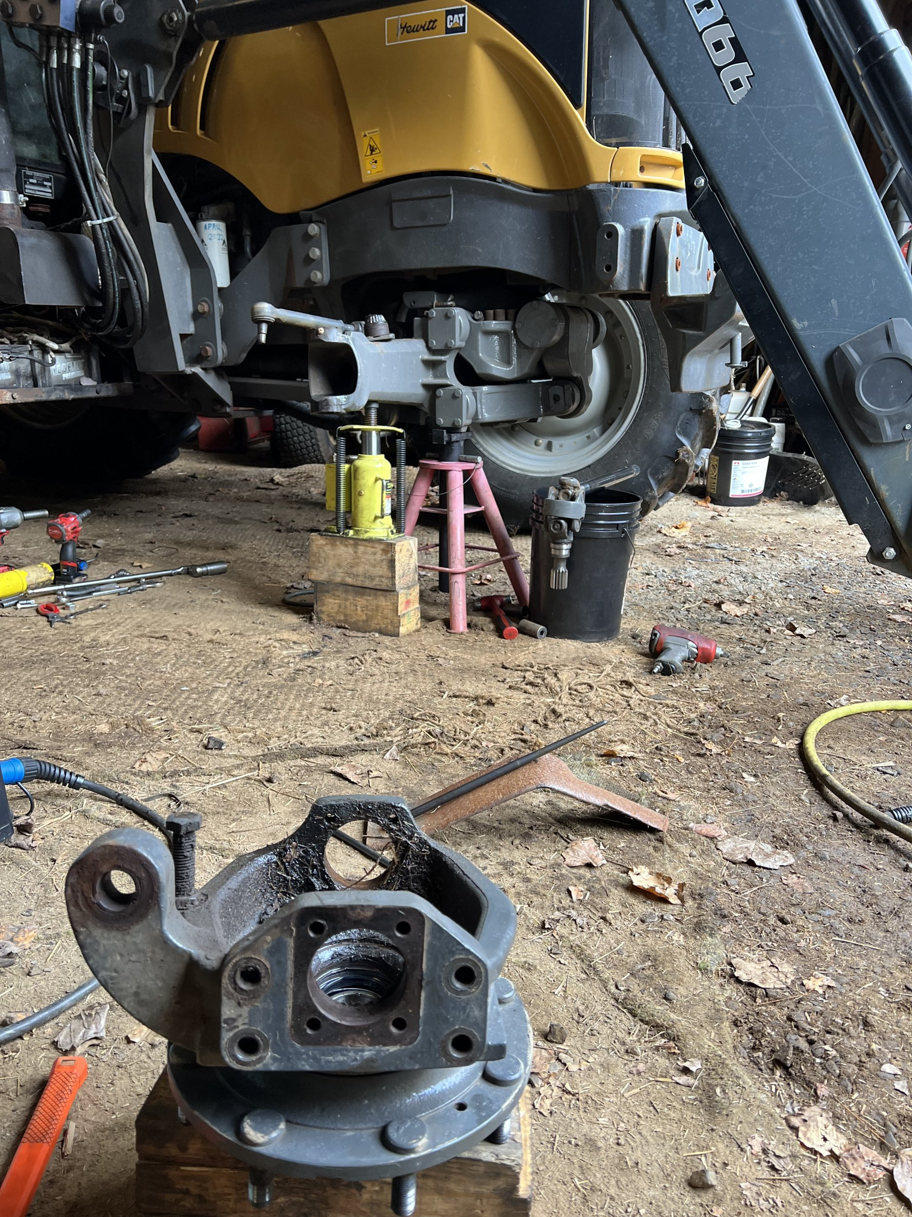

Just replaced leaking front axle seal on Challenger. It was a ***** removing lower kingpin. Had to weld nut on bottom flange.
