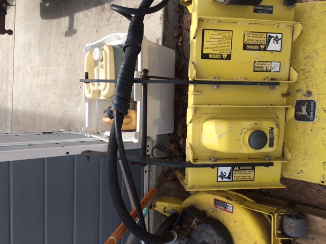

I have a 425 with 3-point hitch. I purchased a hydraulic tiller off CL last year and I think it came off of a 318 JD. I was hoping someone could help me figure out what components I need to make the hydraulic pump work on my 425. I think I need a mid PTO pump bracket so I can bolt the tiller pump to my frame and run it off of my normal mower deck PTO, but am unable to source this bracket. Also, the tiller is not set up for a 3-point hitch so I need to purchase brackets for that as well. Anyone's help would be much appreciated as spring is coming up quick. Thanks!

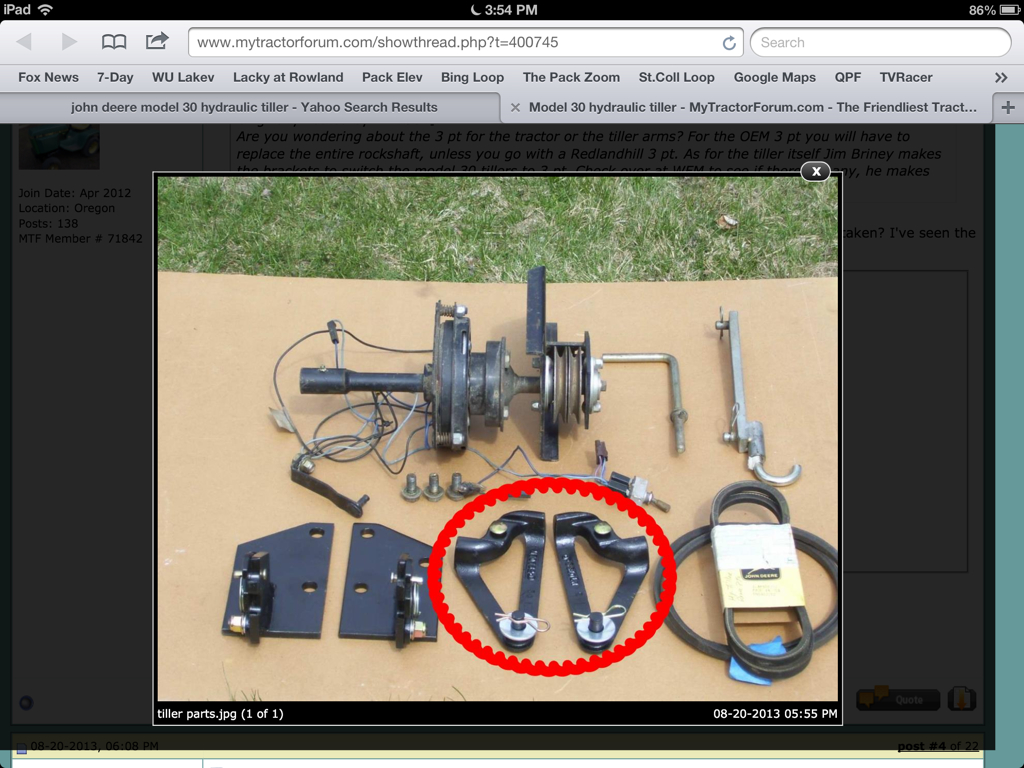

Congrats on your purchase. Is that a model 30 hydraulic tiller with the 12" extension? I have been looking for one locally for a while. Also, reading threads here and on WFM, all who have gone from the pto tiller to the hydro say the hydro is an animal compared to the pto tiller. At least on the 318. Did you get any parts with the tiller, brackets, rods?
The arms on that tiller were made to attach to the same pins where your 3pt arms attach to the tractor. A triangular bracket attached to the rock shaft with some rods hanging down to lift the tiller. A 3pt bracket was not needed on the tiller. This might be easier to adapt to your tractor than making a 3pt bracket.
You will most likely have to modify the hydro pump bracket to fit your tractor. If you can't locate the pump pulley in the exact location of the mower deck pulley then the worst case is you will need a different size belt for roto-tilling.
Since this was for a 318, And I am not familiar with your tractor, the pulley you are using to drive the hydro pump pulley needs to be the same diameter as the front pto of the 318 so the pump spins at the proper rpm. I'm sure others with more knowledge of your tractor can help.
