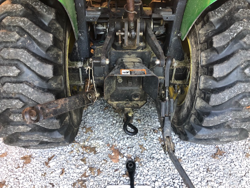

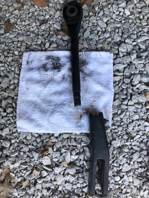

   / JD 4300 Lift Link BREAKING! #13
I'm guessing the thing was just compromised, maybe fatigue and then welding changed it's properties on top of that. Maybe it was seized and someone had put heat to it.
My guess, you get a new one and you will have no further issues.
   / JD 4300 Lift Link BREAKING! #14
I'm thinking the same thing. The replacement link looks a lot stronger than the original. It was probably revised for a reason.
   / JD 4300 Lift Link BREAKING! #15
I bent once have never broke one it happened when I back into something .
   / JD 4300 Lift Link BREAKING! #16
I break these every once in a while on my 4410. John Deere has a heavier duty upgrade available for $$$$.
The first time they both broke and I wasted my money buying new ones. The second and third times just the left side broke. I have just welded it up since. I've felt that the bottom joint has been partly to blame. John Deere's pin is gone and I now have a bolt there. I can control how much slop there is in the bottom joint by how tight the bolt is.
I've also broken both lower arms. Again they were repaired by welding them back together. Sometime a project is going to be manufacturing two lower lift arms. I don't like how they have a bend in them. The new ones won't have a bend. They will be straight. My wheels are always on the wide spacing so I don't expect to have interference problems.

   / JD 4300 Lift Link BREAKING! #19
Since the failure is occurring on the lower part of the rod, right at the threads, is it possible that water, salt, ice or snow is being trapped there?
That could lead to corrosion and weakening.
If that is possible, I would apply some heavy grease at that location.
