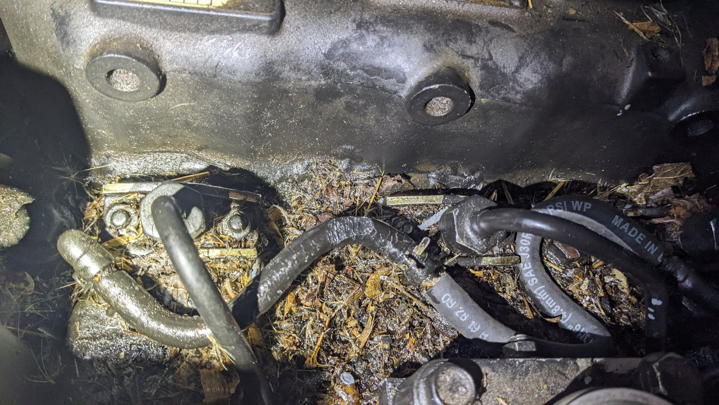

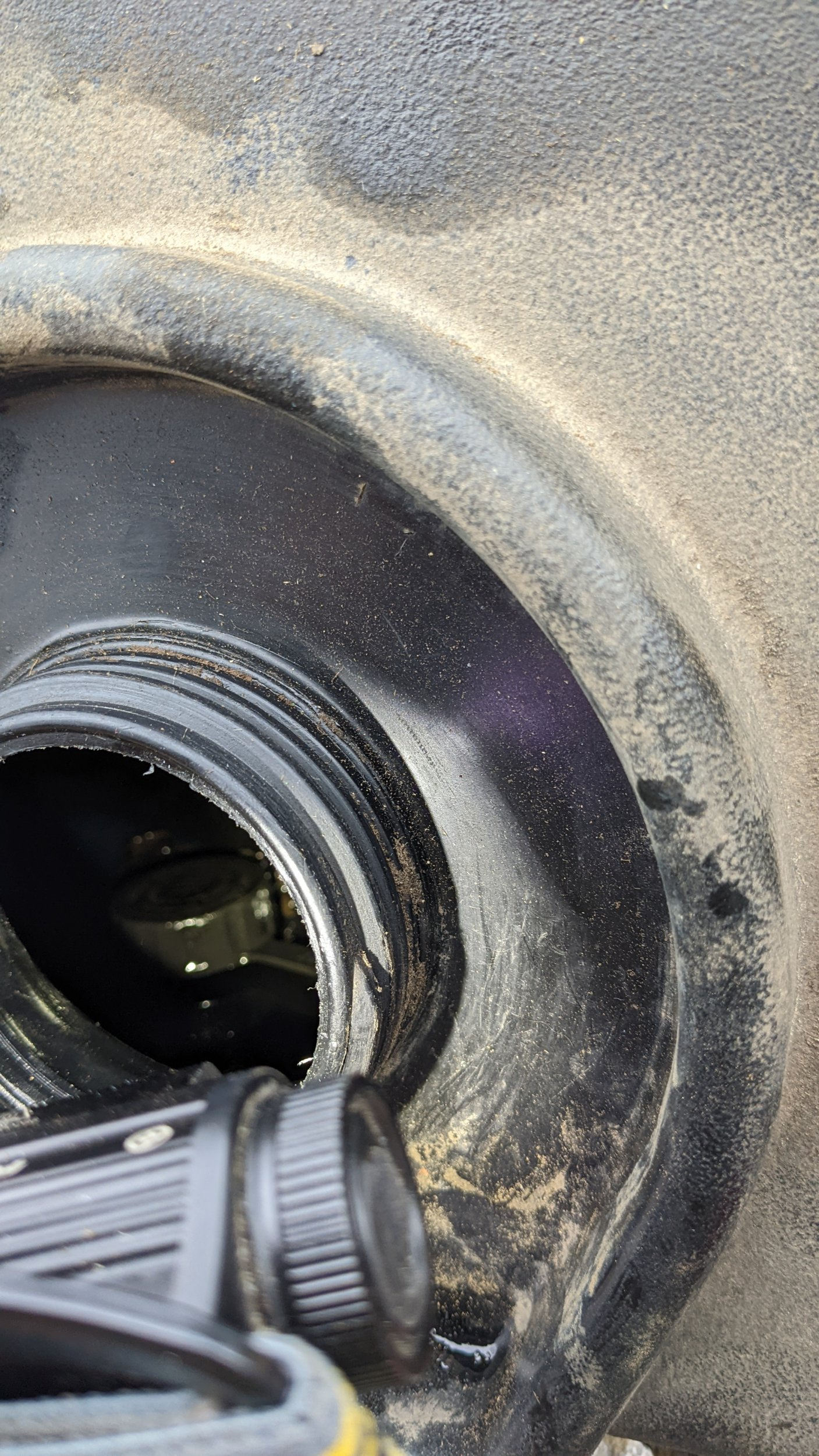

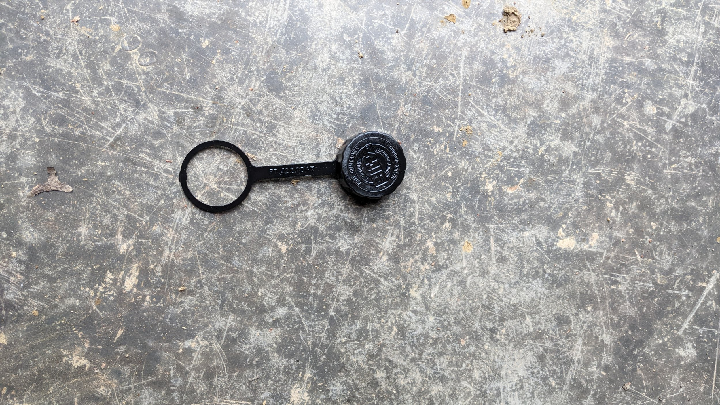

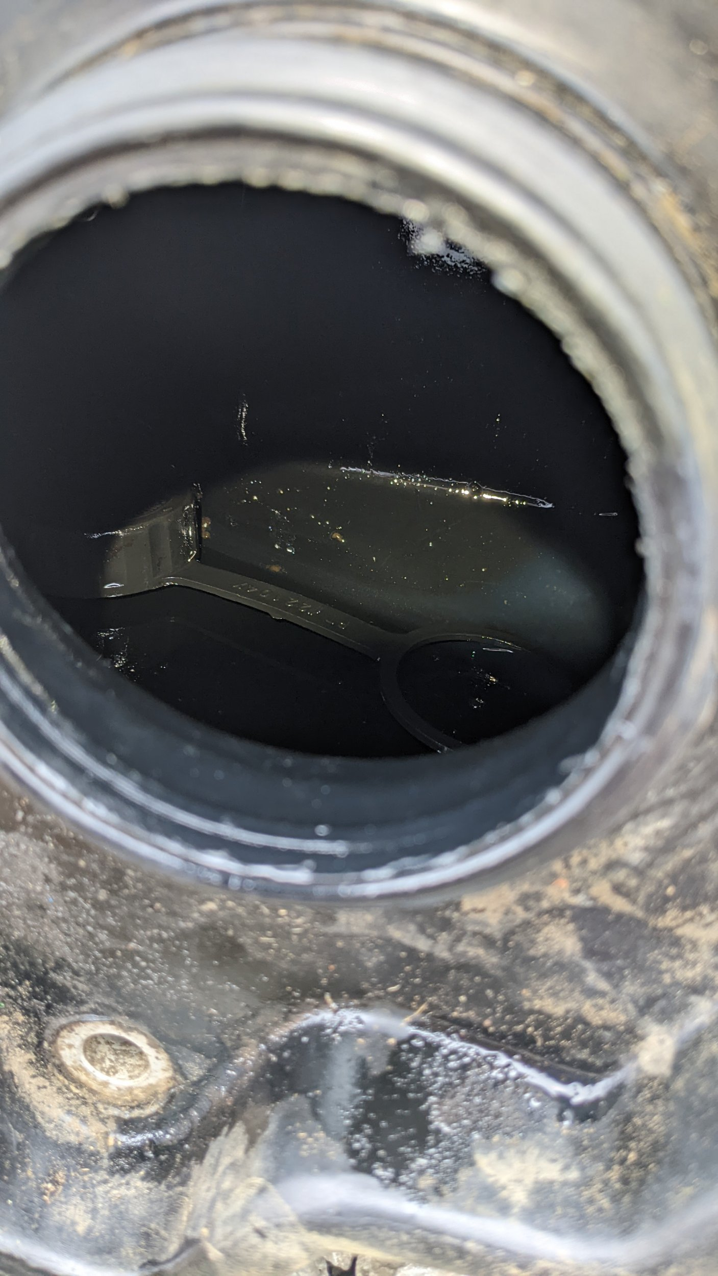

Hi everyone, I wanted to provide an update on this as it probably pertains to others who have bought used tractors. Coincidentally shortly after posting this in the forum, a mouse made a nest in my tractor and chewed into a hose going into the injectors on the top of the engine. That caused a diesel fuel leak, which I needed to repair, though the tractor still around fine, it was just causing an environmental disaster. To get to the hose, I was forced to remove the gas tank entirely, which, FYI, was not fun. I was flushing things out with some diesel and turned it upside down only to find some kind of gas cap that a previous owner must have dropped in the gas tank and never retrieved.
Luckily there wasn't much other debris in the tank so pretty much 100% sure this was the issue all along. That said the thermistor did need to be replaced, as now my engine starts right up immediately which it didn't previously do.
Thanks again for all of your comments.
