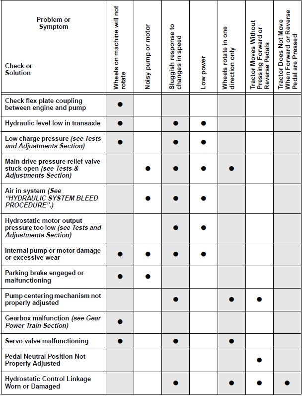

A page from the troubleshooting section of the service tech manual.. hope it is linkage.. if been in the brush, might have happened..
   / JD 4300 stops moving in forward and reverse after a few minutes - engine still runs
Thanks for posting that. I do use it in moderate brush, tall grass with saplings and whatnot. Nothing looks out of whack just looking but hopefully this weekend I can get someone else to stomp on the pedals (with the engine off!) and at least make sure everything that is supposed to push, pushes and everything that is supposed to pull, pulls.
