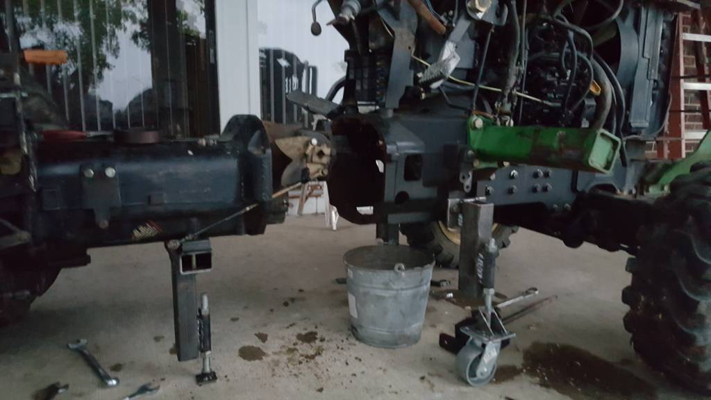

My local JD shop would not quote a time estimate to split my tractor. Only $145/hr.
I built the stands in a couple afternoons. Where are you located? 20170626_052240.jpg

Your home made stands look great. If I was anywhere near you I'd be making you an offer to try to rent them or might try to weld something up myself. But, to be completely honest, I can't see trying to split the tractor myself. I'm still learning all of this as I go and I don't want to spend the rest of my life hearing I told you so if I didn't fix or made it worse from my otherwise very supportive wife!
