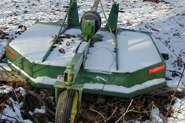

The 513 is okay for brush, but not real tough unless one adds some steel to beef up the back side. The metal is a bit thin, I suspect it is on purpose to keep the weight down. I added some 1 1/4" square tubing to the rear that makes it much more resistant to bending when backing up and catching stumps and dirt banks. I much prefer to cut brush with the FEL on, but may do some light weed mowing without any extra weight on the front, including the FEL.

A neighbor of mine has the 513 and after about 1 weeks use it was appaling the way that thing was bent up on the back.....like you, he had to do a little modification/fab work to get it right....and thin material is an understatement....I bet if you turned the 513 it would probably say "Campbells soup" on the other side....nothing much more than a piece of tin /forums/images/graemlins/tongue.gif...He could have almost bought 2 nice King Kutters for the money he paid for the 513.....anyway.

With the modifications I made, I am quite happy with what the 513 can do. If one didn't back up, then I suspect the rear steel on the skirt would hold up pretty well. However, I do a lot of brush cutting by backing into the brush. I would rather not drive forward over anything as big as what I grind up in the 513 going in reverse.
Attached is a pic showing the three square tubes I welded onto the lower rear skirt (after beating it back into line)

That looks nice...too bad John Deere does not do something like that....I noticed on those 513's the length of the angle coming in towards the end of the wheel is a little longer than on the one side....do you know what I mean ?

FYI - The non-symmetrical rear of the 513 allows for a more even spreading of the shredded material due to the rotational direction of the blades. If the right rear were to be close to the blades like the left, material would pile up in a windrow just to the right of center. The system works pretty well, but you will notice cutters with an opening in the rear or with air management baffles typically can be built with a symmetrical tail.
