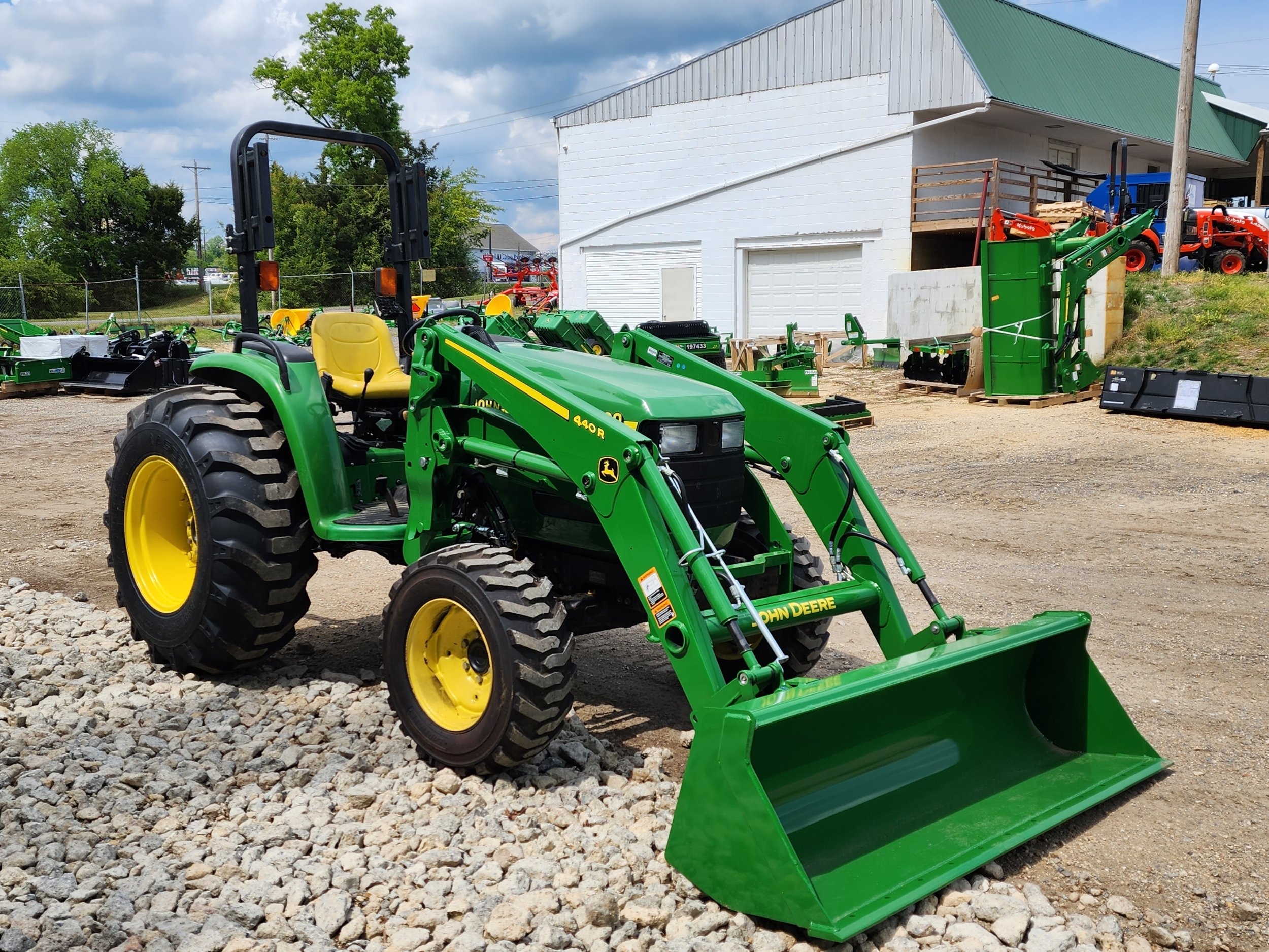

now John deere does currently make a loader thst fits your 4600, it's the 440R . I just had 1 put on my 4700. it's not cheap. but it's a beast of a loader.

Thanks guys. The mounting posts for the 440r the same as the 460 or will need specific ones for the 440r?

I don't know for sure if the mounts are the same. they look like they could be . but without having a earlier set to measure i cant be sure ? You can order the correct mounts for the 4600 when you order a 440R , you just have to tell the sales guy . it was no extra cost compared to the same set up for the 4044 tractor that I could see.
the aluminum comment is only applies to the 4100 to 4400 models. the 4500 to 4700 were all steel !
