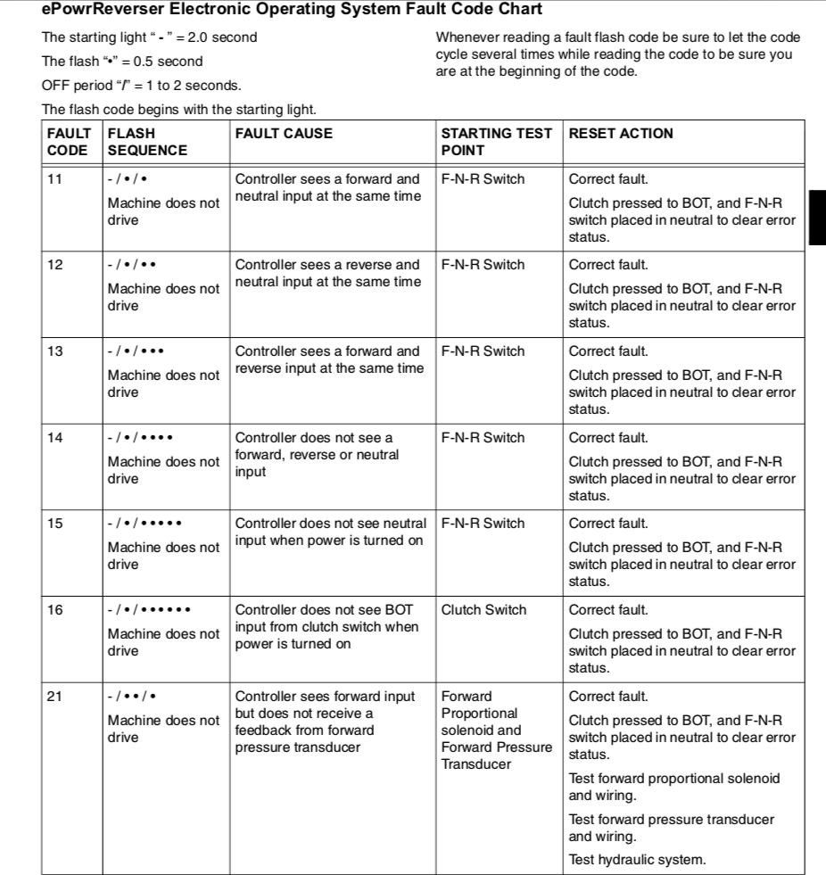

Jan 23, 2024 / JD 4310 - ePower Reverser Codes #1 D dlloyd525 New member Joined Jan 23, 2024 Messages 1 Tractor John Deere 4310 I am looking for the codes for a JD 4310 - ePower Reverser. Sometimes it will not crank and is flashing 1 short, 1 long, and 6 shorts. Thanks in advance for any help. Danny

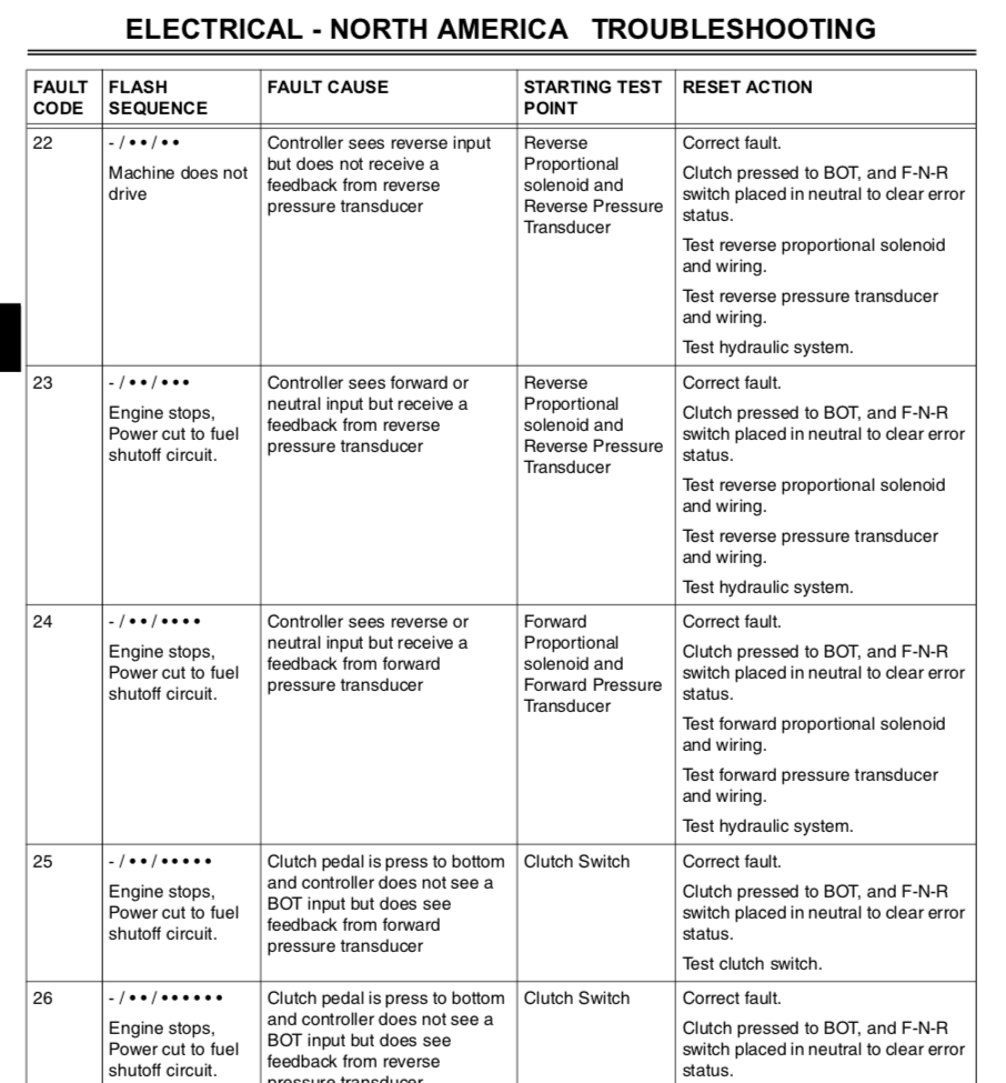

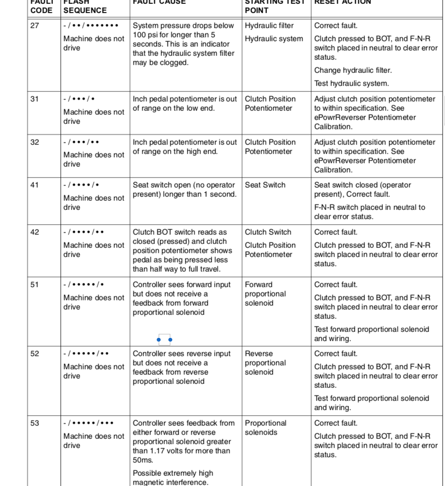

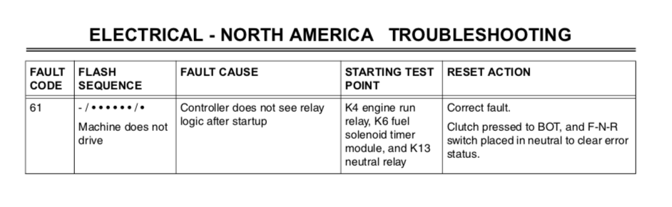

Jan 27, 2024 / JD 4310 - ePower Reverser Codes #3 S super55 Platinum Member Joined Jan 27, 2012 Messages 968 Location Great North of Michigan Tractor Oliver Super55, John Deere 4310, John Deere 4400, Kubota L2500 (had), Here you go. Attachments Screen Shot 2024-01-27 at 5.46.17 PM.png 224.5 KB · Views: 176 Screen Shot 2024-01-27 at 5.46.47 PM.png 204.8 KB · Views: 169 Screen Shot 2024-01-27 at 5.48.10 PM.png 227.1 KB · Views: 204 Screen Shot 2024-01-27 at 5.52.07 PM.png 46.9 KB · Views: 158
