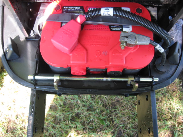

Tn, which Optima model (group) did you use and what specific modifications did you have to make?
If I'm not mistaken it's the group 34 red top. The Optima is just a tad bit bigger than the factory battery so when the mounting plate goes back on the holes are off. I took a drill and elongated the holes on the plates. This allows the bolts room to screw back into the original holes. The hood opens and closes the same and no problems with the hood latch which is on the plate. I may have a picture of the holes and will post if I do.

Tn, I received your PM and will go with the Optima Red Top Group 34 if/when necessary . Hopefully your problem is solved. Please let us know of any future problems with the Optima. Many thanks for the info.
   / JD 4320 Battery Leakage and Related Corrosion #19
Here is another pic that shows everything lines up as it should.
