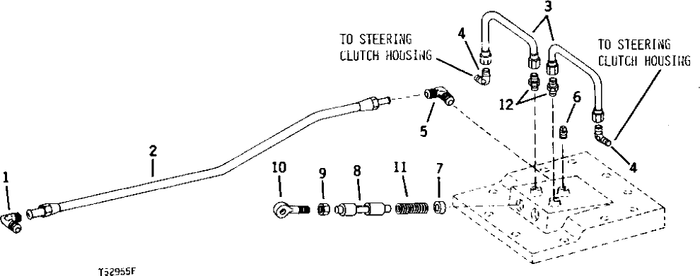

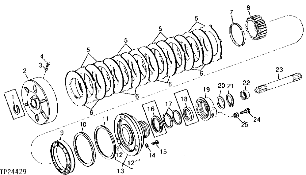

Good morning all, new to this forum. I have a JD 450C with 3600+ hours, 1978 model. This is a new machine to me and the first machine I have owned. The other day while using the machine (machine worked as intended) the right stick for steering became harder and harder to move machine in intended direction until it finally stopped machine completely when pulling back. A few weeks ago I broke a hydraulic line on the backhoe, fixed it and filled reviser with fluid. I am wondering if this may have anything to do with the issue at hand. Looking under the seat I find two hydraulic valves which I am assuming are the brake adjusters? I am also assuming that pulling back on the track steering applies pressure to the brakes to turn? (Remember, I am new to tractors) Can someone give me some help in trouble shooting this issue? The machine drives straight right now but, when pulling back on the right stick, machine stops. When you let go of the stick it holds fast for a few seconds then releases and will travel forward again. Also, are there any fluid filters to change on this machine? I do not have a service manual for this machine! Man are they expensive! Any one have one for sale or know where I can get one? PDF version is fine.

You're correct in that steering clutches on 450C are hydraulic. I would guess faulty control valve, low pressure or worn clutch discs.

Thank you for the reply and the diagrams. Here is what I can tell you. Referring the the second diagram. 1) how do you remove the valves and do you by chance have a part number. 2) right valve when line is removed from top will shoot fluid to the top of the cab with engine running, with valve open it stops. 3) left valve when line is removed from the top only shoots fluid about 18 inches high, with valve open it stops. Which valve is operating properly?
Again, thanks in advance for any help, Kaelin

IMHO right valve is operating correctly BUT my JD industrial equipment knowledge is very limited as I was employed yrs back by an "ag only" JD dealership plus I have no access to a 450C tech manual.

Don't have a pressure gauge but I replace the spool valves. Today I adjusted the brakes looking at the simple stuff first. Then, reading on another forum one gave instructions to test the drive clutches by pushing up against something stopping the tractor. Giving it throttle, only the right track turns. If this is the case it tells me that the left drive clutch either needs to be adjusted or replace. My question then is; does my left drive clutch need to be replaced? Is there a way without tearing half the machine apart to adjust the clutch pack? Now for the zinger. I am rural Alaska where the closest mechanic is hundreds of miles away. Besides any travel time hourly rate is $160 to $200. And being the left track doesn't drive, I can't get it loaded onto the trailer to move it from my property.

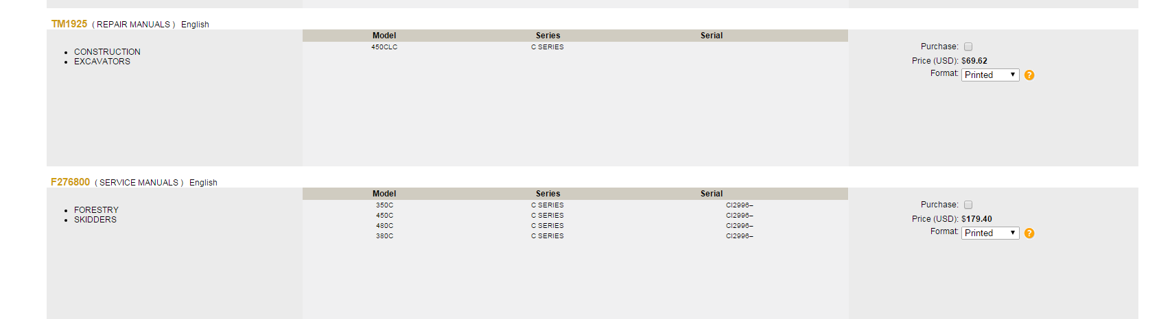

There should be a test port to check clutch pressure. I will suggest you get a JD tech manual. phone # 866-213-3373 John Deere Bookstore

"On your dozer you will notice a small triangle shaped cast plate on the drive casts both sides just above the tracks take the bolts out and get someone else to pull that side leaver .Here is where you set it .Set the clutch to open just before break enguages .Only if break bands were set up wrong will they need to be replaced and this could occur at any time .If the break sets it self to high then you have a lose older system and you can back the break of at the setting area "
