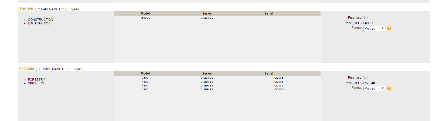

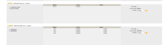

   / JD 450C Steering issue #13
There should be a test port to check clutch pressure. I will suggest you get a JD tech manual. phone # 866-213-3373 John Deere Bookstore
