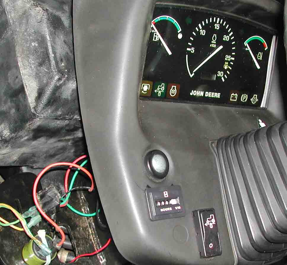

And bolting a temp gauge on top of the console would look really stupid.
Not really. If the temp, fuel, or hour meters go bad, I suggest doing exactly that, as I did
on one of my 4300s. Lots of room on the left side.
I have been inside the cluster, checking for bad contacts and cold solder joints.
I am #4 for checking the thermostat. You can boil it in a pot of water to test, and buy a
replacement at your local auto parts store.
