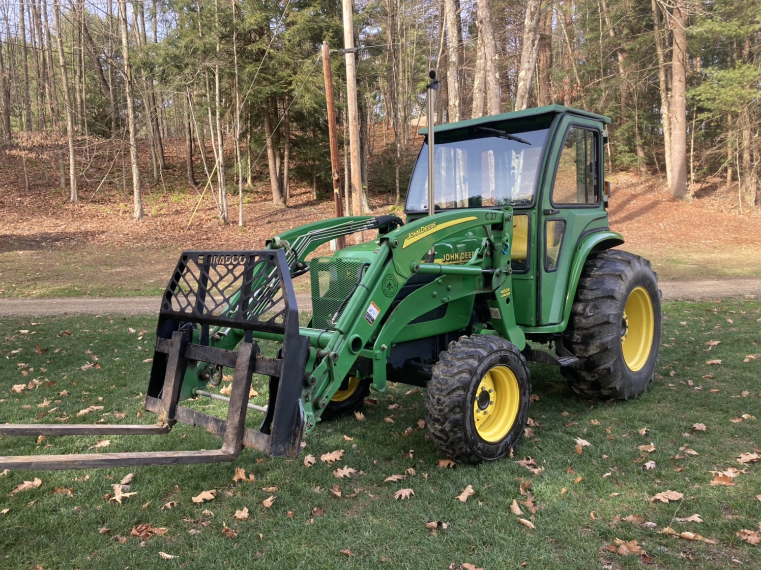

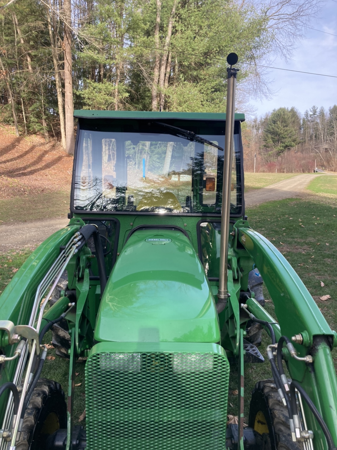

I got the machine home last weekend. I will tackle the cab this spring/summer when it's warmer (My shop is not heated). It appears that the metal is all solid, but in many places the paint has separated from the metal, like the examples in the previously posted photos. I'll share updates on the progress of the project when I get to it. Right now, I have the tractor at the welder's shop where hooks are being added to the bucket, the cab doors are being tweaked so they seal properly on the bottom, and he's fabricating a vertical exhaust. I found in my limited use of the tractor, that the exhaust fumes from the standard exhaust location travel under the tractor into the cab.

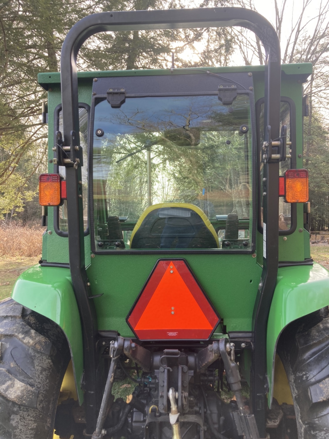

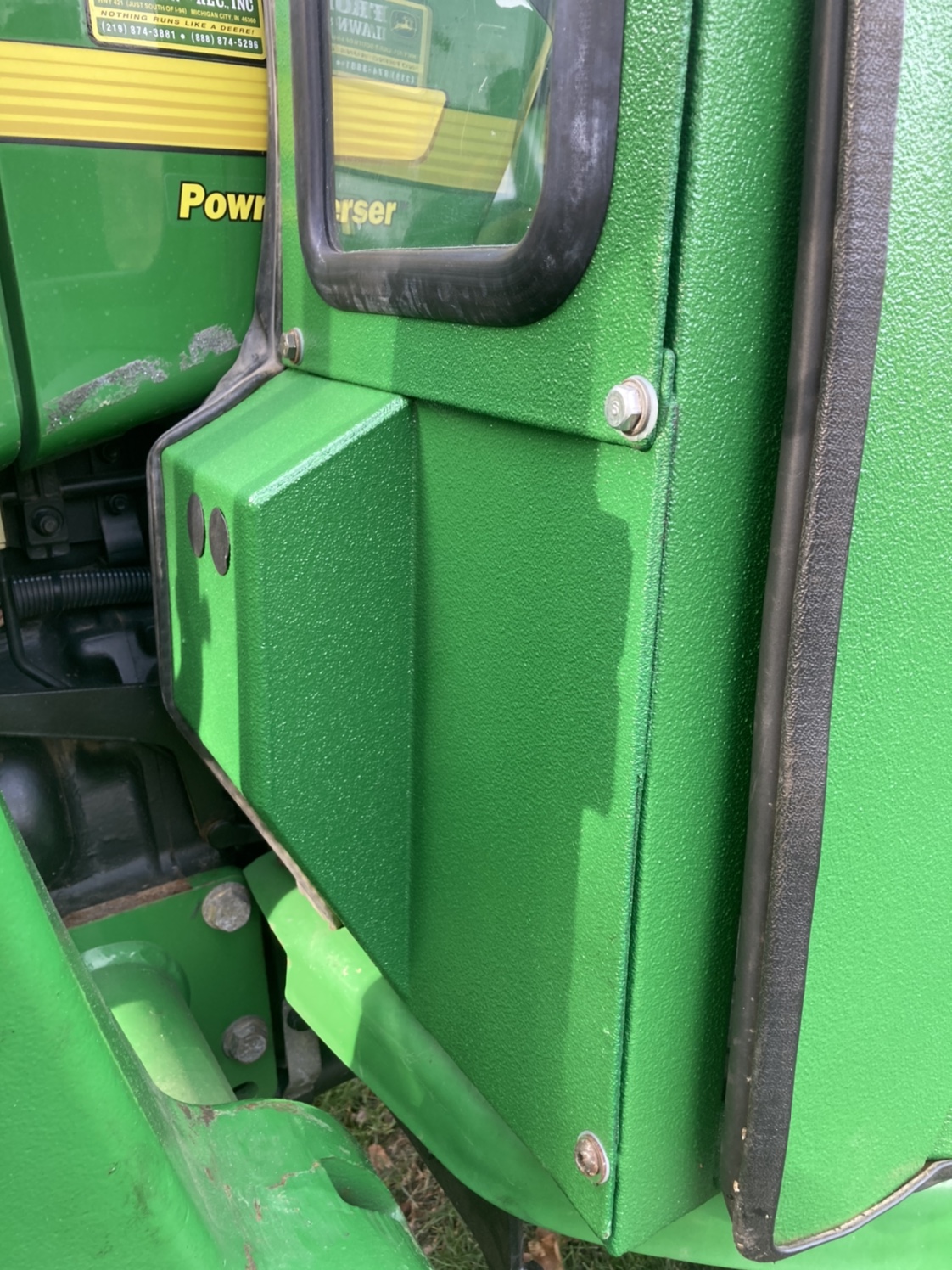

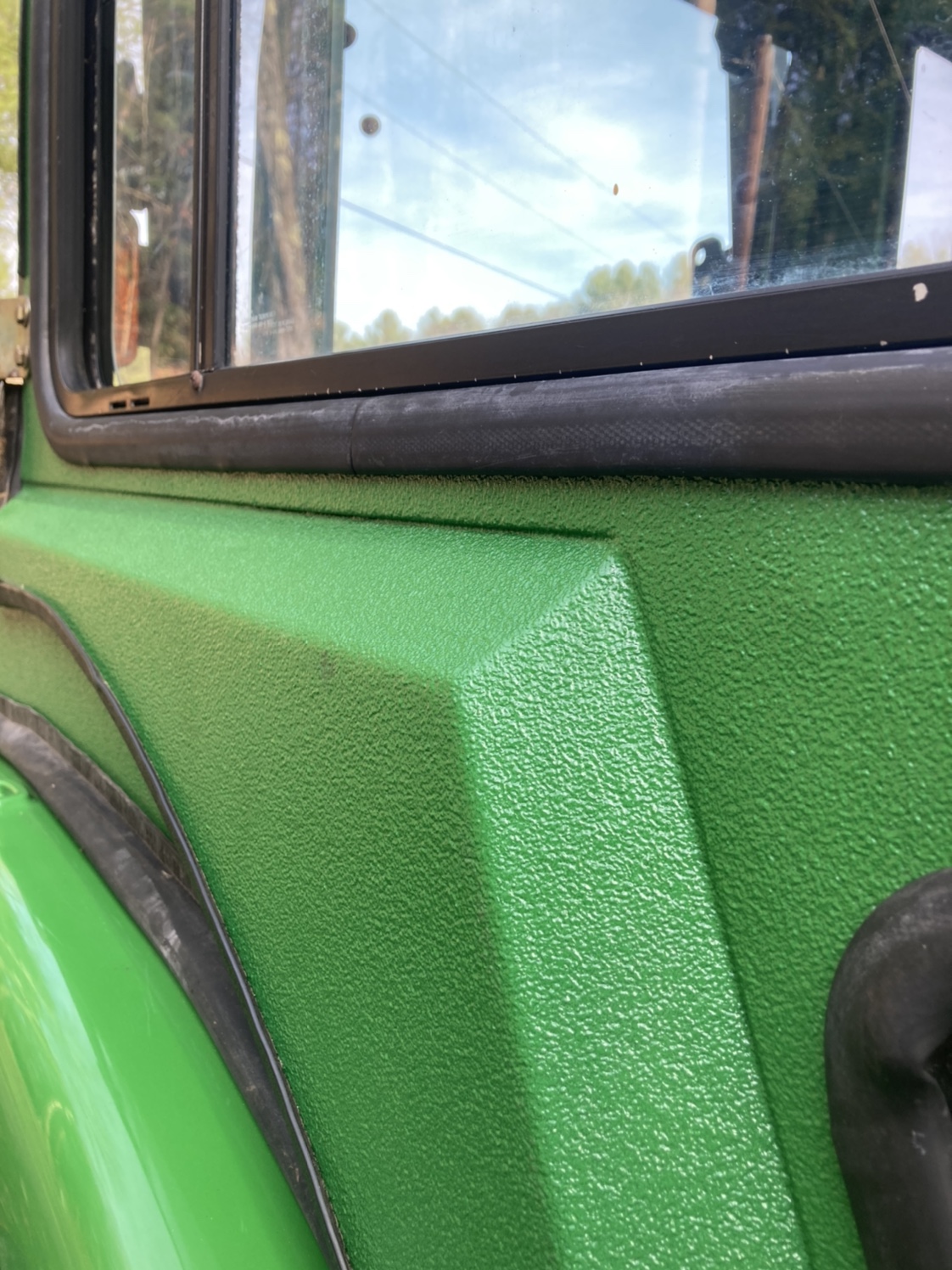

I wanted to provide an update on this project. The tractor has been great - I've put about 110 hours on it now since we got it in January. We took the cab all apart in August. The windows were actually pretty easy to get out. None of the rubber gaskets ripped. I spread crushed asphalt at a welder friend's shop parking in exchange for free sandblasting of the entire cab. I decided instead of painting the cab and probably having to do it again a few years later, that I'd get the whole thing coated with Line-X bed liner. I dropped it off yesterday in pieces and for about $650, it's all going to be sprayed with JD green color matched Line-X. When I get it back, I'll share some photos.
   / JD 4700 Curtis Cab rehab
#24
Picked up the cab pieces from Line-x last night. Everything looks good. Will start putting the gaskets and glass back in on Saturday, and perhaps start mounting back on the tractor.

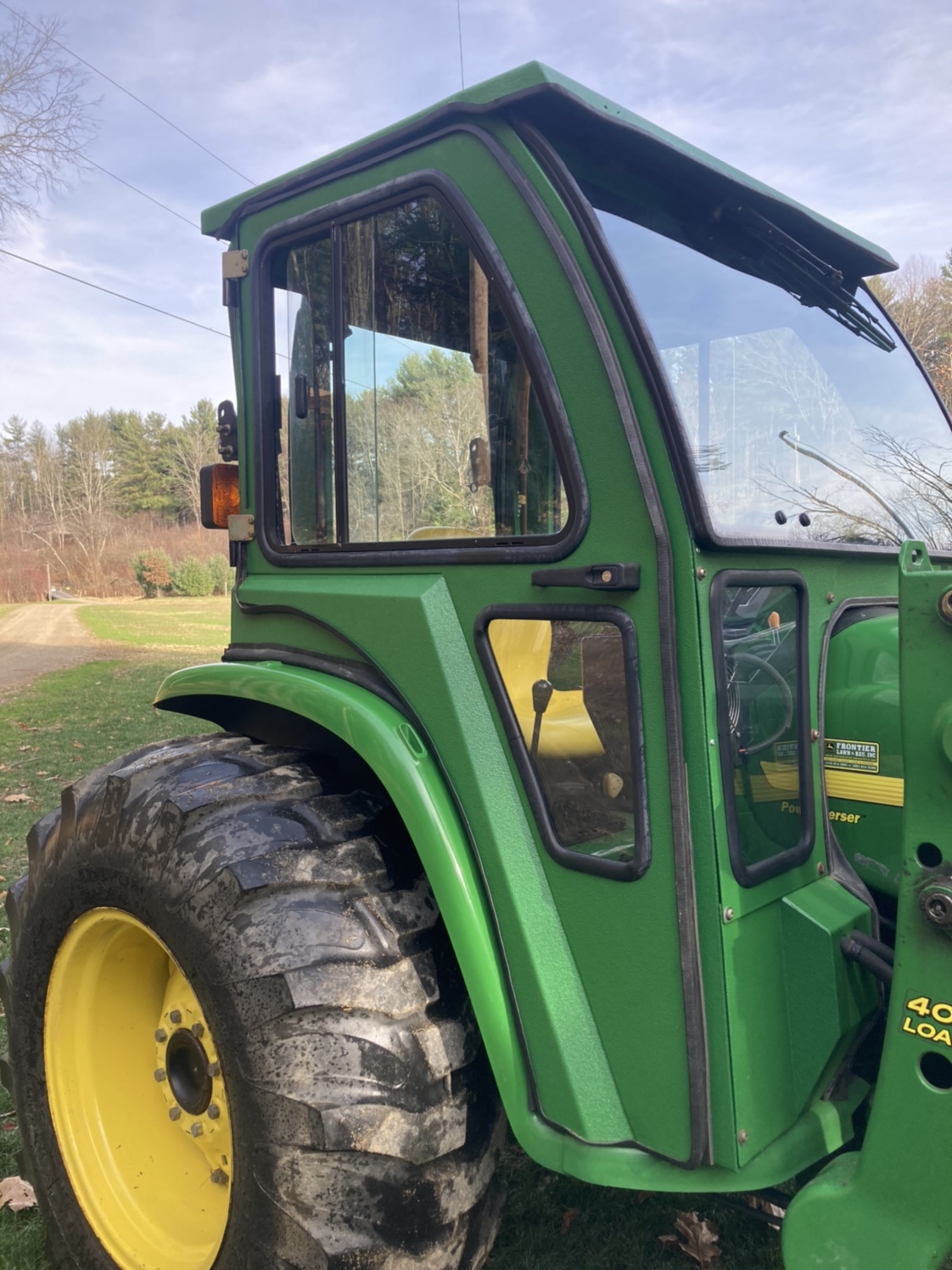

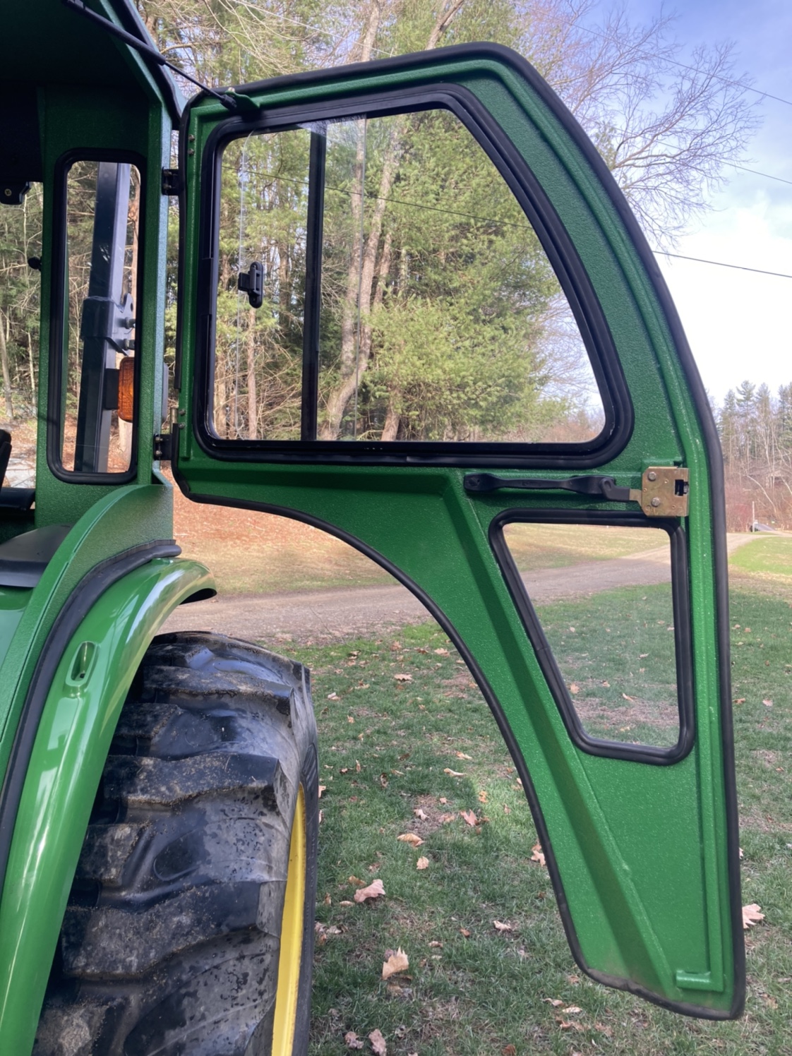

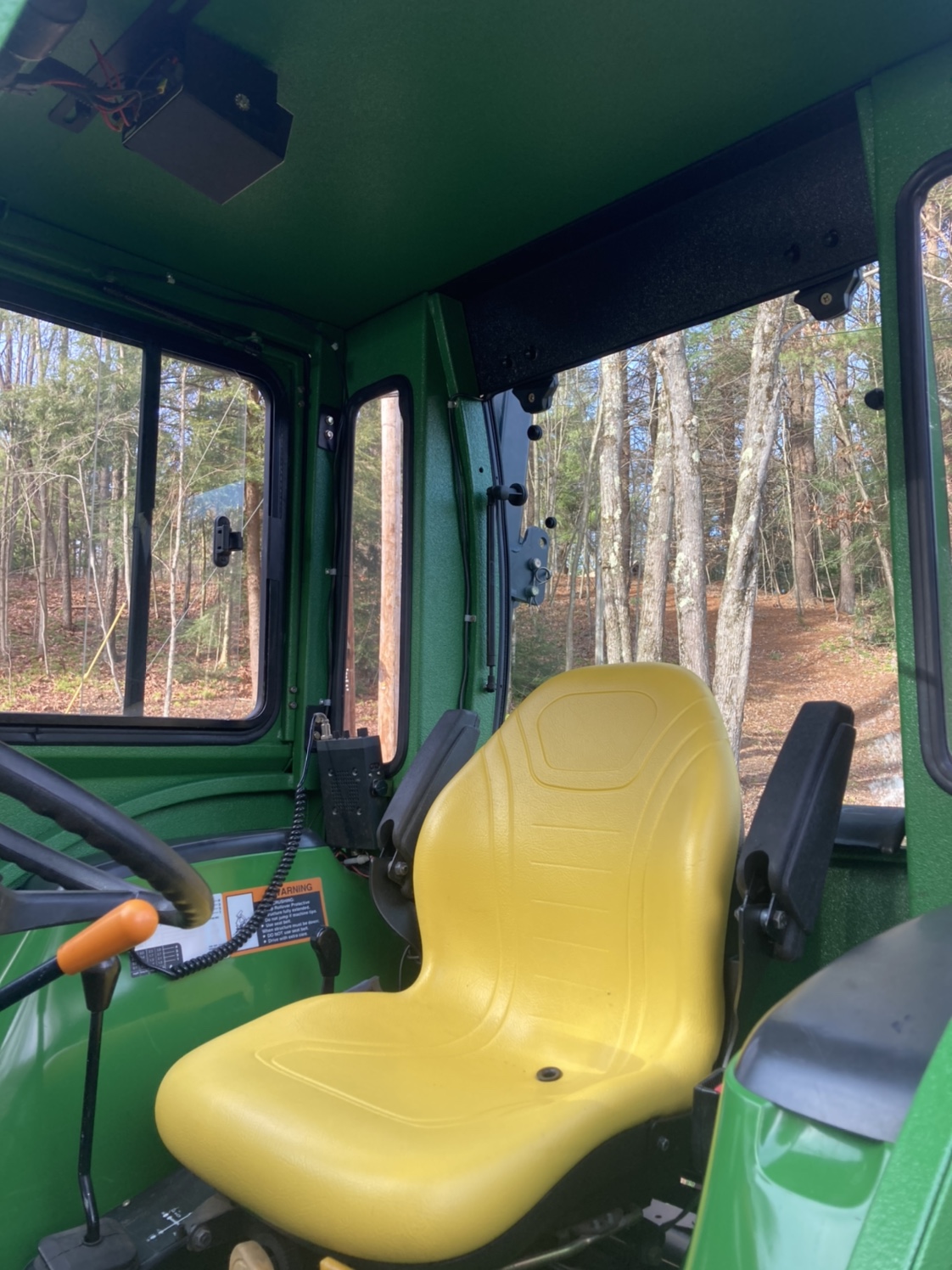

We finished reassembling the cab last weekend. What a major PITA! It took about 20 person hours - windows, gaskets, latches, etc. I had to keep reminding myself that I’ll never have to do it all again since we opted for Line-X (a suggestion by my wife!) instead of just painting it.
Anyhow, I recommend going this route if you want something durable, lasting and good looking.

Beautiful and hard-working!?!? You're smart to take good care of this girl because you're lucky to have her.
Your wife seems nice too.
   / JD 4700 Curtis Cab rehab #29
Looks good. The gaskets are always a pain, another set of hands always helps with installing them.
