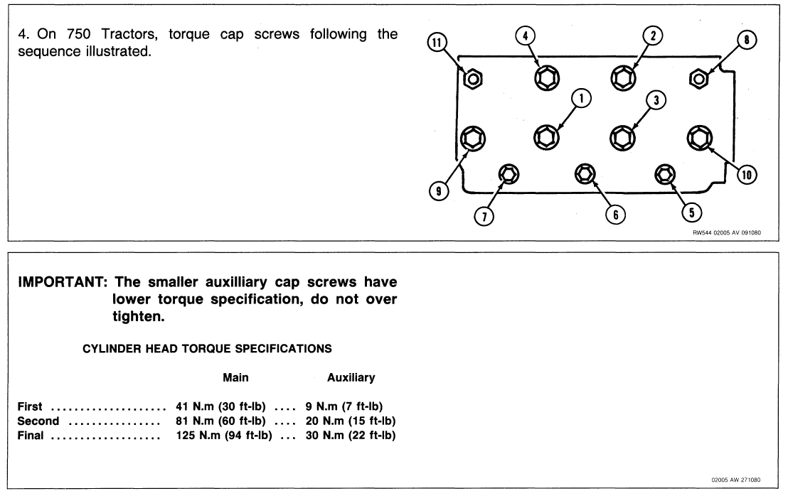

Some bad news !
I got a new torque wrench that was defective resulting in the over tightening of this bolt that cracked the block.
This is the end of the road for this machine. No more money can go into it. The bolt will hold the 94 pounds of torque required.
See photo...
Is there any hope?

   / Head gasket sealer on John Deere 750 #28
Time flies. LOL
JD750 . . .
   / Head gasket sealer on John Deere 750 #29
It looks like the corner screw was indeed over tightened. By 4 times no less. I am surprised that the main cap screws have such a high torque, but then, like I said previously, I am not a diesel mechanic. As to welding, bmaverick's post is excellent. Stainless steel is often used to repair cast iron and I have done it myself, but only with stick and TIG, and only with pre-heating. When brazing the pre-heating is automatic. But bmaverick's post about using wire feed with tri-mix and stainless wire is certainly a good option, especially since it involves less heat. And if this process had already been used with success then it should be used. Anybody who is already using tri-mix for SS welding would surely know how to weld this block. The weld should be able to be done without removing the block. The OP can really help and save money by washing the hole out with brake cleaner and making very sure it is super clean and oil free. When I used to do weld repairs on equipment that showed up dirty I would tell the potential customer to either take it back and clean it or I would charge shop rate to clean it myself. When someone called about weld repairs I would tell them to make sure the part to be welded was very clean and oil free, otherwise they would be charged for cleaning. I did get some folks who would do a half assed cleaning job and I would tell them flat out to take their dirty stuff away and clean it properly or they could just pay me shop rate for cleaning up their mess.
