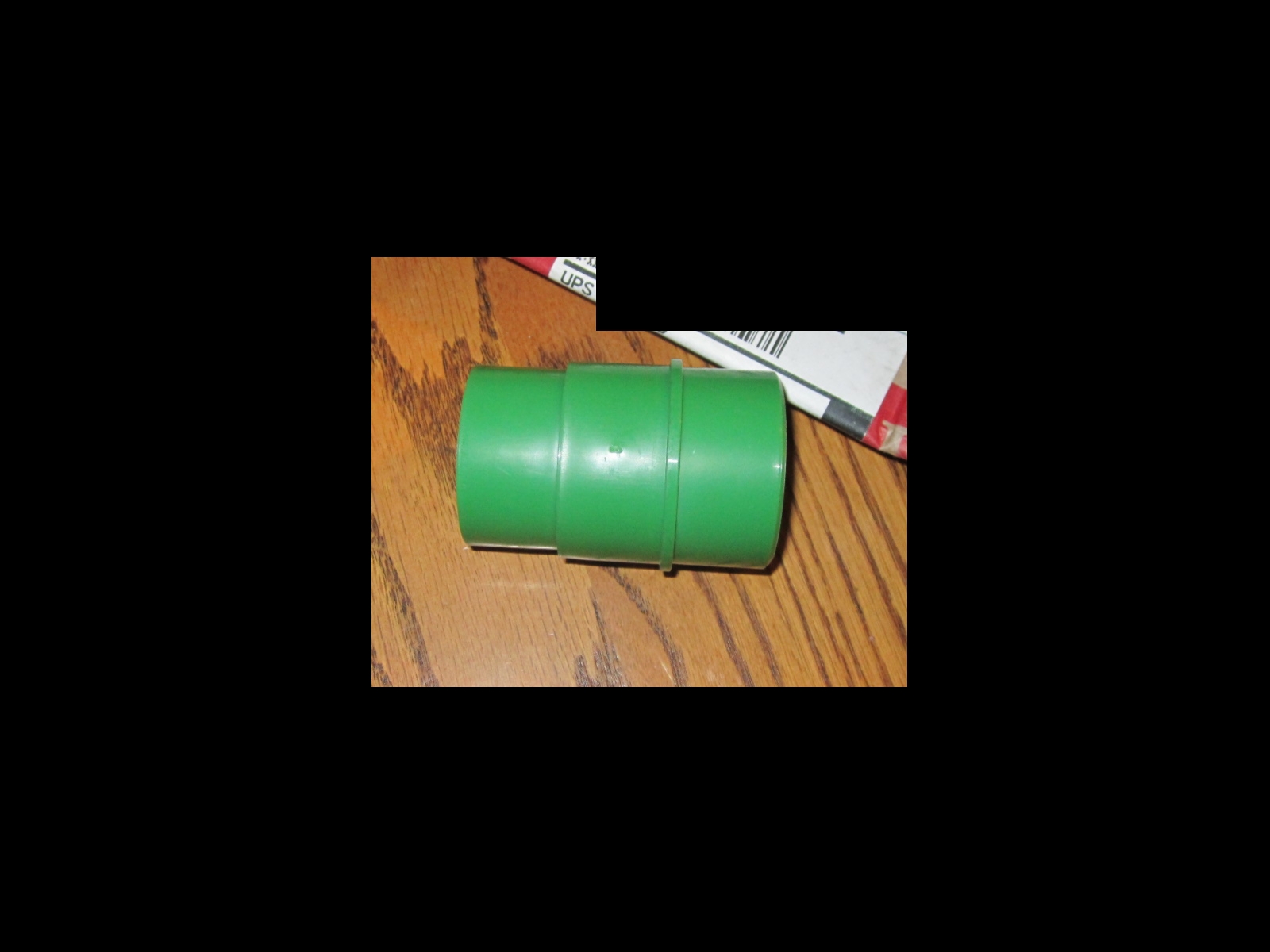

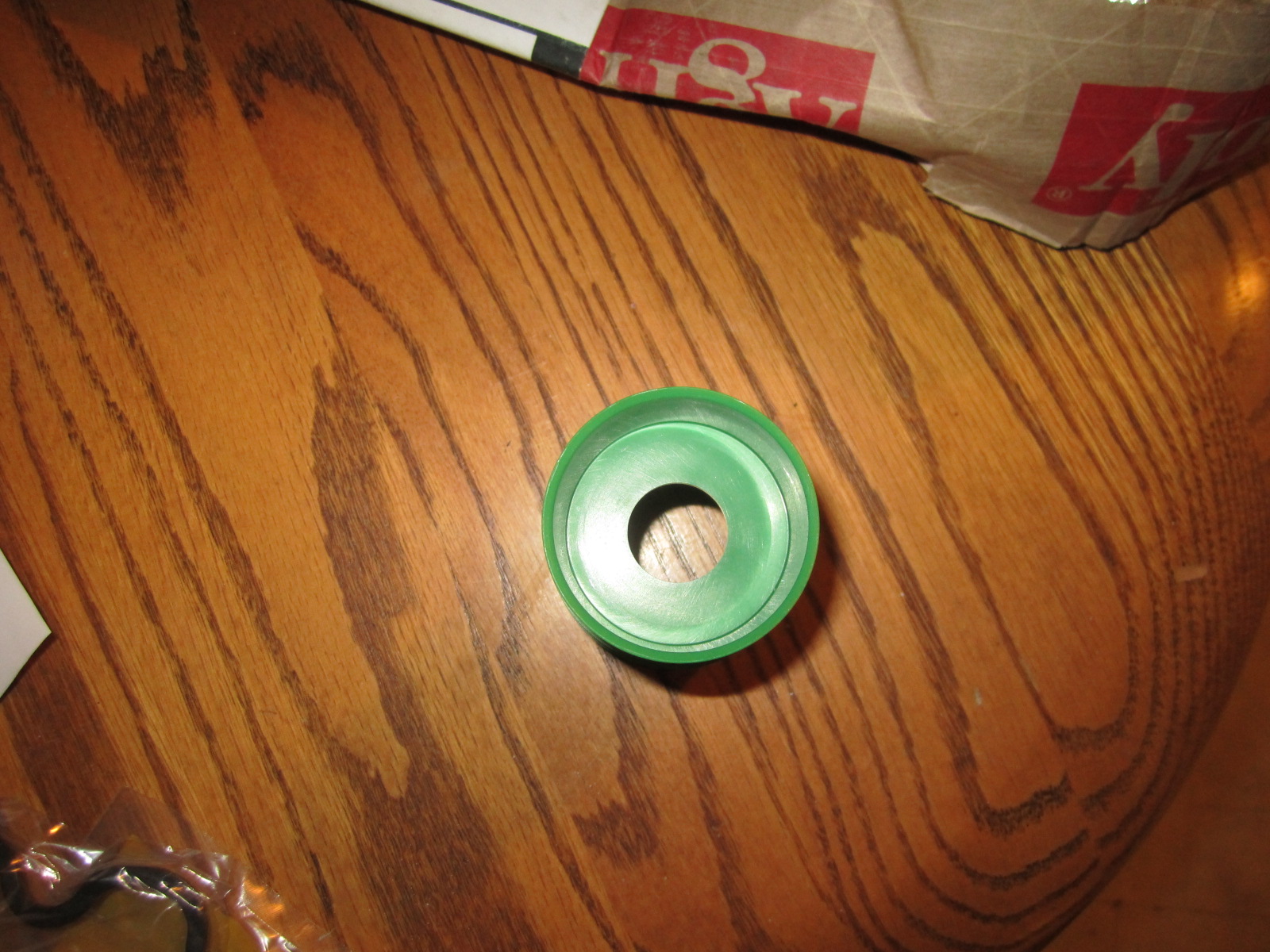

No air leaks around carb. New gaskets and made sure everything matched up. Had an old ford ranger where I swapped the electric junk carb for a nice 2barrel from an older ford and had gasket matching issues where the carb was sucking air from the base, so it's something I check now all the time. The gator only draws air from the one intake tube on the side where the restrictor is. So it's definitely to pull more vacuum. Hence leaning the carb if it's missing. JD just did a cheap fix to solve a cost effective way to manufacture. If you give it half choke the motor smooths out and picks up a little.
I know what you're talking about by diverters and hot air risers. I've only seen those on older machines and trucks. It's not the case in this one. Hopefully getting the issue fixed will resolve the cold running issues as well. I'm not going to run it till it's done right.

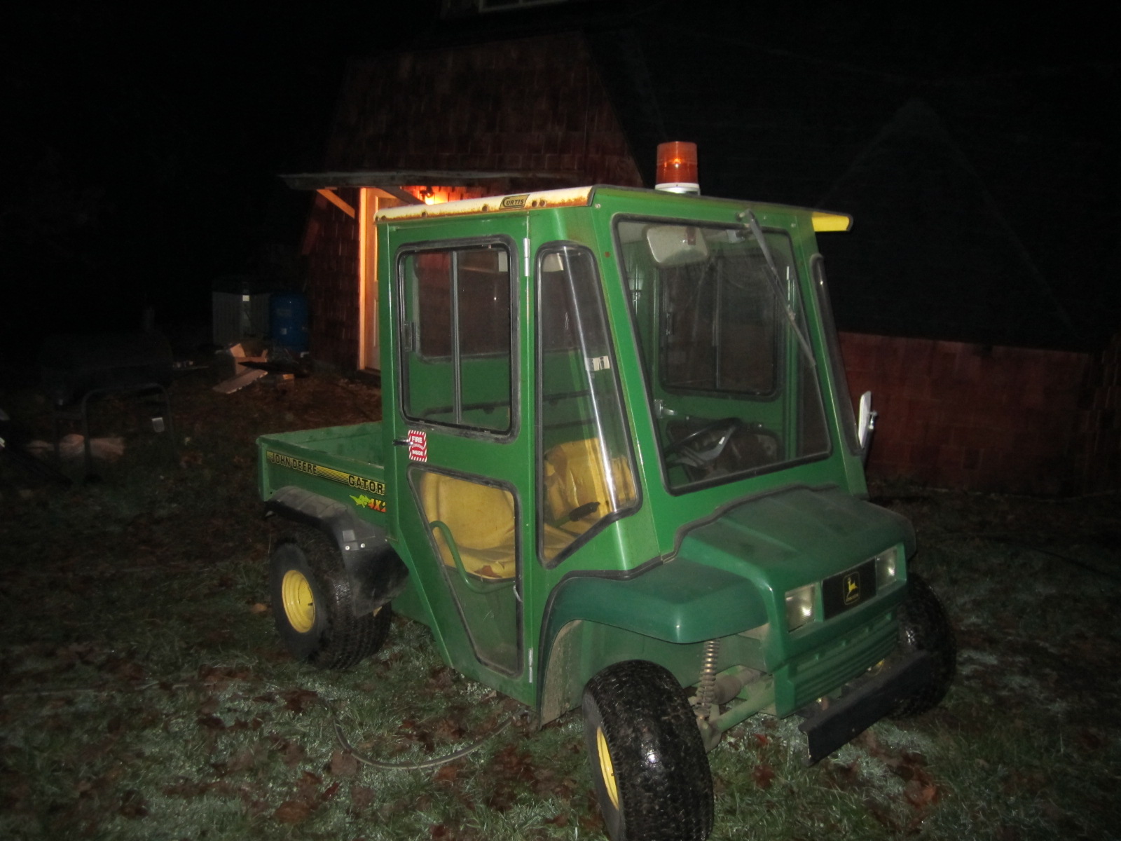

Well, it be fixed. Runs well with the restrictor in place. It has an intermittent tap somewhere in the motor, but who knows how many hours is on it. It came from an industrial application and I'm pretty sure it was used rough. I'll let it go till it dies and I'll put a much larger motor in it, 9hp isn't enough on these hills. Here's some pics of the restrictor and gator. The restrictor fits in the intake tube of the air cleaner, not the carb side of it.
