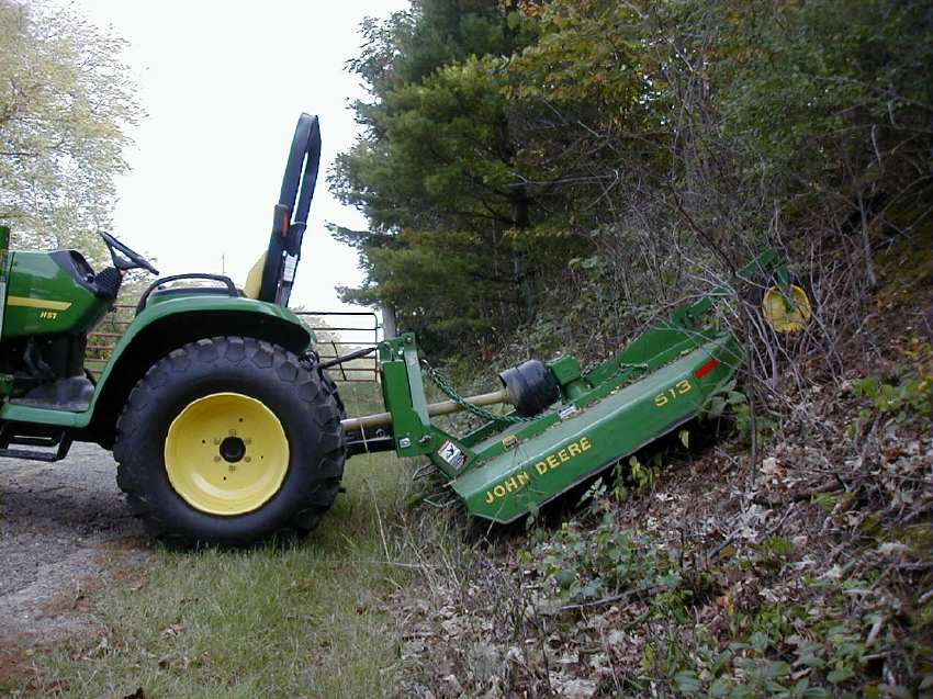

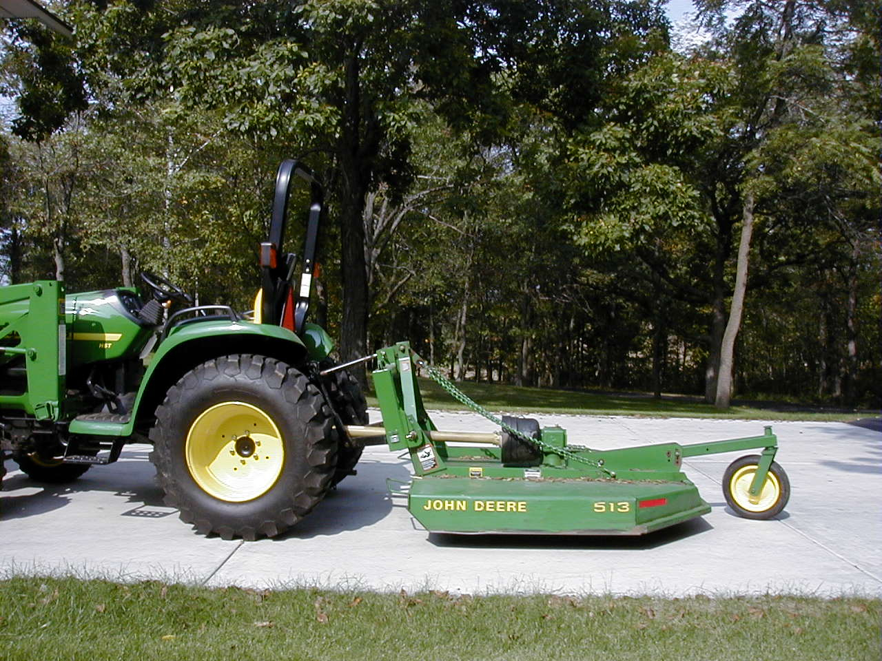

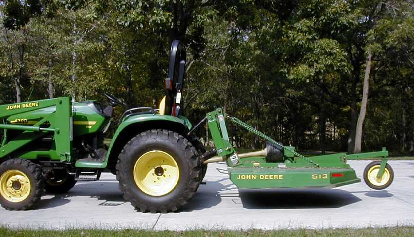

Have used the chain in place of the upper link, and also used chain in place of the flat bar stock on the brush hog.
