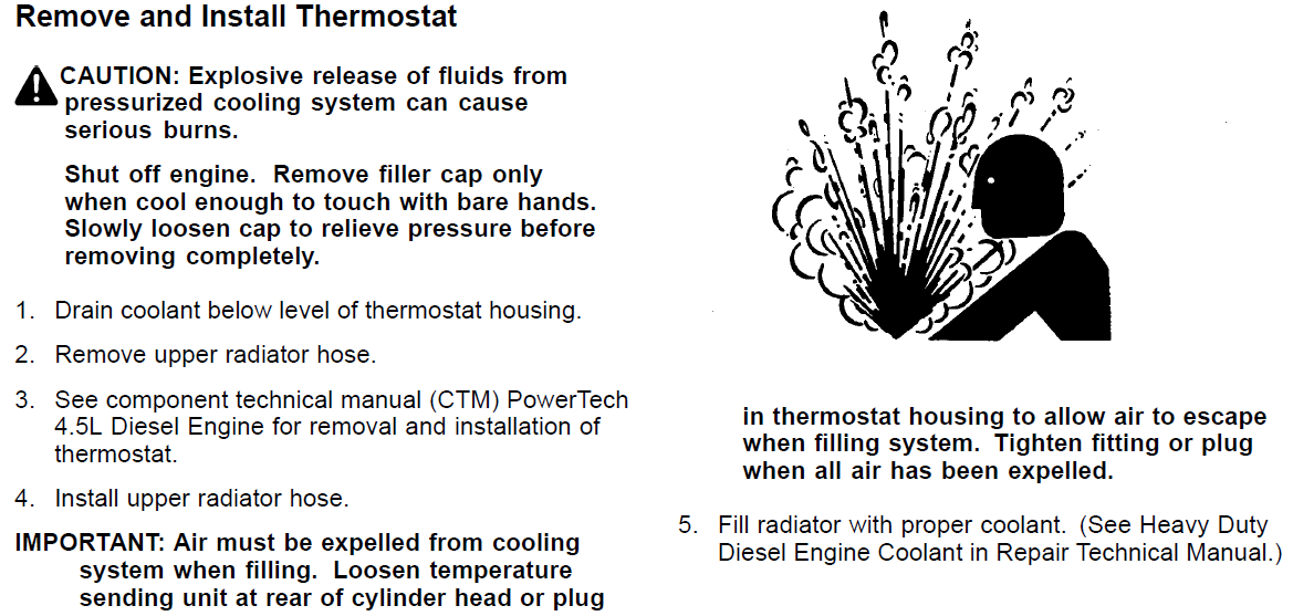

If you do not remove thermostat when filling radiator, will air in block get flushed into radiator thru thermostat when it opens? Otherwise, is there a bleed screw you can open on top of block to assure high points of air pockets get out?

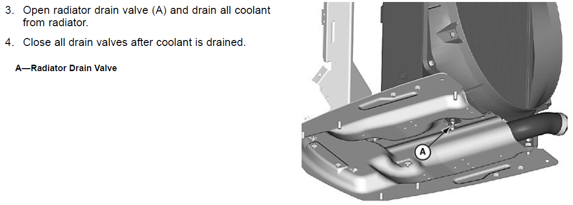

I am currently working on this. I just watched a youtube video with guy changing/flushing his JD 6### coolant..... wrong. All he did was open the radiator drain. He never opened the engine block drain, provided any fresh water circulation or anything. If he had added water while leaving the engine running a bit he might have flushed something.
Oh well....... don't take my word for it........ OMCD16510

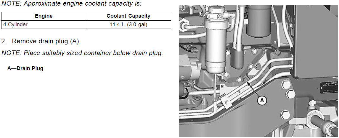

I have a JD 5425 with 4045 engine. From the pic I had a hard time locating the "oil cooling housing drain plug". From looking at some pics online it appears to be on the side of the engine below/under the oil filter. I haven't pulled the plug yet but plan on doing so and doing a proper "flush". Simply opening the radiator drain does nothing to move any debris or old fluid out of the engine (the radiator drain will not remove this unless you are running/engine and circulating water while draining). Some warm/hot circulation needs to be done and then open both drains.

This thread seemed like a good place to ask for other's experience. I have 2011-2012 5093e limited with 6400 hours..yep 6400 hrs. I used Fleetguard/Cummins Restore Plus at about 1/3 gallon for the 3 gallon cooling system as label directed. Spliced in a "T" below the cab step for back flushing "just because" and assumed municipal water pressure would be enough to flush up the supply heater core out return. While doing this I had 1) both the right side and left side engine block drains open 2) then closed the block drains and put cap on the expansion reservoir and filled cooling system from tap and operated at temp for 10 minutes. 3) Opened up the block drains again and allowed to drain as well as "T" splice /port I installed at the lowest point in the heater core supply loop. Heater control valve was wide open. Bone dry as far as I knew after the draining 4) Refilled coolant at 5 quarts concentrated coolant to 7 quarts DISTILLED water. Everything running fine . No overheating but NO HEAT. Got a coolant sample from the "T" and it cloudy with rust flakes and when tested the coolant concentration was only good to "0" degrees but should be -15F degrees. I'M THINKING THAT EVEN WITH ALL THAT FLUSHING THERE MUST HAVE BEEN CLOSE to the entire heater core, supply and return lines left full of the COOLANT system FLUSH solution.

I have a 5520, which is the same engine and the owner's manual--maybe shop manual--says to remove the thermostat when flushing or you won't get a complete flush . Maybe that has something to do with it.
When I flush mine, I do not remove the thermostat. I just drain the old coolant out, add the radiator cleaner and fill with distilled water. Then I run it for maybe a few hours of normal activities, drain the water and coolant out and run again for a couple hours with fresh distilled water to circulate everything.
Then I drain that out, fill with Deere prediluted coolant and go do something else. This is how I was trained in a shop a long time ago and that's what I will do forever. Never a problem.

I've got a 5520 shop manual if that helps. When I looked it up I felt why bother; as long as it heats up and is run hard for a while it will fully circulate. In my case I felt a good flush and thorough rinse with new distilled water would be OK as long as I gave it time to fully heat up and circulate and not a hurry up 10 minute flush where the thermostat doesn't even open.
Spend the money on distilled water and not tap water laden with the minerals you're trying to remove is my personal opinion.
