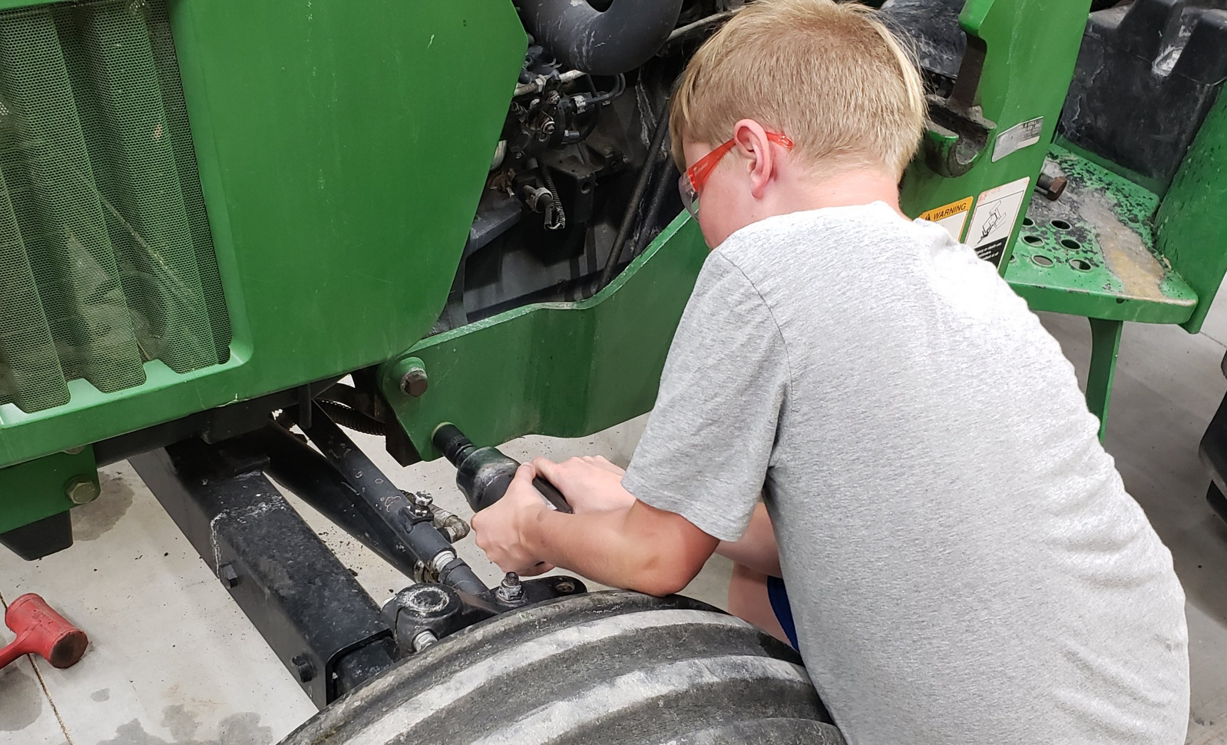

I thought I'd use a thread to chronicle my repair of my 5105. Today I got the loader off, pulled it into the shop, and got the hood off with the help of my kids. My plan is to get the bare minimum parts to make it run, so I can be assured that it will run, before getting the rest and tracking down a used hood. I've confirmed the harness is available and I've found used clusters online.
I know it's a bit of a gamble, but I'm actually looking forward to it. It will be good for my kids to help too. I was a mechanic through college and am an engineer now, so this doesn't scare me. But there is no way I'd attempt to repair the main wiring harness.
Maybe this will be a gateway to fixing up old tractors. That wouldn't bother me except storing them...

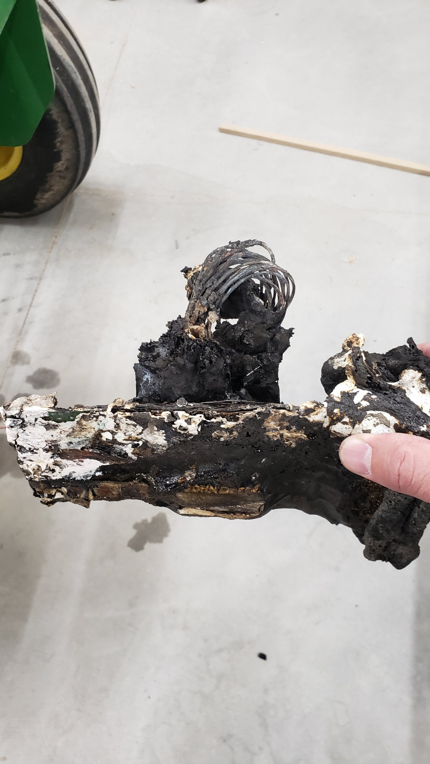

Did the tractor catch fire?
Or did the battery explode?
What are ViseGrip "C" clamps for in the second picture?
I probably would have hooked the tow strap lower, not on the front guard.
It does look like a fun, but expensive project.
/ JD 5105 Repair Thread
Yeah, it had a fire a few weeks ago. Electrical fire near the fusebox that burned through the fuel line.
The vise grips are a backup keeping the fuel from running out of the hose. I also have a bolt plugging it with some hose clamps. I haven't drained it all out yet.

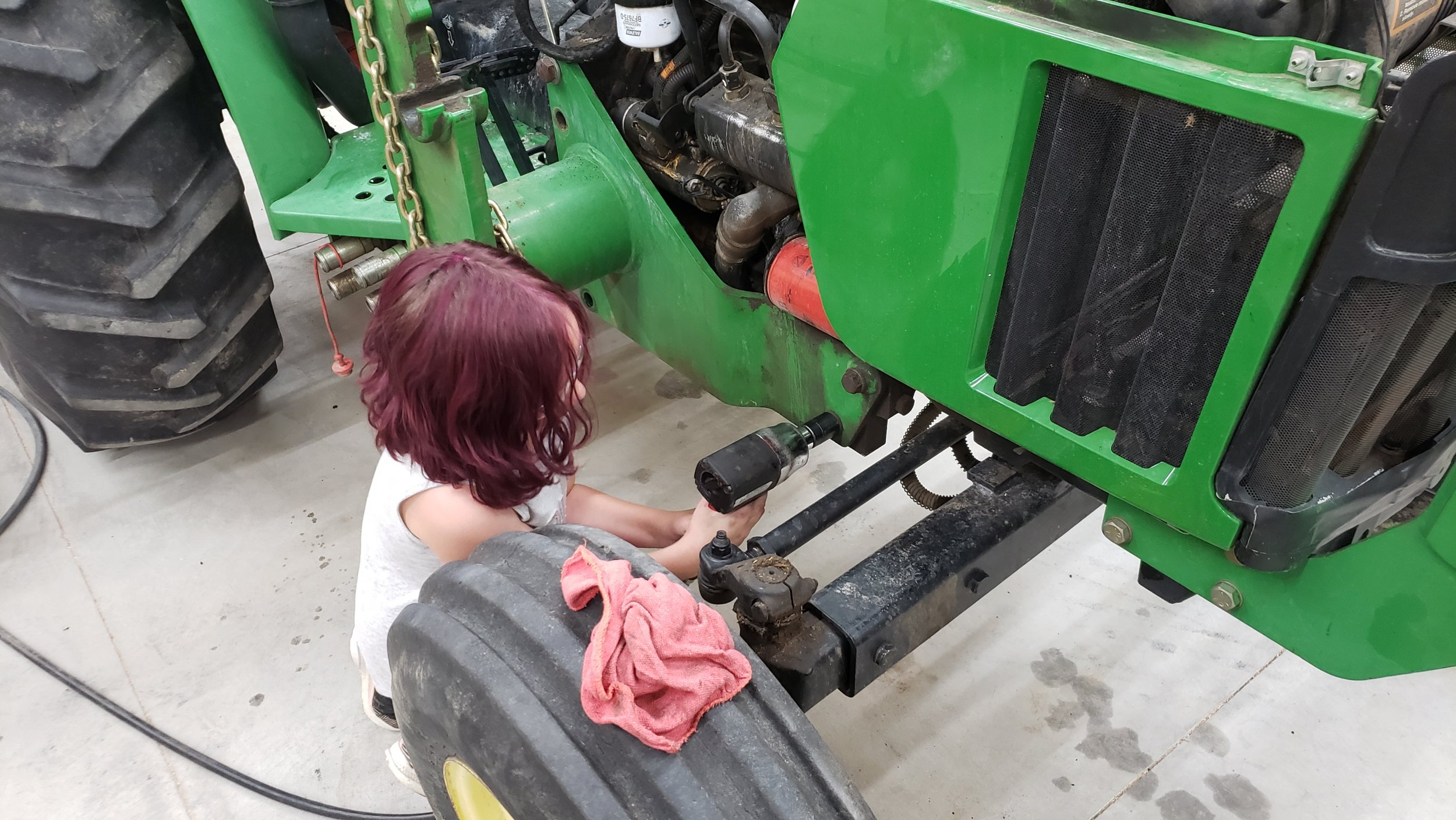

Loader brackets off and some of the mess cleaned off. No surprises so far. Time to order the first round of parts. Loader brackets are heavy in case you thought otherwise. I used an engine crane, which made it pretty easy.

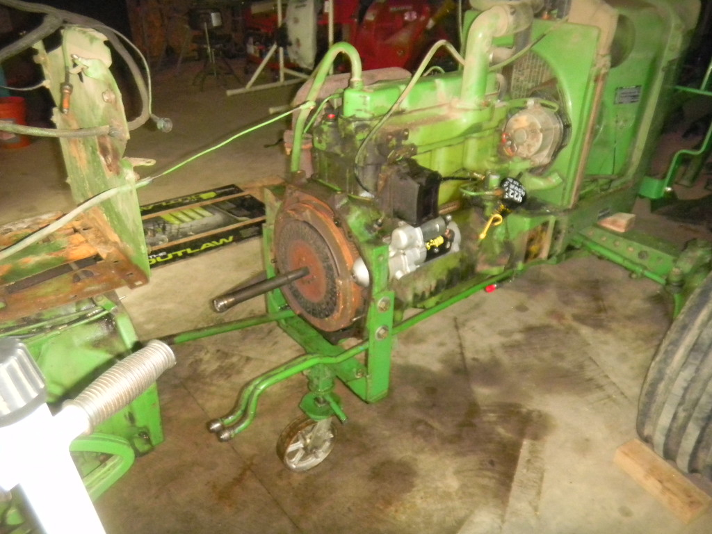

I've split my 2030 at least three times.
One of the lines to the Independent PTO (PTO clutch) broke.
Replace clutch

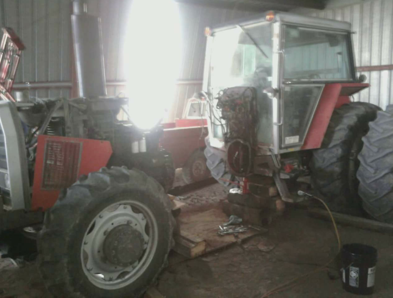

Lost all hydraulics. I thought transmission pump failed. Turned out splines that drive it in the pressure plate stripped. First, I split clutch housing to transmission case. Then had to reassemble and split engine to clutch housing to replace the pressure plate. Local JD dealer said they had seen that before, but rare.
Splitting stand is home made. I block the rear and move the front 1/2
#13
We did that on the Massey as well. The front half is actually nearly balanced with the suitcase weights. We locked the wheels so it wouldn't try to fold with the steering and just used a floorjack and a couple of steel rims welded together to lift the engine side. Obviously that doesn't work for all applications, but did for us.
