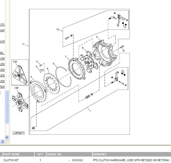

OK... current untried ideas include
  1. tractor has PTO clutch internal to tractor case that may be slipping (I didn't know this, thought it was a hard hookup)
  2. PTO engage linkage may be disengaging without positive operator action, check linkages
  3. try a different PTO device, shredder/post hole digger..I have these and can transport to their place.
  4. remove plastic shrouds to see actual PTO and its RPM's while cutting and when cutting stops.
Will work thru these options as time permits... likely not until this weekend.

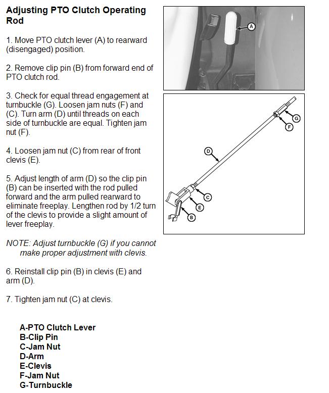

Sounds like the PTO slip clutch needs adjusting.
Myself, I would remove any chains holding the plastic PTO covers from turning. Let them spin with the PTO shaft and observe if the PTO shaft stops spinning when the rotary cutter stops cutting.
I agree with beenthere, very easy to unhook the small dog chains that prevent the plastic shields from spinning to monitor the pto shaft's rotation. No need to remove the shields. If the pto shaft is turning it would have to be the slip clutch needs adjustment. If the pto shaft starts to slow down then look at the tractor pto clutch adjustment.

Clutch on top of blades was NOT even barely warm...no slipping at all of this clutch. Seems that several folks think there is a separate PTO clutch inside the tractor case...OK... I'll investigate that

What if the mower is binding causing the tractor PTO shaft to bind, then causing the tractor PTO driveline clutch to slip? Lots of 3pt implement slip clutches are not maintained properly and they don't work. This would cause the tractors driveline clutch to slip.
Having a known healthy other 3pt implement hooked up to the tractor would eliminate one of the possibilities.
One thing worth considering is the OP stated the mower mows for X feet, then quits. Something could be heating up, then slipping or binding.

Beenthere, you ARE a SUPERSTAR:thumbsup::thumbsup::thumbsup: Many thanks!!
I didn't know there was a clutch there....you've not only educated me, but given me the ability to address the problem/adjust the clutch with confidence without breaking into the case.... will do.... Isn't the internet wonderful!!
And, the proper manual is on the net... it doesn't get any better than that!!
Now, all I gotta do is make a visit to my friend and see if I can tune things up. The problem simply HAS to be related to the tractor's PTO clutch....
