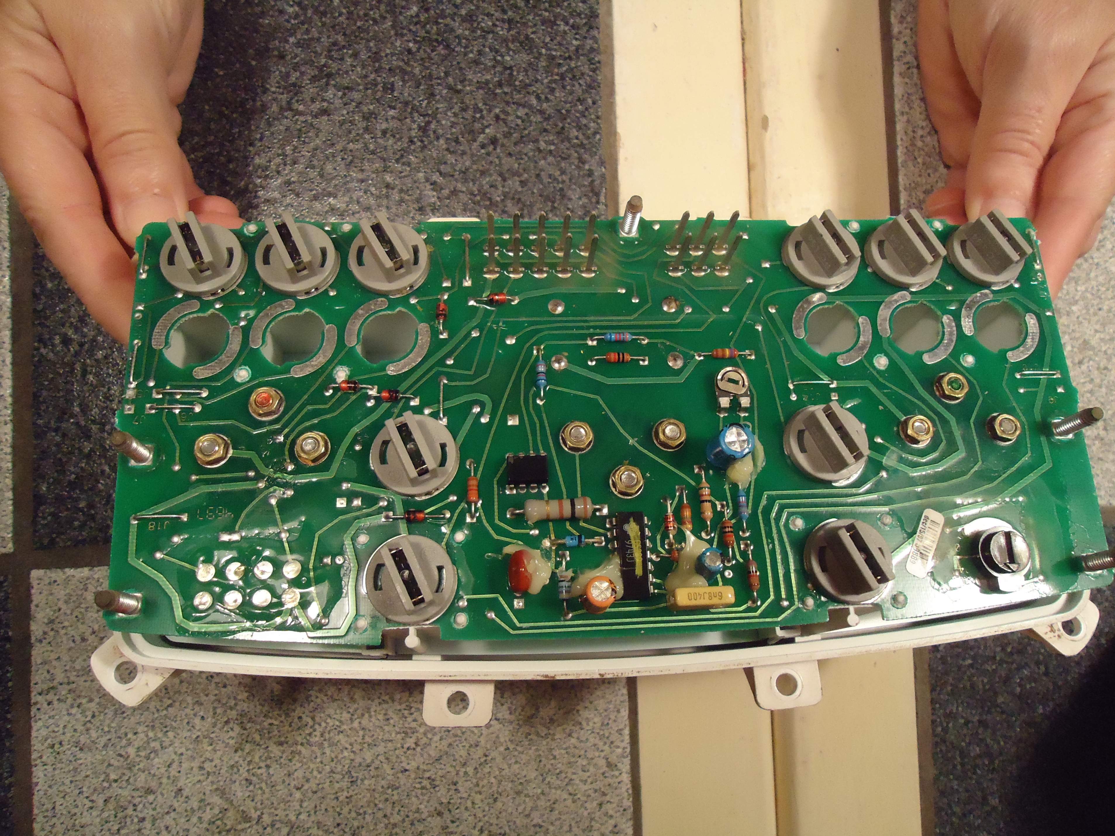

After disconnecting the negative cable, yes you will need to remove the 3 green body parts. You can unplug the light switch and turn signals. I just removed the knobs and took off the screws. You will need to remove yellow throttle knob, it is just pushed on. I did have to fight with mine the first time. Then push the throttle lever totally forward. Look and see how that rubber boot above the steering wheel is on. At least for me that boot was the toughest piece to put back on. Of course the 2 connectors and play with it to get over the throttle lever.
Then remove the 8 screws and the nuts (8mm) and open up the cluster. The same cluster is used for the 4 cylinder 5410, the little switch inside tells the tachometer if it is a 3 or 4 cylinder engine, be gentle with it if you move it. Taking the 10 nuts off the (fuel/tach/temp gauge) and you can remove the circuit board. I would look for a bad capacitor. If you do not know what a bad cap looks like, you can search the web for examples.
I included a picture of what the back of the circuit board looks like and the pattern for putting the screws back in, to avoid breaking the glass.
On putting back together, make sure the glass is seated down all the way around. Also do not forget to move the throttle back. I think I lost 2 years, when I started it at full throttle.

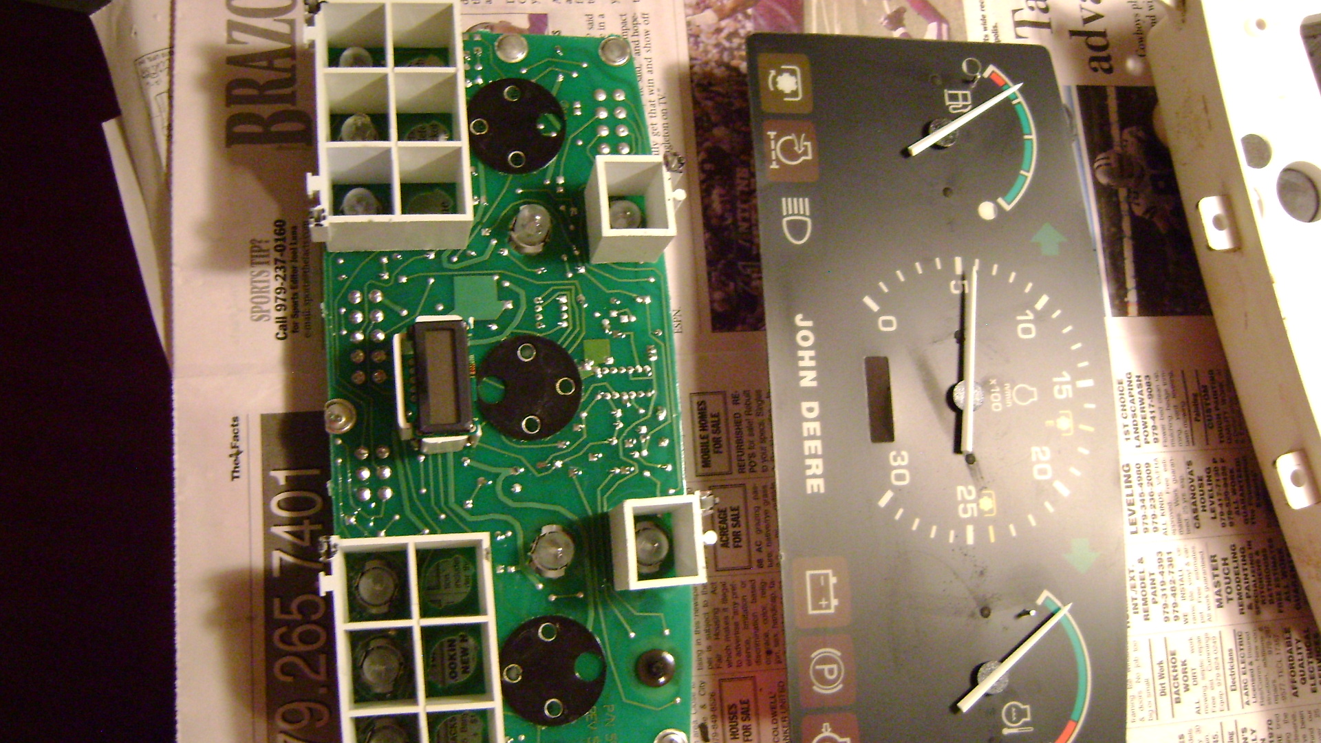

all right it took a while before i had time, but i took the circuit board out as you suggested.
attached a picture of the the board and the display
as you see, the gauges did not go to zero, also and there is no sign of a capacitor or other connected which is burned out.
not sure about the tach meter, after a while it started to go trough zero. then when i moved it, it stayed at 5 for a while, when i put it back together it ended up on zero.
when it was put back together the fuel gauge was at zero and the temp at end of red bar.
Any suggestions?
can i buy separate gauges to change out?

I do not think you will have much luck finding replacement gauges, plus they are riveted to the face plate. It looks like the bulbs are bad? I looked up a number of temp/fuel gauges on the web and they all work the same. Having 3 poles, plus, negative and sending unit. At this point I think you need someone a little smarter than me. I would suggest going to the following site, showing them your pictures, describing your problem and what test you have performed.
You might consider writing. I am having a problem with the temp and fuel gauge on my tractor. When the engine is off and the battery is disconnected the gauges do not return to cold/empty. All grounds/connections are clean and fuses good. When I disconnect the 2 leads at the fuel sender, with battery connected and ignition on, and touch the leads together the needle goes to full. When just disconnected leads the needle is at ?. The gauges are in a container, so I cannot see inside. Any suggestions why the needles are not returning to cold/empty?
