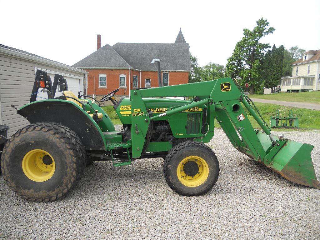

OK...Here is a picture of the 5310 I'm planning on purchasing.... I know I could pay 10 or 12 thousand more and get a new one but I'm going to be happy just to finally have a tractor of my own and can always upgrade down the road!

Looks nice. The seat looks in good shape that tells me it has either been kept inside, covered or replaced. The 540 loader is what I have it has the parking stands often those are missing. I have not seen a 5X10 tractor with type of exhaust pipe, not that there is anything wrong with it. Overall the paint looks good Rust-Oleum makes some nice JD green paint. You will be surprised some wax and an electric buffer and that hood and fenders will shine right up. Do not know what you plan to use it for those turf tires may not be good in the mud. WD-40 will take that Martin sticker off. Manual URL on the loader included. At least my tractor almost everything is metric.
Did you check the clutch? How does it start?
Unless you know the person, I would replace all the filters and fluids. If you do the hydraulic fluid replace the o-rings and make sure you have a wrench to fit the filter. You will not get if off putting a screw driver through it. Luckily I learned that from someone elses experience. Also fill the fuel filter before putting it on.
I am guessing you will not be doing any haying, but that fork lift can be converted to a hay spear.
Just in case you do not know this. You have to be stopped to shift gears with collarshift. If you plan to replace the type of tires the rims need to be replaced as well. You must be STOPPED to put it in park.
Let us know what you decide.
http://manuals.deere.com/omview/OMW44993_19/
/ JD 5310 #9
Definitely check the clutch. In addition to checking the existing free play at the pedal, there is an adjustment turnbuckle under the metal tunnel between the footboards. Check to see if there is any more adjustment left.
The collar shift trans is not the best option for regular loader use. It is very clutch intensive when your loading and changing directions frequently. Plus you have to stop completely for gear and direction changes.
