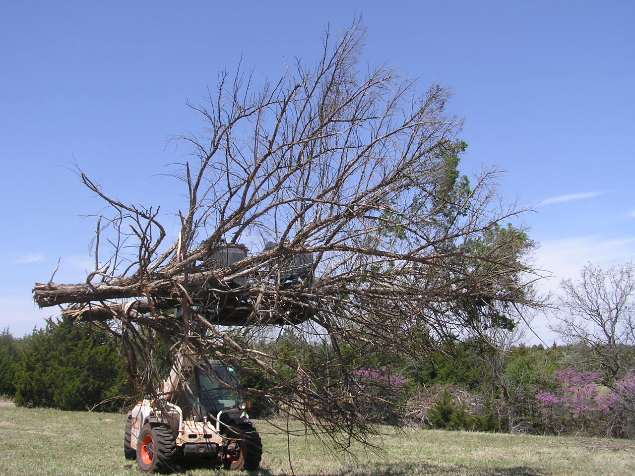

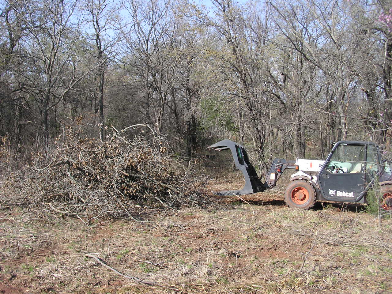

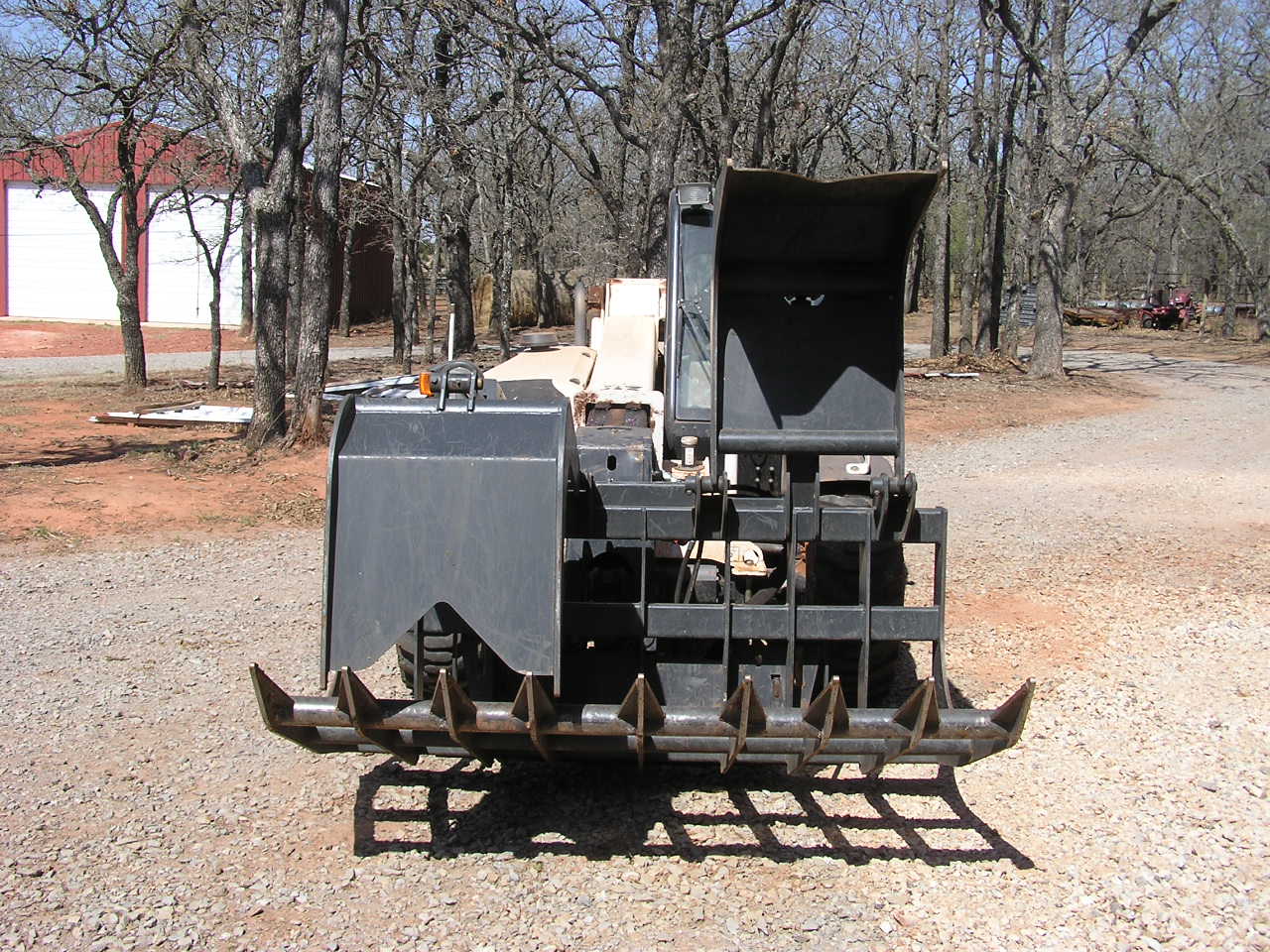

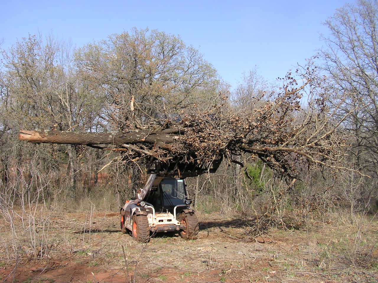

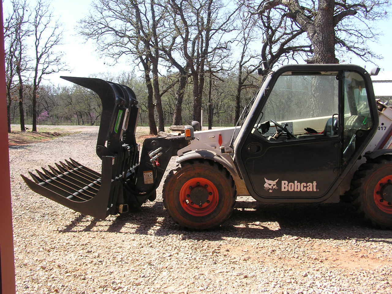

I can recommend the Monster Grapple from: Loflin Fabrication
6' wide
A dead oak tree and brush piled on it.
A couple of big cedars.

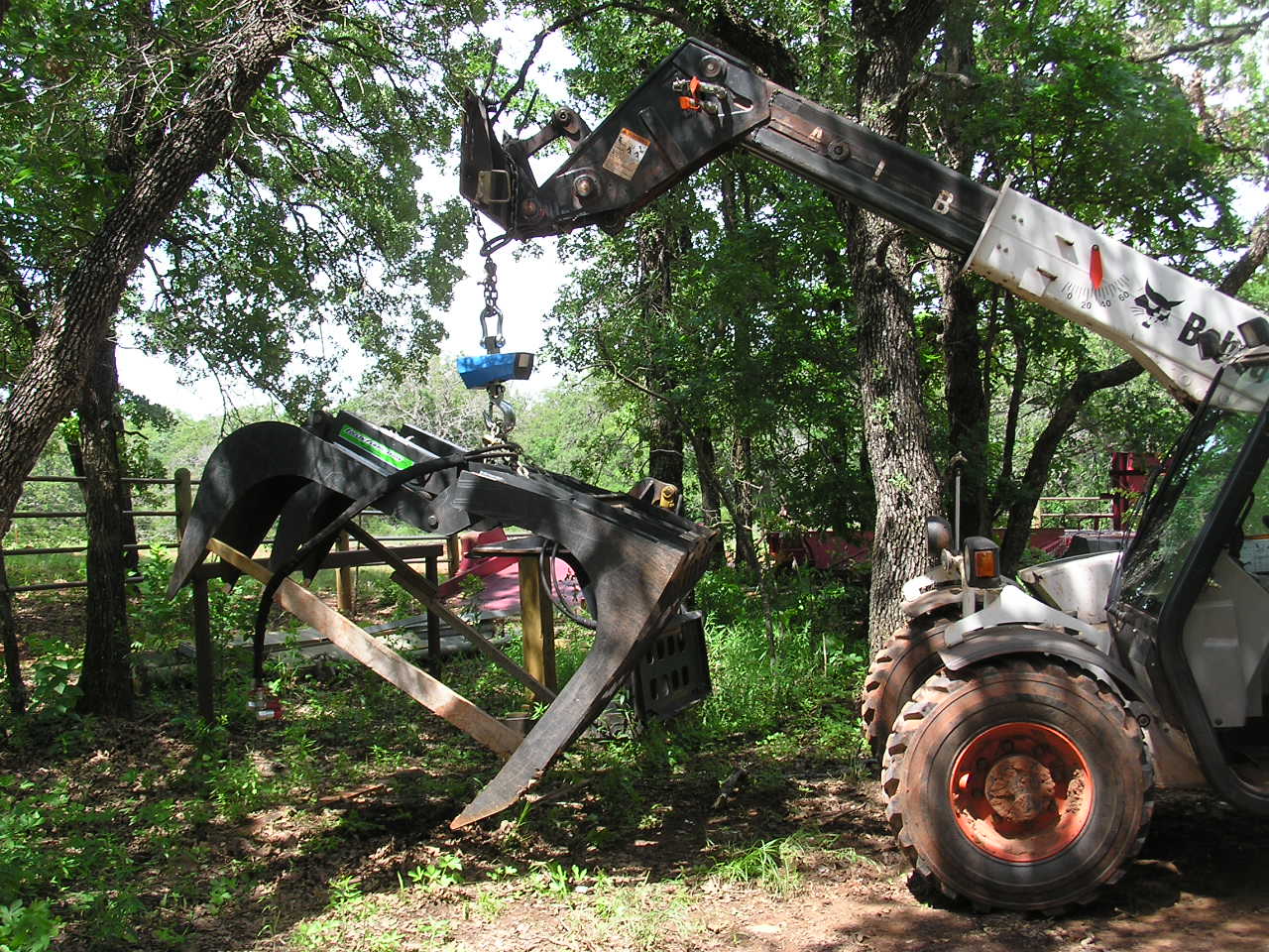

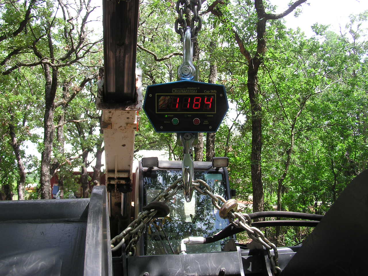

I think you posted the weight in an older thread. The site does not list it.
My crane scale shows 1,184 pounds, with the two 2x4 props that keep the lids up while unhooked.
