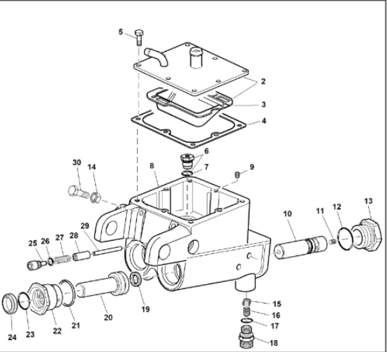

OK. I really learned something about my tractor tonight.
There are what look like grease nipples around the rockshaft mounted on brackets that I thought were grease nipples and have plastic caps. THEY are the brake bleeder screws.
Went on JD FREE parts lookup. Some sites have the same picture but is cloudy and want you to subscribe!
I guess the question now, is whether the tractor is supposed to be running. I would guess that you must seperate your brakes and do them one at a time.
   / JD 6200 brakes not working after hydraulic line broke #12
Older JD tractors brake valves were filled via trans pump BUT I don't understand exactly how 6200 hyd system fills brake valve reservoir but I'm confident hyd system does that task. I wonder if pan(key 3) is actually a "filter"?. If similar to older JD tractors engine should be idling when bleeding brakes. Have you trying pulling up on pedals while engine is running? I agree brake valve plungers need to extend from valve housing in order to successfully bleed the air from brake system.
