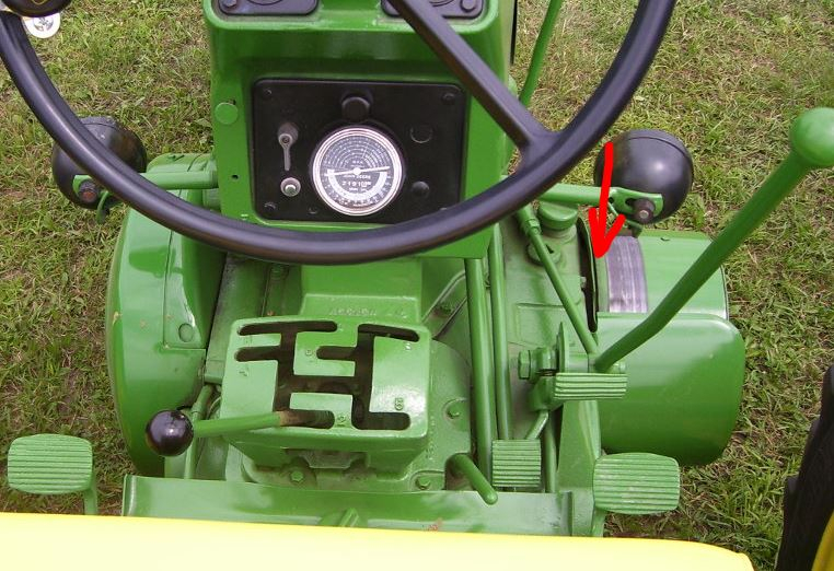

One other question on the subject of the clutch/pulley: Have any of you ever seen oil leak from between the pulley and the "tractor side" and the pulley? In the past (prior to my oil spill which didn't involve the pulley), I've noticed some oil getting flung up onto my right fender. It appeared it was coming from that narrow little gap between the pulley and the "guard" plate the pulley run alongside (see pics for clarification). This has only happened after the tractor has run for quite a while. Once I was driving it some distance on roads. That time I noticed when I shut it down at my destination that the pulley was hot to the touch. More recently I thought I noticed it again after running the brush hog with it for a while. Any thoughts on that?

May have been hot to the touch because the clutch was slipping. And if that hot, may have caused oil/grease to move. See how it does after adjusting the clutch. Would like to hear back on the results.

That makes sense. What has me scratching my head a bit is this: Around this same time, the clutch lever was really tough to engage/disengage. I could get it in and out, but just barely. It seemed to get progressively more difficult over the course of a few months.
Not sure what might cause that symptom. I had the pin in the pivot point of the clutch handle replaced and put in a shim to tighten up the handle and the tractor was sitting outside most of the summer following that. I wondered if maybe some rust forming inside that joint might not make the handle tough to operate, but didn't think it would make it as tough as it was to engage/disengage.
