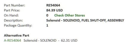

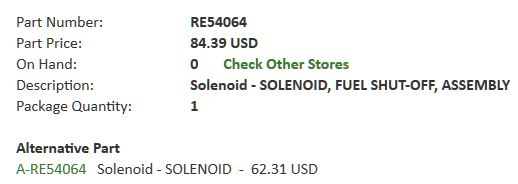

Parts catalog states solenoid must be "energized to run" and it could be shorting out.
