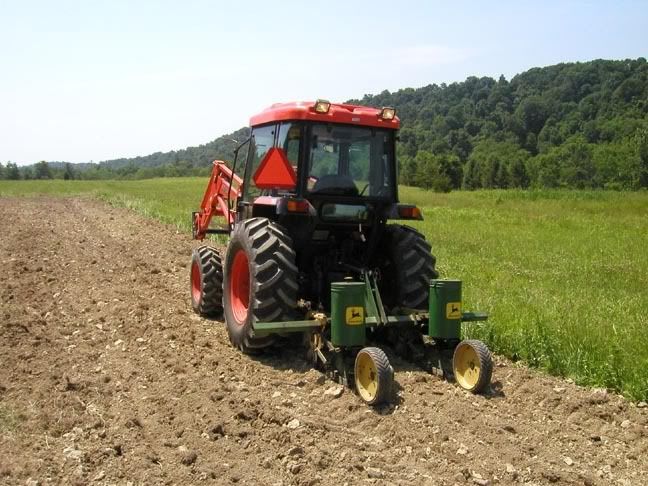

My biggest problem to date has been getting the corn covered properly. I have adjusted the toplink about every way possible and that doesn't seem to make much difference. As you can see from the pic my seed bed is not real smooth but I have not been able to afford a heavy duty harrow yet. My 71 is also missing the gauge wheel and so maybe that is making a difference. We did have a good crop last year so overall I am pleased with the planter.
