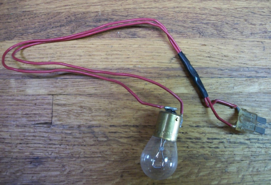

Also, to find a potential bare wire, put a 12v bulb in the place of the fuse that blows.. then when moving wires around the short will light up the bulb indicating you have found the potential bare wire. Saves on replacement fuses too.
What I concocted up that helped me find a bare wire above the upholstered headliner in a previous Citation. Was a nightmare to find it, but when the "light came on" we knew where the short was.
