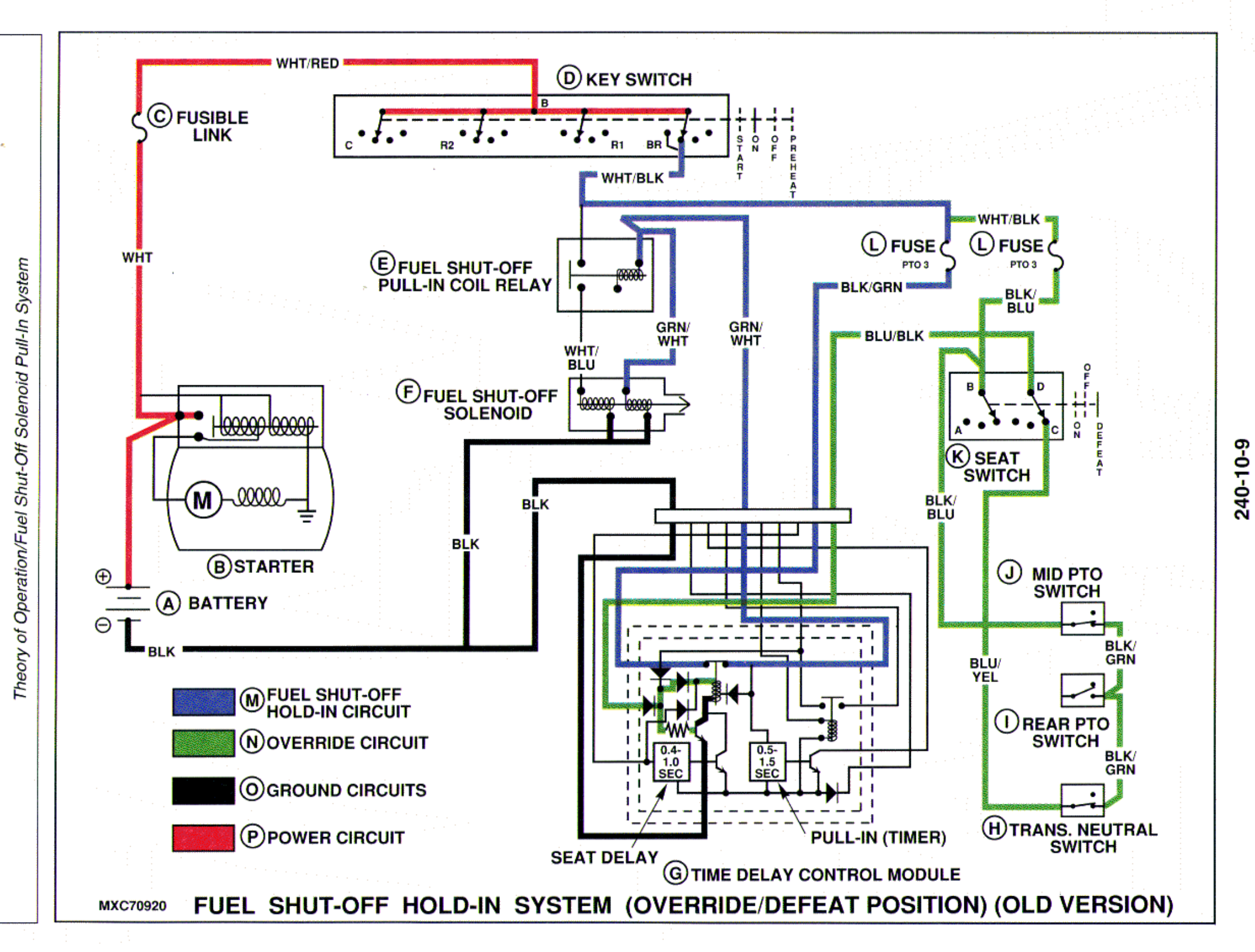

We recently replaced the solenoid thinking it would fix the problem. It didn't. It will close for a moment with the key but once we go to start is opens and won't start. Wires don't look too bad, all relays click, I do have a lose fuse in the fuse box but I'm wondering if it could be the key switch? Anything I should check before I buy another part?

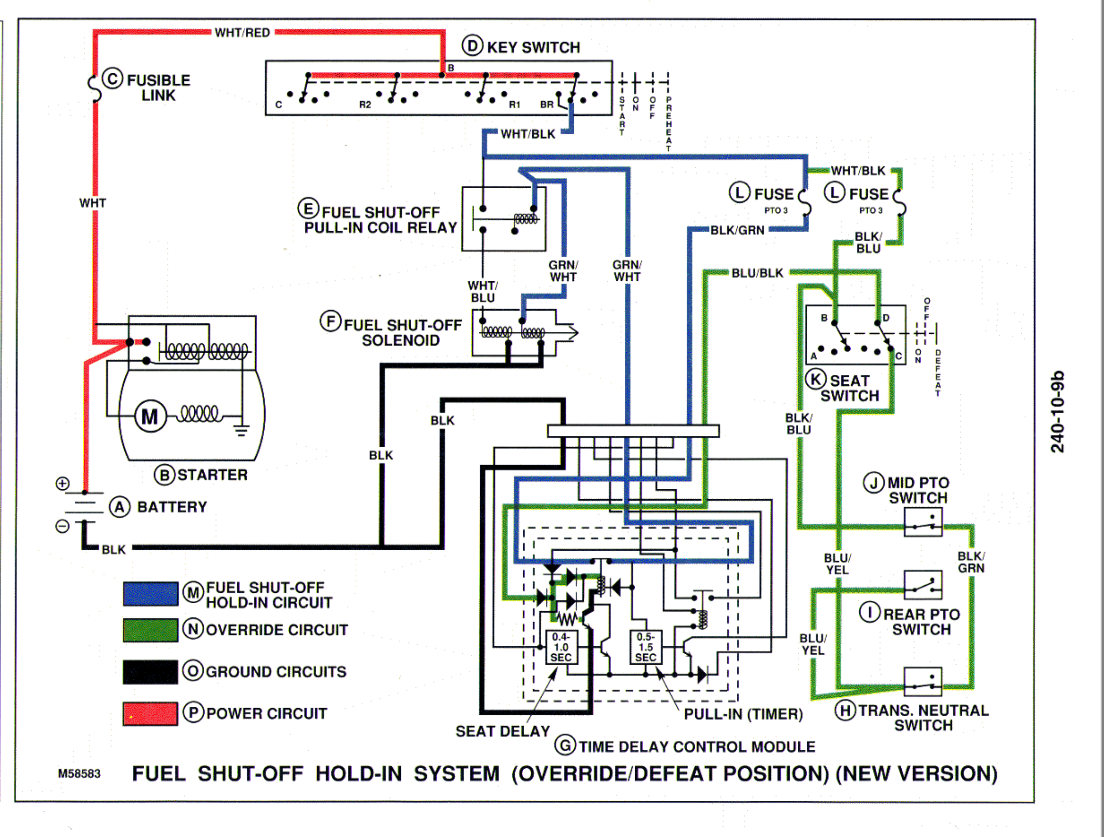

lots of things are in the fuel solenoid system, as you can see in these two drawings (old version stops at tractor serial number 105,92)
I have a PDF of the tech manual that you are welcome to before you keep throwing money at it!, if wanted, send me your email and it's on the way.
I'll message you my email

It's a pull in solenoid. For some reason power supply fails when starting is not holding it in when running. If I wire the solenoid open tractor starts.

Then it must have a low voltage control relay that has done went bad. Your low strength ignition signal goes to a relay that has the high strength. Your ignition signal makes the relay close and pull solenoid open. So, something has a bad connection or something has gotten weak in that circuit. I have seen those get burn spots inside that will cause a poor function condition. If they are big enough I will take apart and fix. The big 300 to 400 dollar ones I do take apart, so far, fixed every one of them. Trac hoes and dozers have big bell relays. But, yours could be too, I don't know.

look in your manual for testing the "time delay control module" part of it's job is to hold the solienoid open as the key switch moves from "start" to "run" kinda sounds like yours isn't making the changeover
