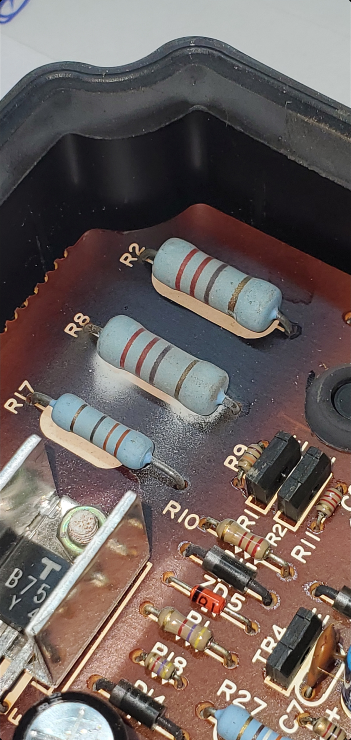

Then it must have a low voltage control relay that has done went bad. Your low strength ignition signal goes to a relay that has the high strength. Your ignition signal makes the relay close and pull solenoid open. So, something has a bad connection or something has gotten weak in that circuit. I have seen those get burn spots inside that will cause a poor function condition. If they are big enough I will take apart and fix. The big 300 to 400 dollar ones I do take apart, so far, fixed every one of them. Trac hoes and dozers have big bell relays. But, yours could be too, I don't know.

That circuit board looks to be all good. Does your pull on solenoid have three wires going to it?

Okay, one activates, one holds it on, one is neutral/ground. So if you un plug and check the tractor side, you should get ignition voltage at START. You can check RUN position also to find your problem. That should allow you to find which leg your problem is on. I just had same situation on a 150,000 watt generator at a farm. It works the same way. Has a circuit board too.
The circuit board looks to have burned on the blue bubble doodads at the top right which I believe control the seat switch.
