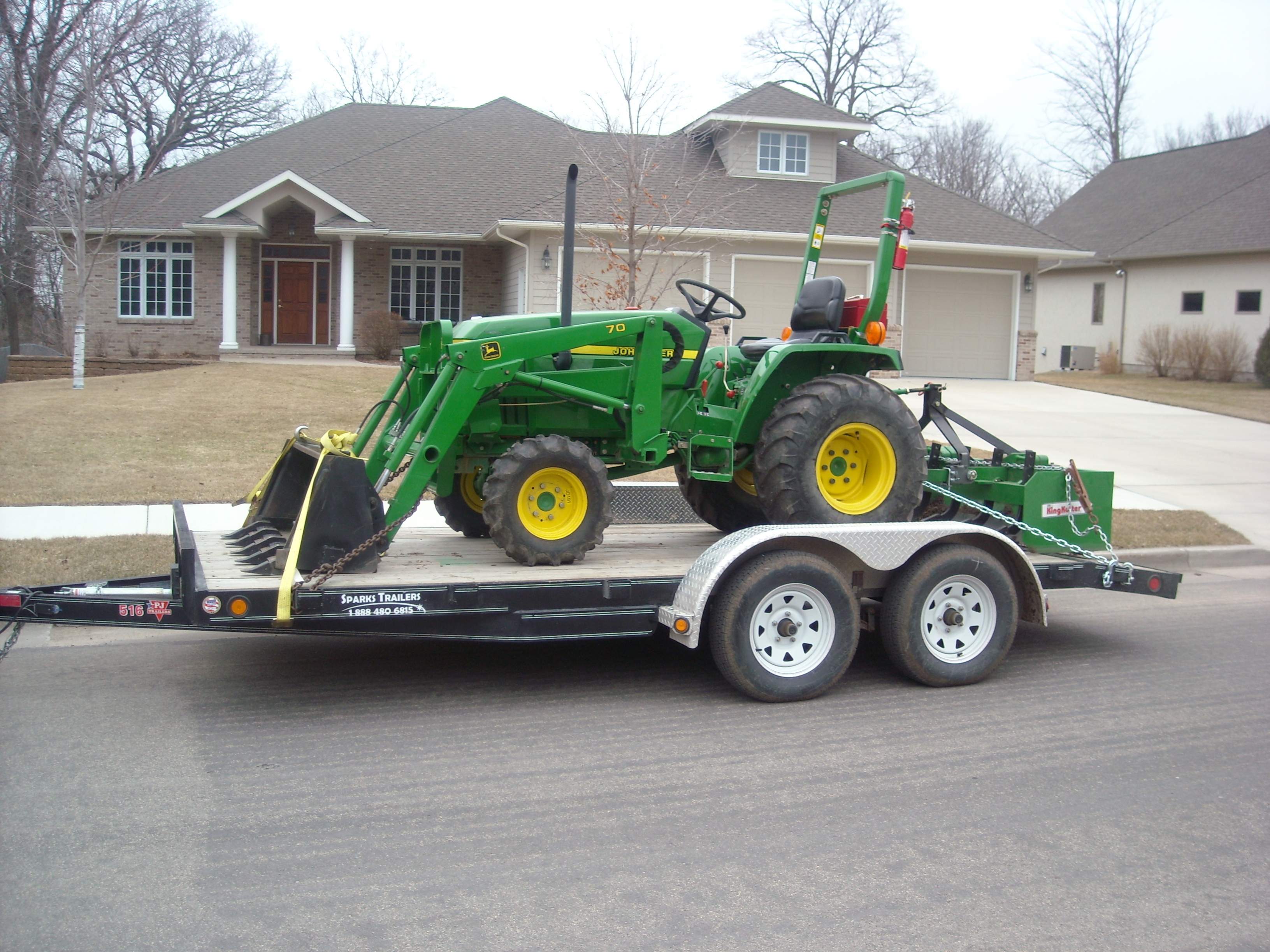

I was just loading my tractor for it's trip "up north" to my deer land....where I hope it lives a long life. :D Anyway....here is a pic of the tractor with loader and box blade on the 16 foot PJ trailer. I have about 1 foot to spare in deck length but it balances well. I believe I could put it on with my 5' KK cutter...but it would hang off the back about 2 feet. So...like others have said....an 18 is better if you have the choice and the vehicle to pull it. For me, this trailer will work out just fine, and its a bit more nimble to get around with my little rig. Hmmm...I just noticed that front chain should be moved to the back of the stake pocket.
