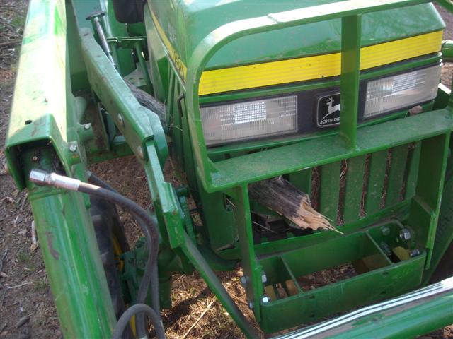

I had the same model 790 and 70 loader combination as you do. (older 30 HP engine too).
I loaded the rear tires and always carried an implement on the back for loader work......and this combo worked like a champion. I had shimmed the hydraulics too.....and cannot remember a rear wheel ever coming off the ground.
Keep in mind the tractor hydraulics do not have the heaviest capacities. None the less....this unit is nicely balanced and will pick up most everything you want to do with it.
You have a front weight attachement on your tractor. That is an optional bracket. When I bought my tractor I did not have a grill gaurd either.....nor the aforementioned bracket. I bought the bracket and made a grill gaurd to attache to this bracket. Worked out nicely.
Here is a pic.....and I'll see if I can find the thread if you cannot find it here via a search on TBN. (try "grille gaurd" in the custom area?)
Note the second pic.....as a result of that incident I put stair grating into the grille guard to eliminate future occurrences. Operating in timber is rough on things. I see your hydraulic lines have had an incident or two also. Beware.....branches will get 'em. Don't ask me how I know. ;)
OH....keep in mind that the gaurd needs to be carefully placed in order to get your hood open and needs to tilt to get access to your battery (if made similar to mine).

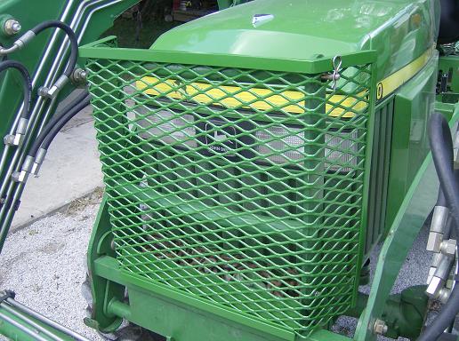

My 2004 790 has the "two-pipe" grille guard, I wanted something a little more 'protective', so I made this from some 1/2" angle iron & a piece of expanded metal. ~~ grnspot
