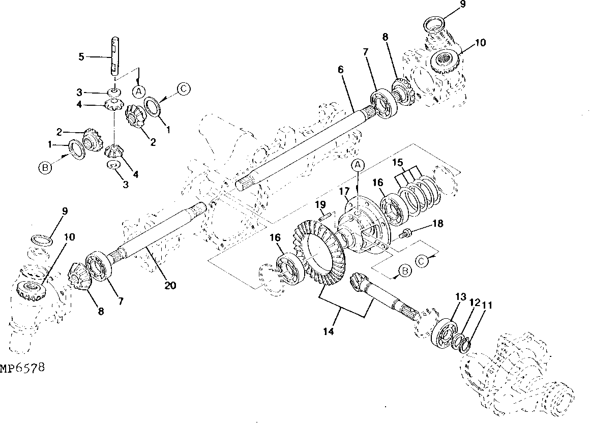

I have a problem with my 790 that I am hoping maybe someone could help at least point me in the right direction. I have been doing a lot of digging with the bucket in loose sand so I have kept it in 4wd. Yesterday I took it out of 4wd and there was a clunking noise every few feet from the front axle. When I put it back in 4wd the clunking goes away and the 4wd works. Anyone have any ideas what it could be? Or does anyone have a drawing of the front axle I could use if I decided to take it a part. Thanks

The diagram for the axle is available for free if you register at www.jdparts.com
Not sure what the clunking is-but I would not not it go to long before you figure it out!

Thanks for the help! I really hope it is not the front gears but I fear it is. The only odd thing is it only makes the noise in 2wd. I have registered on JDparts.com and I have looked all over. Where do I find the drawings? Thanks again.

On the left side of the page click on John Deere Parts Catalog, just below Start Searching Here!.

The 790's front axle is pretty strong but it is designed to be strongest when pulling in a forward direction. Pulling in reverse reveals it's limitations.
There were a few posts concerning front axle gears failure on TBN about 3-5 years ago. Seemed like a real rash of them for a while.
If berkompt has been doing heavy pulling in reverse gear, he may have broken a tooth off the spur gears in the front axle.
However, before pulling the axle, have someone observe the tractor (as close as possible) while operating in 1st gear low and reverse low. This is to try to determine exactly where the clunking noise is coming from. The tractor will be moving about 1 MPH.

I was actually going in reverse up a very steep grade with full bucket before the noise started happening. The thing I can't figure out is it only makes the clunk going forward and in 2wd. If it did break a spur gear is it hard to fix? I have worked on many cars before. Is it fairly straight forward? Will I need any special tools or press or anything? Thanks again for all the help! Travis

Well I jacked it up last night and I noticed that turning the front wheels by hand the left side one would stop at a certain point. So took it all apart and the lower pinion gear and the large gear the connects directly to the wheel were missing teeth. Since they are really pressed on I had to take it to the dealer to have them change the gears out for me. Thanks for all the help!
