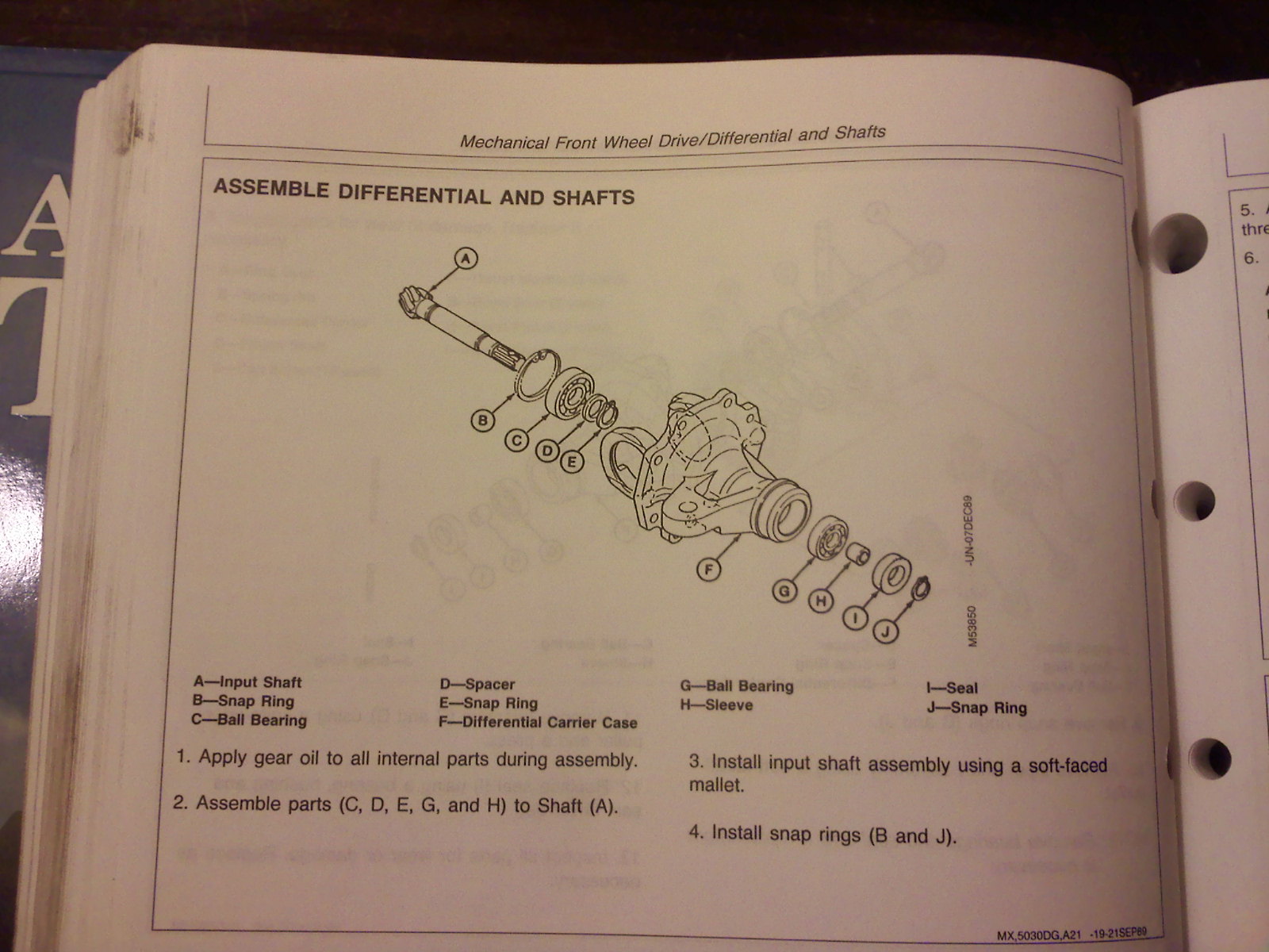

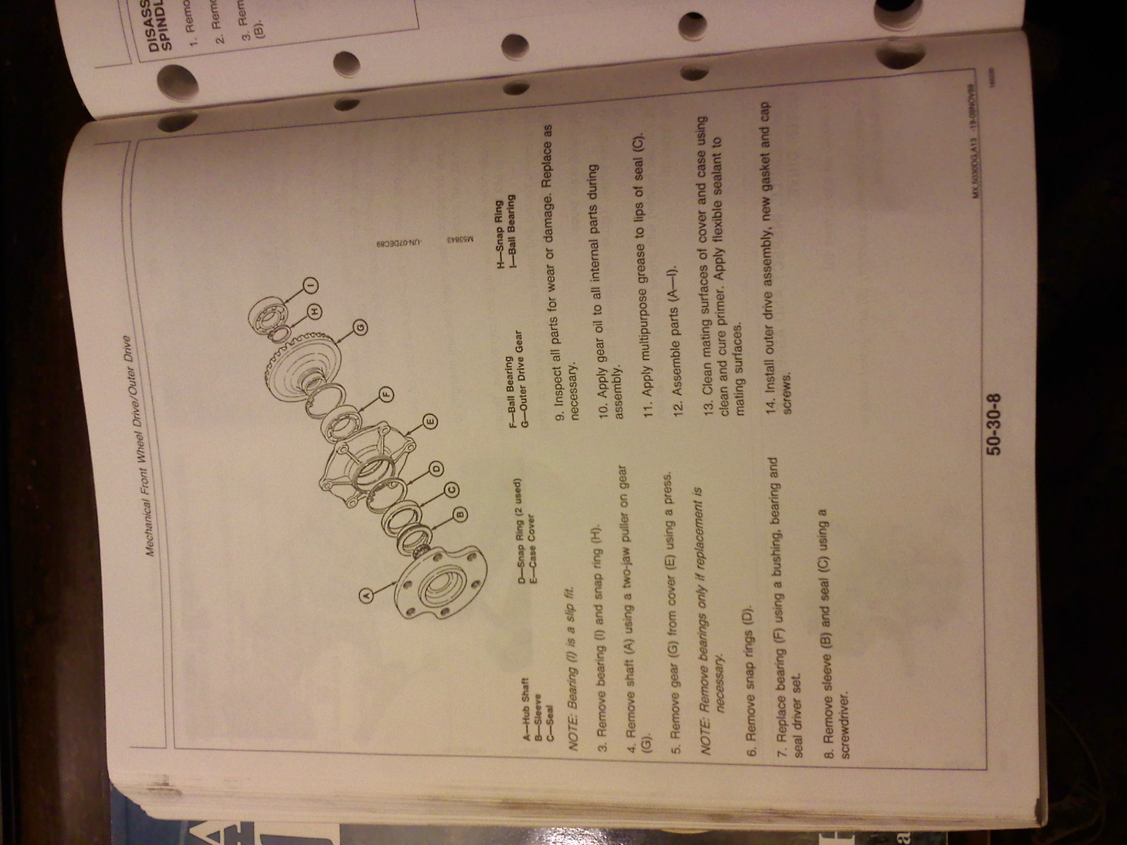

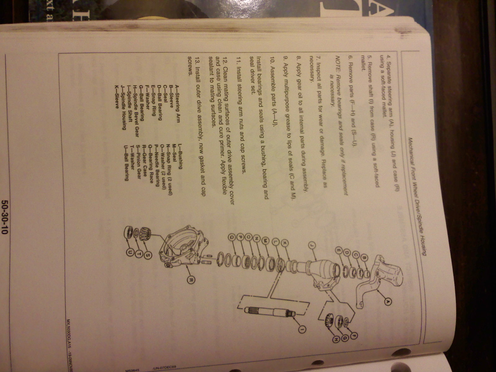

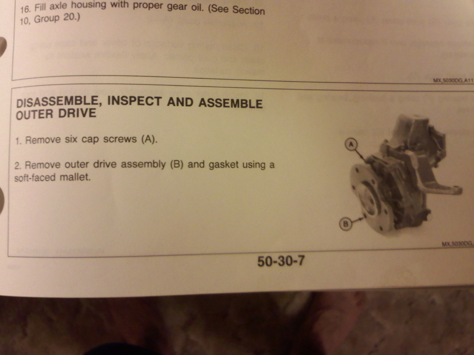

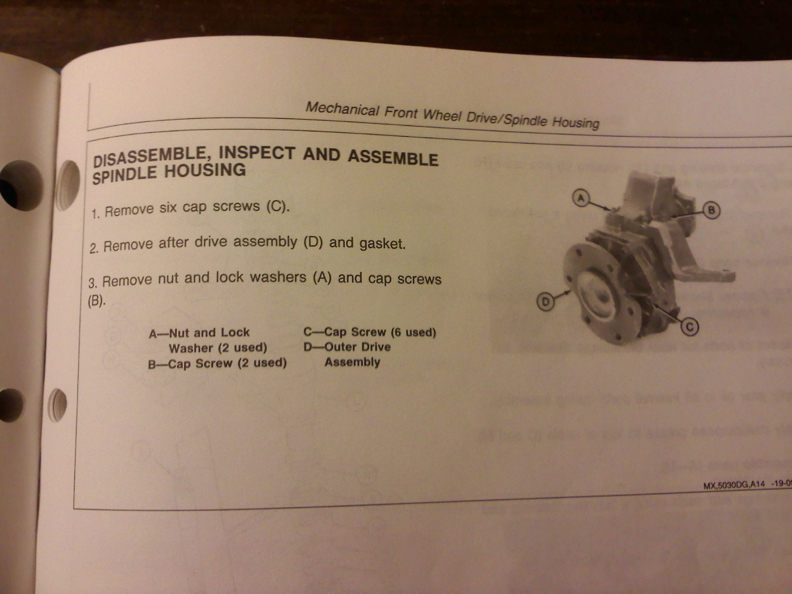

MinnyMoMan,
Here are some more pictures from the JD790 service manual on the outer drive and spindle housing.
Bruce

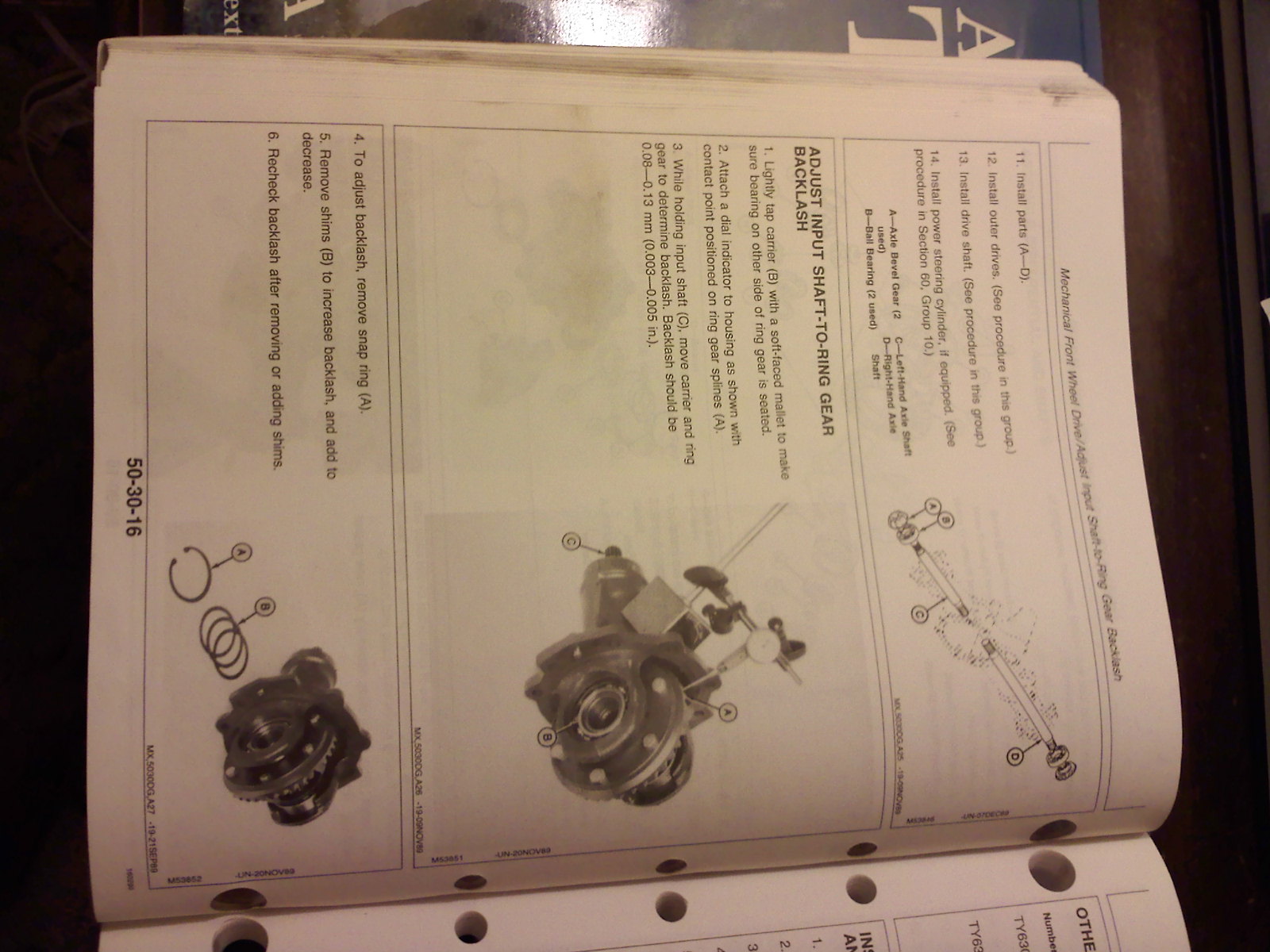

   / JD 790 Front wheel lockup #15
MinnyMoMan,
Here are some more pictures from the JD790 service manual that you may find helpful when you reassemble the MFWD axle.
Bruce
