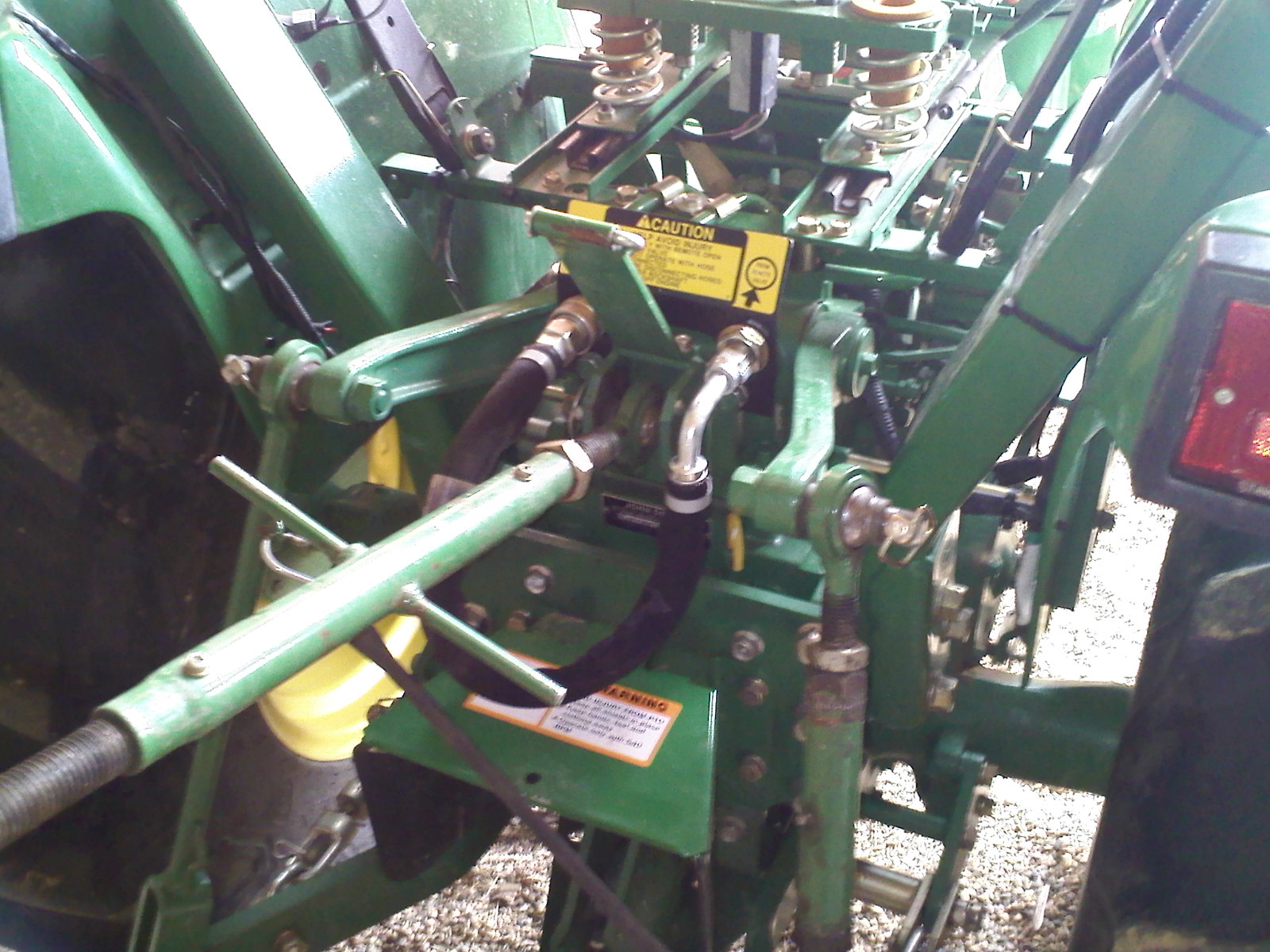

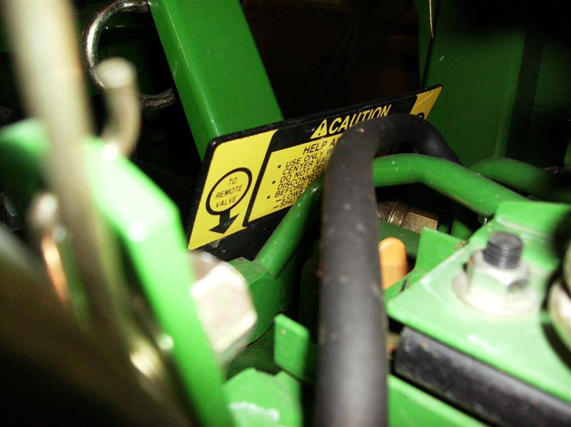

I installed the BM18005 kit on my JD770 just over a year ago. It took a few hours. The step-by-step instructions that came with the kit were written well and had good pictures. You shouldn't have any problems.

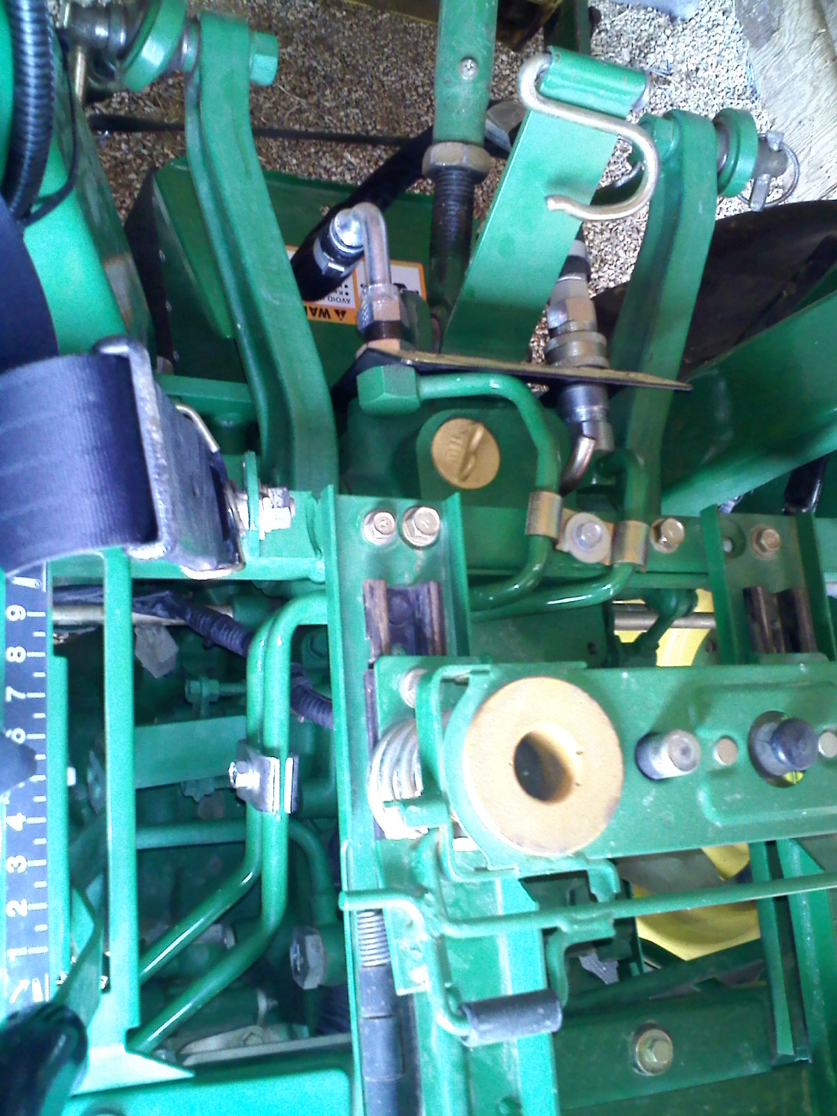

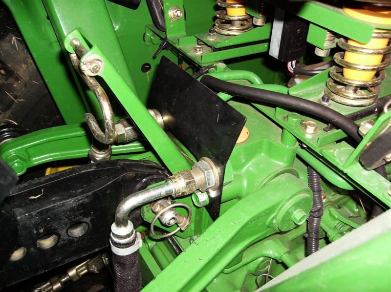

Careful with your sticker placement, evidently it's a challenging chore.
